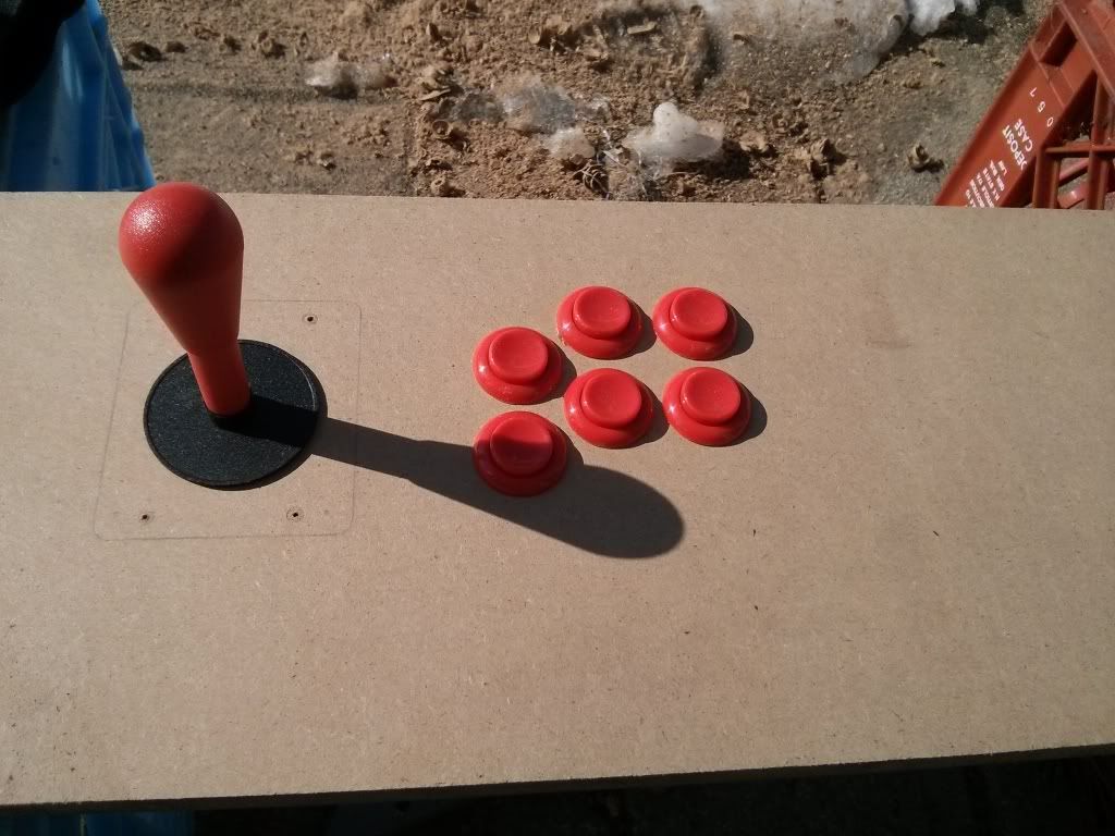

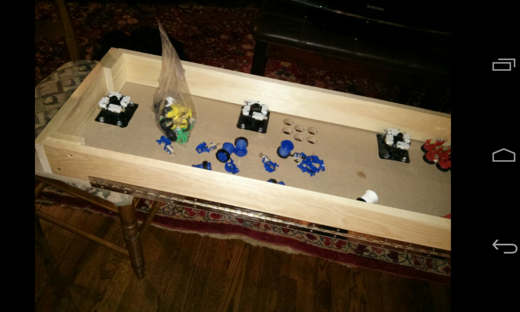

I decided to scratch the trackball idea and instead i'm going with a six button/ joystick layout.
I've made some progress on the cabinet build.
I clamped the 2 sides together and sanded to get them even.
Then I did some bracing.
Started cutting for the control panel.
Rough cut the back.
Then sanded till they lined up nice.
Rough fit the bezel.
Here is where it currently stands.

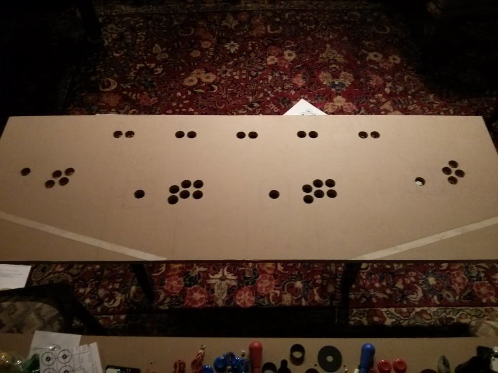

Started on the cp

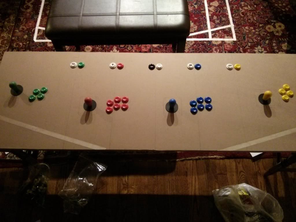

Oops - probably should have checked the placement of the coin button. Going to have to redo that panel

Where the coin button is located, is that going to hit the other top buttons? If its the same Coin button  I am using I had to off set it a little because it was hitting my other buttons. Build looks great!
ron310
  • Posts: 91
  • Last login:July 18, 2016, 06:30:13 pm
Roller Controller Bartop
« Reply #21 on: June 30, 2013, 06:54:55 pm »
Yea, I actually had to redo it. Here's how it looks now

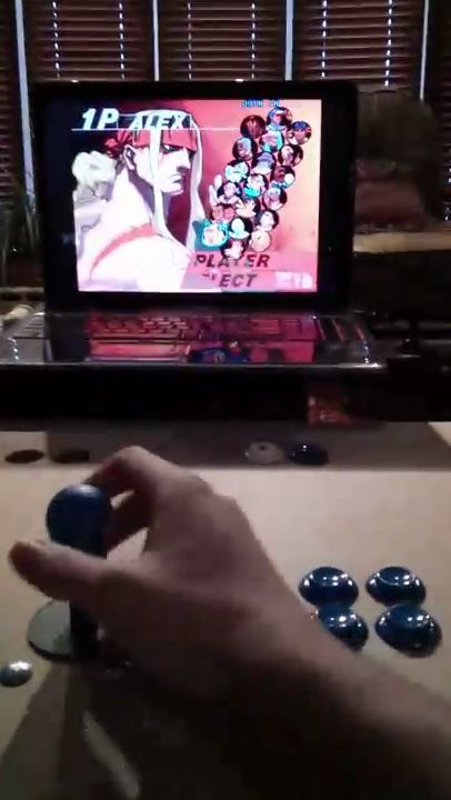

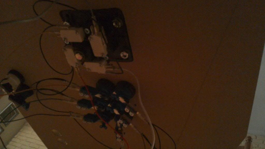

I soldered up all of the connections:
Then tested the speakers, marquee light, computer, and monitor:

I'm actually going to cut the plexi after the curve as it's a touch screen and I can't cover it.
The whole cabinet is glued together except for the bezel and 2 access panels.
I left the front bottom (under the CP) open so that it's easily accessible.
I wanted to make the cabinet as solid as possible, but also make it so that all the electronics were replaceable.
I ended up making 2 access areas. One in the back to access the monitor and pc, and the bottom front to access under the CP. I still have to do the panels to close them up, but I may do the cp one in plexi, depending on how nice the wiring looks.
I forgot who suggested it, but I did the "mdf armoring"  :woot (great idea) using a mixture of 2 parts water, one part glue.
It soaked it up and dried nice and solid. I'm going finish sanding it with super fine grit paper and prime it in the next few days. Pics to follow when it's primed.
« Last Edit: October 03, 2013, 08:10:57 pm by ron310 »
