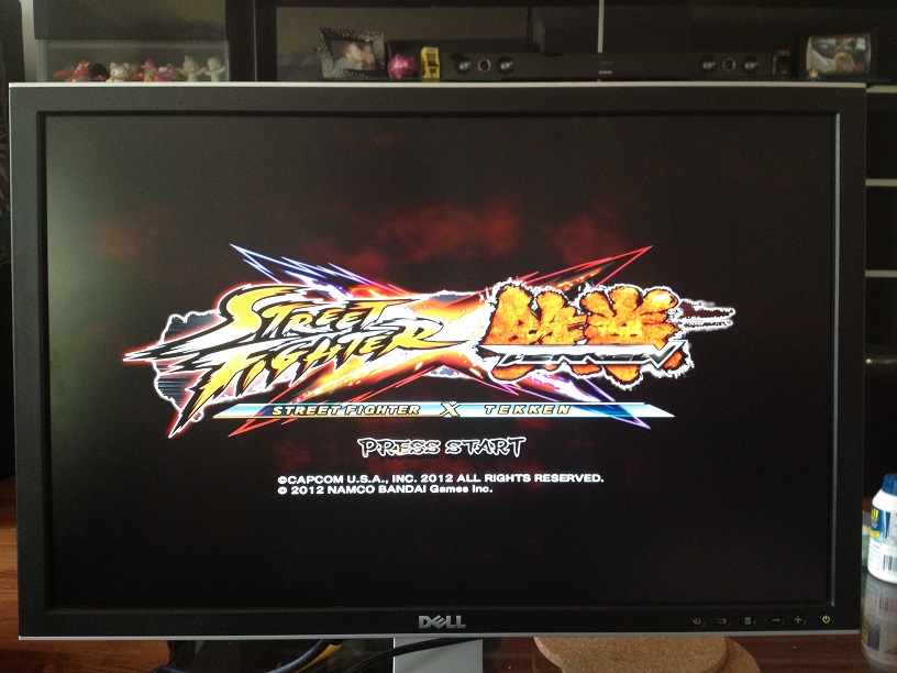

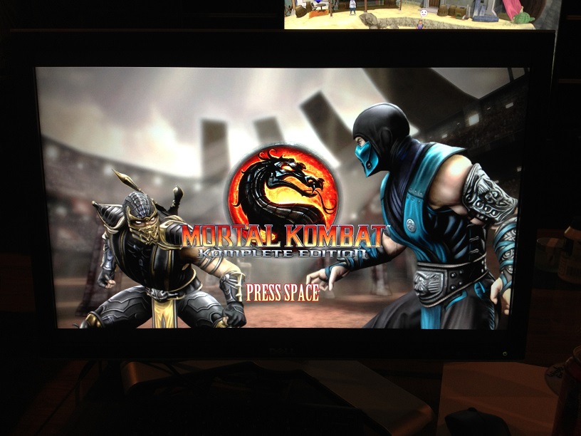

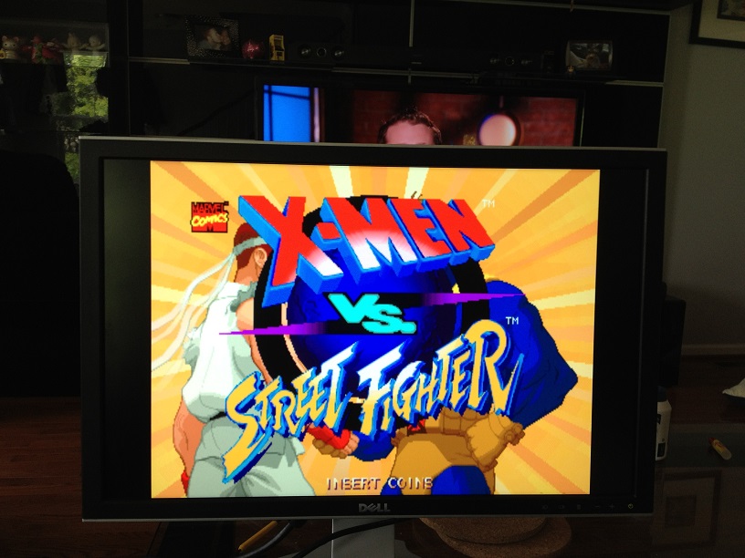

No moar Dreamcast powered ShoRyuKade....

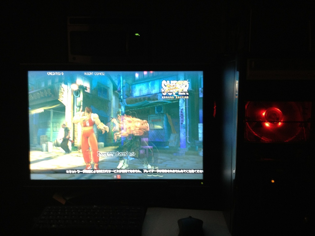

Put together a PC to go in the cab, tested MAME:
Some Street Fighter cross Tekken:
Super SFIV Arcade Edition:
and of course the new Mortal Kombat:

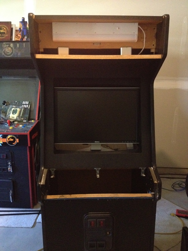

And yes, thats the monitor going into the cabinet as well. Its a 24" Dell and its pretty amazeballs. With the computer all squared away (its running Hyperspin, but more on that in a later update), I turned to fixing up the cab. Im going to pretty much redo everything. I started by pulling the arcade montior, theres nothing"wrong" with it per se, but I just cant get the computer to play nice with it, theres always some sort of image issue and Im just tired of ---smurfing--- with it. I took the monitor out along with the jamma wiring and power supply. The monitor and power supply are off to the side next to a new JAMMA loom, in case I ever choose to revert this back to a real arcade machine down the line.

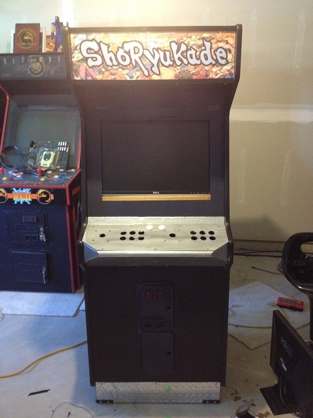

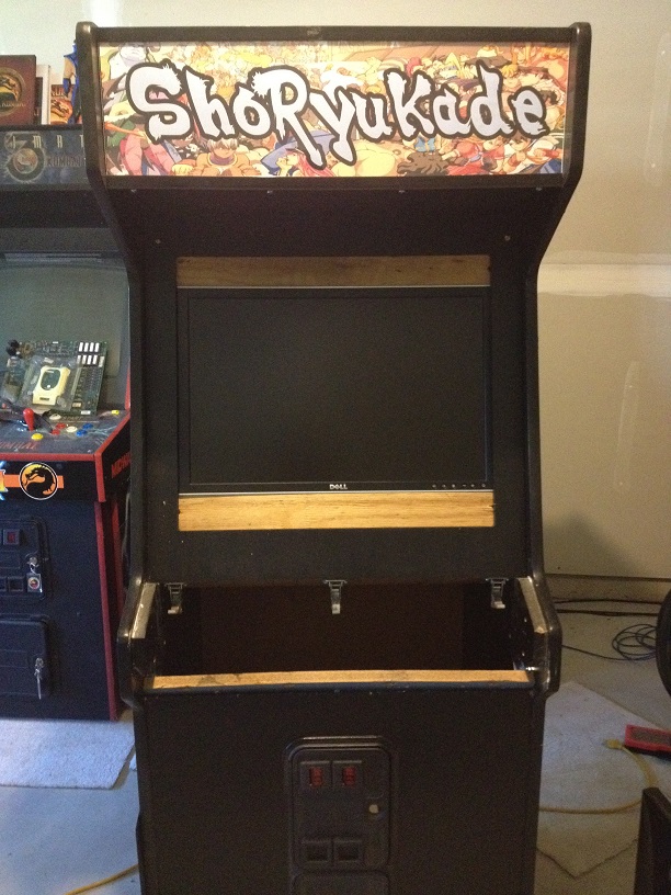

This is where it was before I got started, and this pic is just me showing off the diamond kick plate, I think it looks neat:
Here is the Dell 24" LCD test fitted into place with the control panel removed:
Monitor framed to the existing monitor mount, despite the fact you prolly will never see it, Im goin to paint that wood black:
I had removed the control panel, sanded it all down and smoothed it out, light coating of silver spray paint, also painted the bottom of the CPO plastic with the silver paint for a smooth metallic look that cant get smudged with fingers:
IPAC2 is already ordered and I'll prolly order new sticks and buttons. Very very strongly considering adding the 7th "neogeo" button but i havent decided on button colors and whatnot yet. The monitor is slightly smaller than the 25" tube, but the entire cab now weighs less than the old monitor, heh.

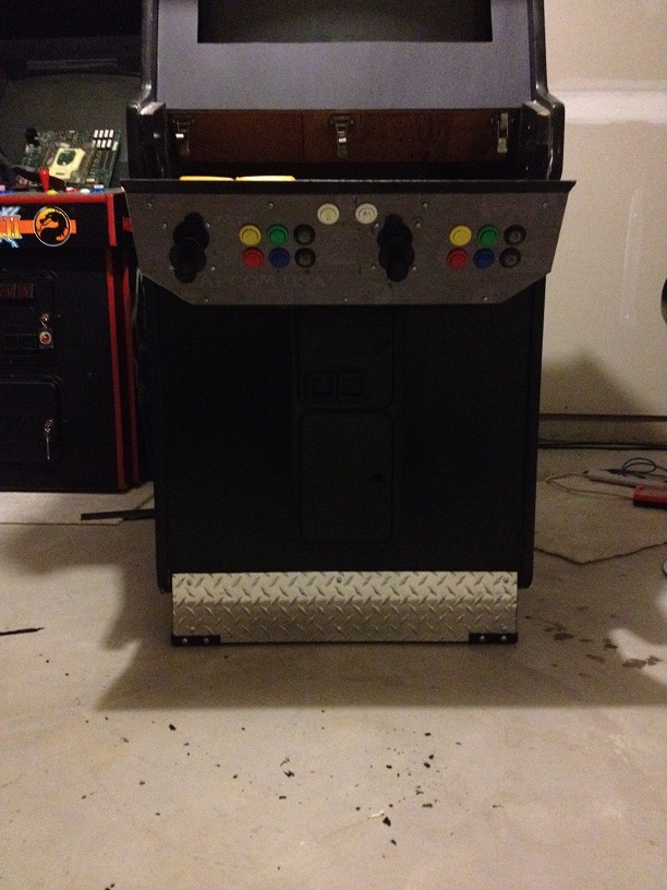

So mounted the monitor and made a new slide out shelf. Didnt have any wood wide enough so I spliced 3 pieces of pine with glue and biscuits (no gravy)
Marked off 2 5" holes to reach through for latches. Factory holes are square but circles are easier.
Saw em out
considering hole sawing a 3rd hole for the middle latch, but meh.
Then make sure I can reach the latches and that it shuts.
Started the JAMMA wiring.
Each player side had a molex plug, and Im trying to keep the wiring close to factory, except using screw downs instead of zip ties stapled down.
