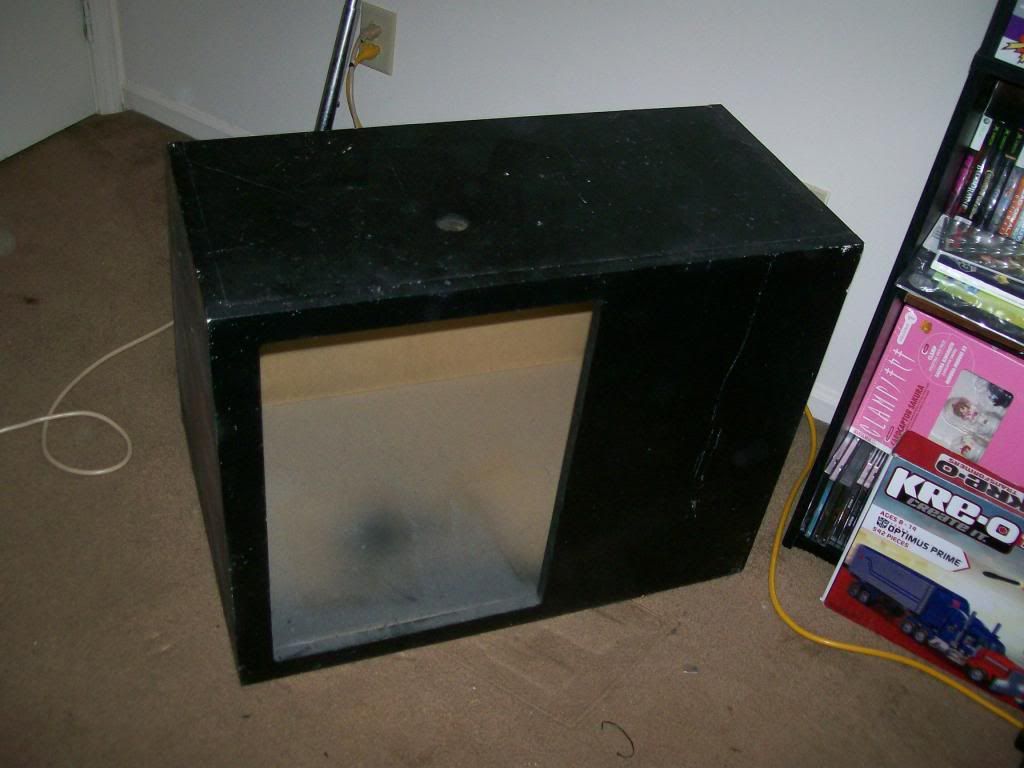

Pretty much the only thing that I didn't have to buy was a 17” Samsung monitor that I had from my old college computer. Here's a quick rundown of the specs

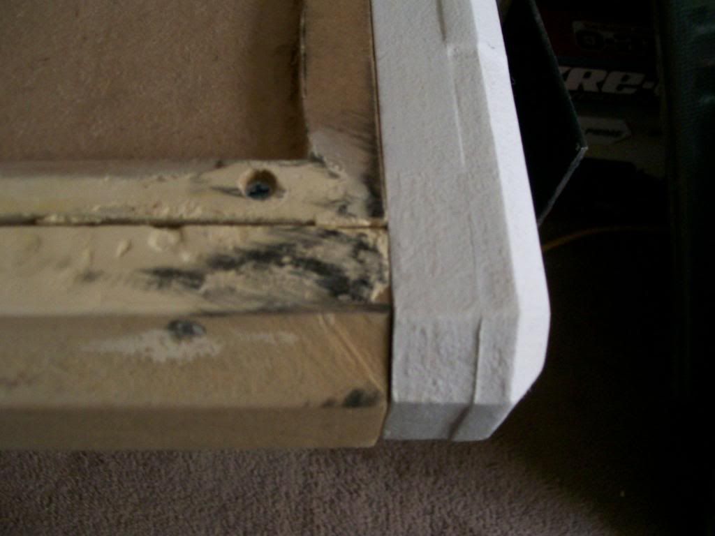

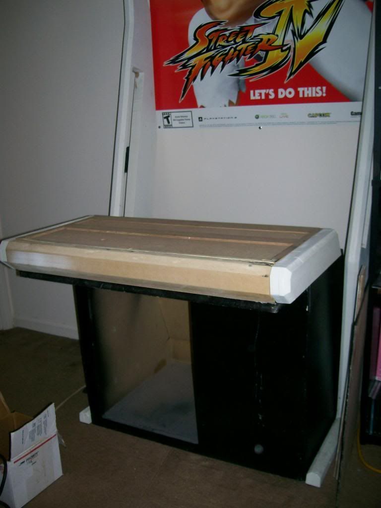

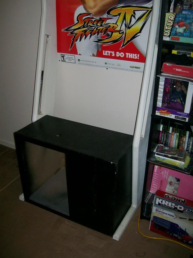

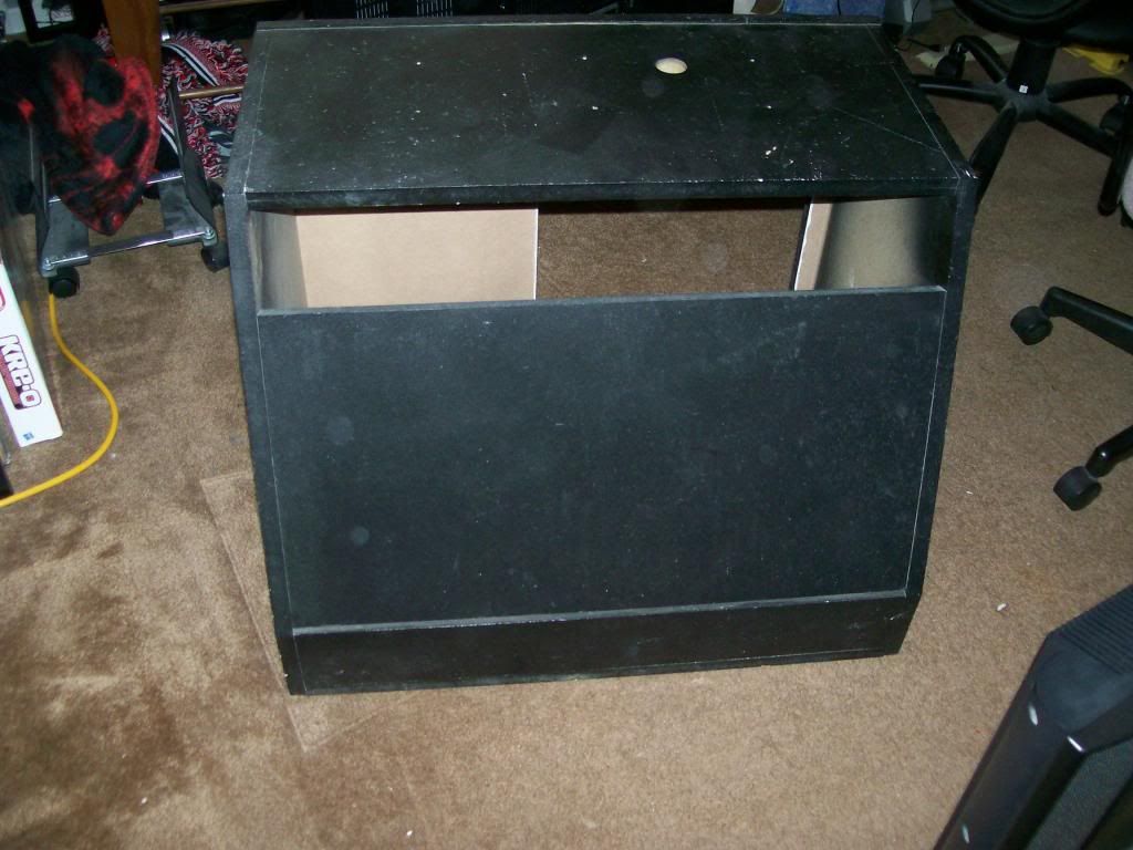

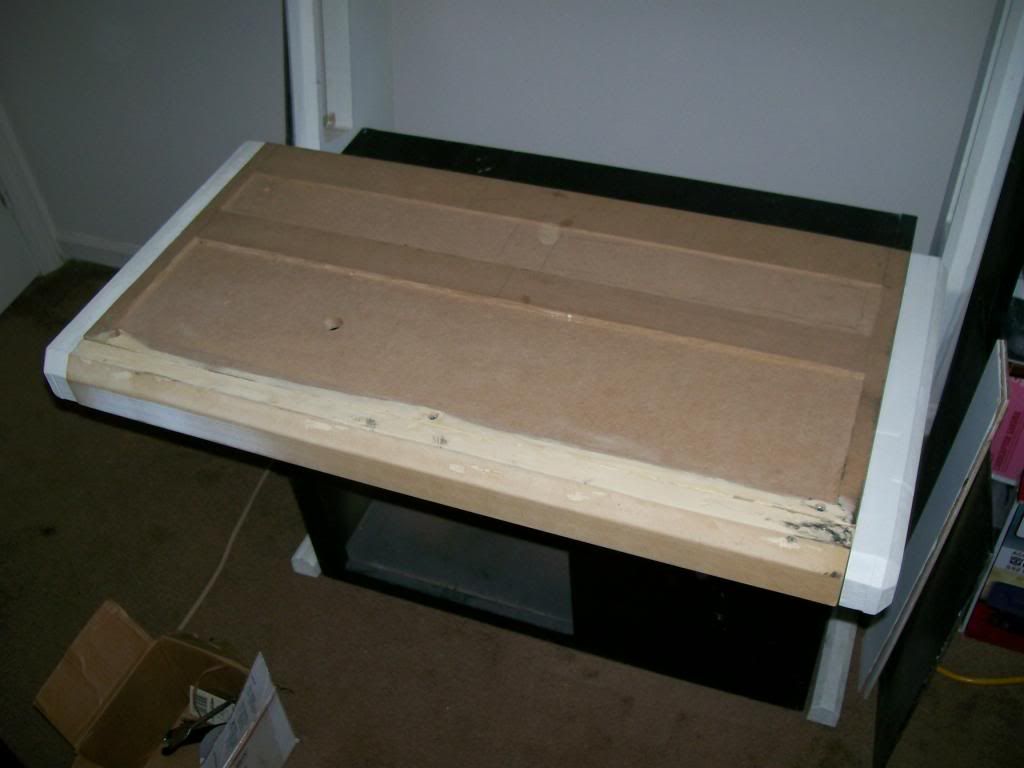

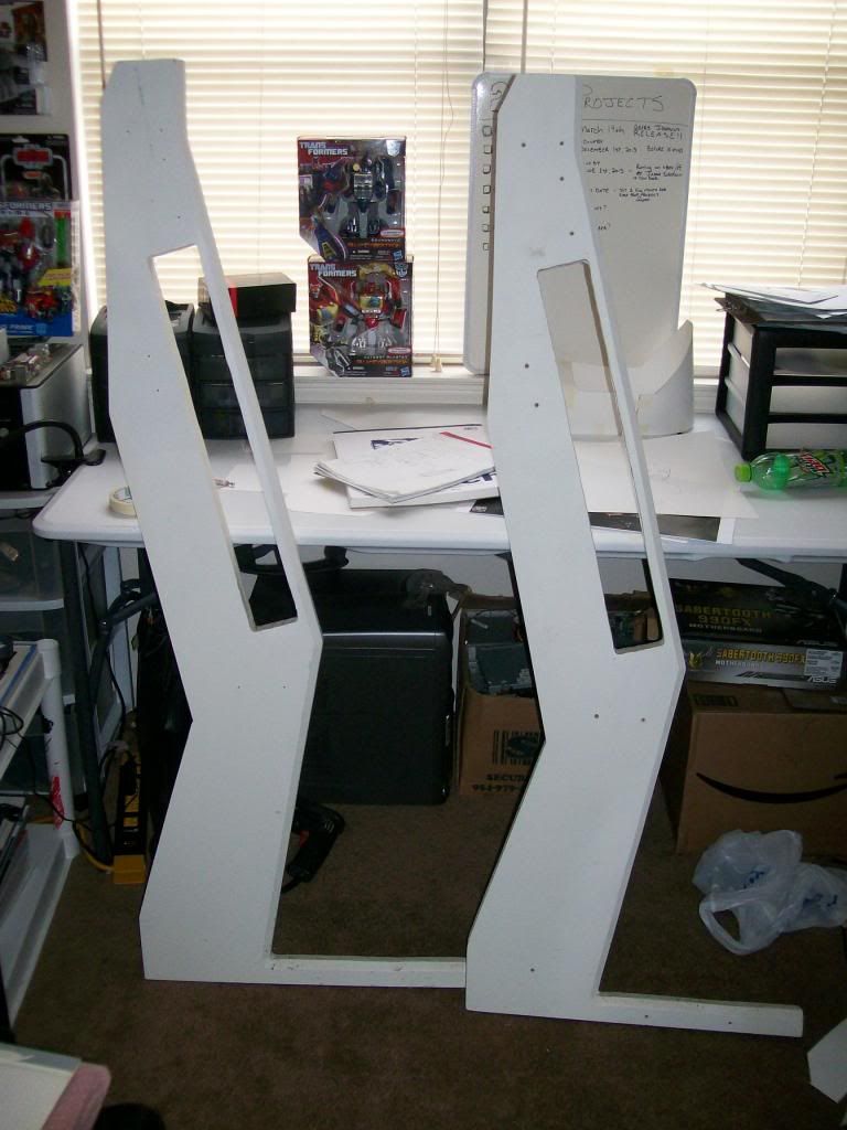

Here's a few starter pictures of some of the woodworking. I originally wanted to widen the original Weecade plans by 2 inches or so to make more room for a 6 button layout...I ended up reducing that because with a 17" monitor, it just looked odd.
Tracing out the side panels
Wood is cut
Test fit...originally wanted a 19" wide cabinet but that looked disproportional so I cut it down to 18". The original Weecade was about 17" (450mm)
Molding in place

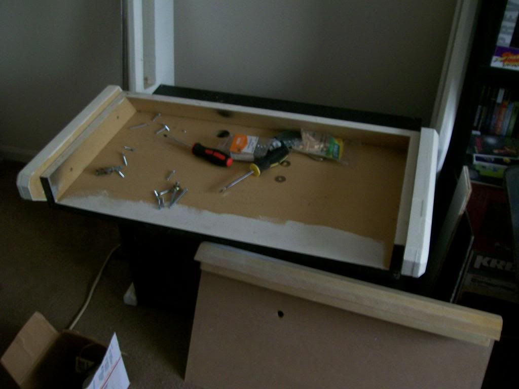

A few more shots
buttons as they will be on the front of the CPO (facing the players)
makeshift computer in a box as I set up the front end. I'm going with Hyperspin
That's it for now. I'll try and lay off the photobombing for a while.

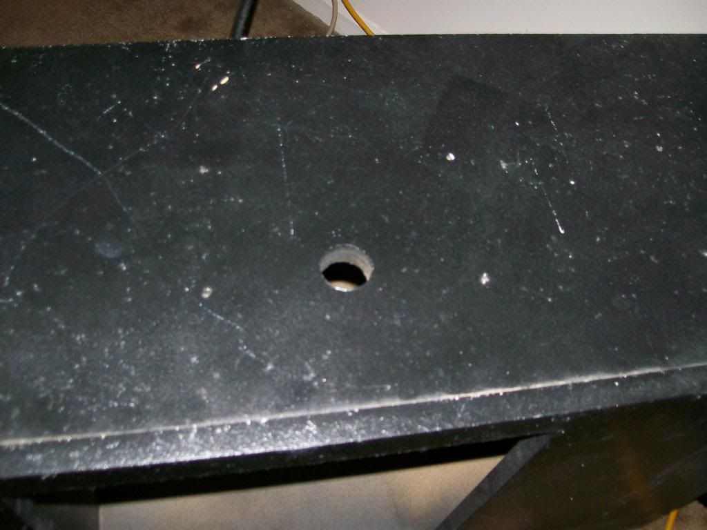

Let me rephrase, I'm not stuck on whether or not to pay for artwork (that's definitely happening) I'm not sure if I'm happy with the final design yet. Here's a quick update on the layout I'm going with. Might push the buttons closer to each stick by maybe an inch to allow a better gap between the two players.
Also, I attempted to cut holes for the speakers and realized I am awful at it. I will probably not use speaker grills and have the edges rounded so I'd like them to be as perfect as I can...I'll look into a circle jig. I also have some ideas for the back panel that will look better with perfect circles...here's my plan.

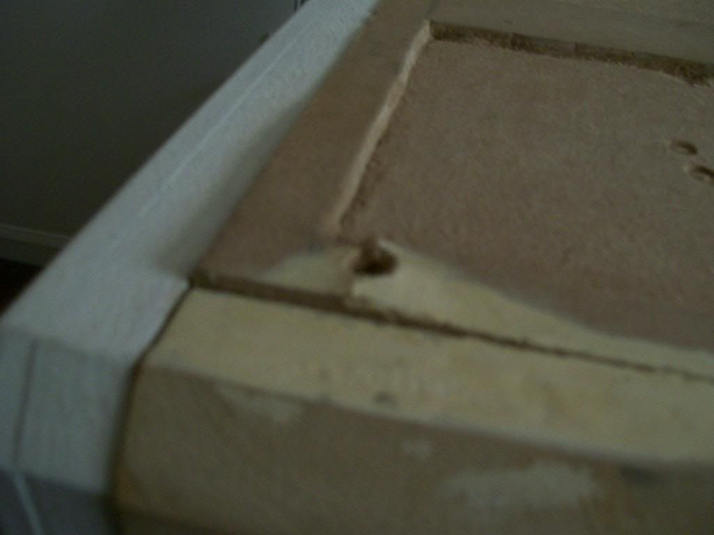

well I knew I was going to mess up at some point, things were going so well. I was about to screw the monitor board in place when I realized the top of the monitor was covering the speaker holes.
I have to use a thin saw and sand paper to fix this. After its set at the right angle, I should be good to start painting.
Lesson learned: measure one more time than you think you need to.

OK so everything is coming along nicely albeit at a steady pace. I finished my final coat of primer and figured I would test fit the PC parts one more time just to make sure before I started putting the topcoat on. I was able to cram everything in pretty well a-la-Tetris which left me pretty happy. The one issue I ran into was that my P1 joystick clips the CP molding by barely 1/4".
Now I'm left with the decision of moving the joystick in (which would also mean moving the buttons and P2 layout in to keep things even) or take to my jigsaw and carve out the small space that I need. The molding is 1" thick which after being trimmed would still be 3/4". Still glued and screwed in, I think it should be fine, I'm just hesitant to start cutting again.
Maybe i'll do both, move the stick in 1/8 of an inch and shave an 1/8" off the molding. Space between each player's layout is at a premium and I'd like to avoid moving any closer.

Looking for some help if anyone could chime in. If you see in one of my earlier pictures, the underside of my P1 joystick slightly catches the molding on the left side of the cabinet. I'm torn with how I should go about fixing this. The easy solution is to just move the joystick in and away from the molding but that sacrifices valuable space which is minimal in an 18" wide control panel. The other option would be to take a jigsaw/router/drill and (carefully) shave off a little of the molding to get it to fit. The space needed is 1/4" at most.
As a side note, the weeks of painting in my free time are done (thanks OnD) and I finally can start putting everything together and finish the control panel. More pics very soon!

Since the moldings are glued and screwed (not to mentioned painted over), I will first just remove the screws and attempt to take some wood off the inside with a jigsaw. The moldings were pretty big to begin with (a little over an inch). I had just used some scrap wood that was around from old shelves that were built.
I'l really trying to avoid any damage to the paint job....I put a lot of time into it and hoping to not have to touch up anything major.
Good news is that now that I know I wont move my joystick in, I can finalize the artwork and send it off for printing.

I'm happy with the painting so I moved on to fitting all the parts together. I started with the back panel to make sure it still fit snug after all the costs of paint. I have my power button, 120mm fan and USB panel in place. The plan was to have cabinet door magnets on the inside at the top but they aren't keeping the back panel as tight as I'd like it. I may look to small furniture screws to bold the top two corners flush.
Here are some update pictures, more to come.
much more this week as I wrap it up.
