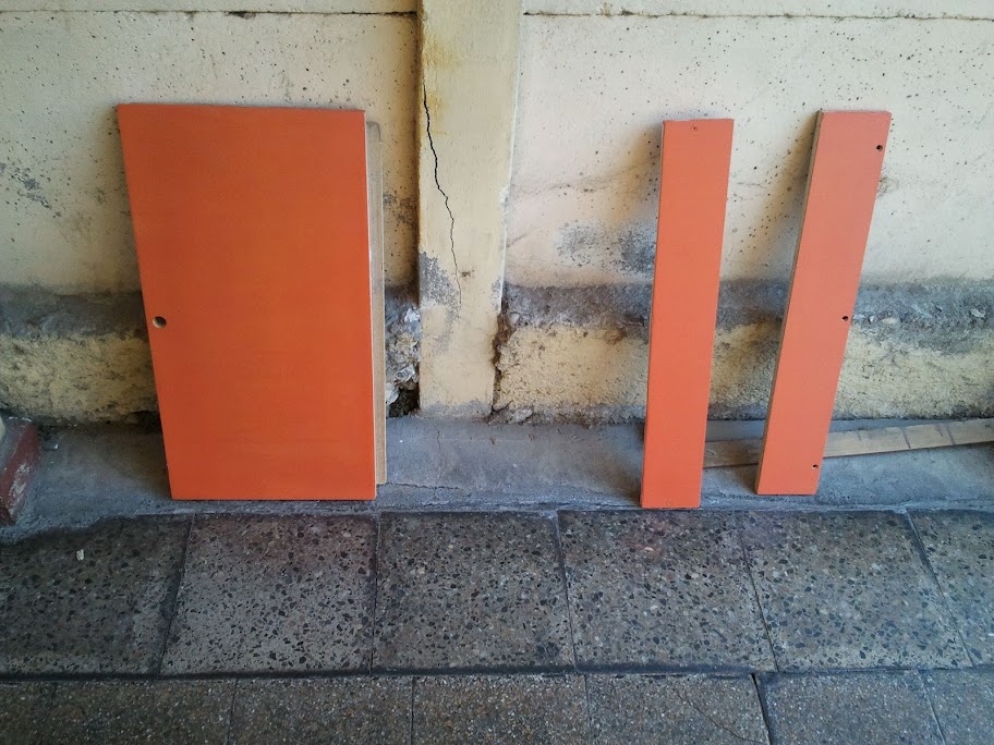

I'm layering my CP because I don't have/have access to a router. I found a very flat piece of .25" ply, so I'm going to do 2 layers of that, 1/8 masonite, then art, then 1/8 plexi. I'm sure doing a nice professional routing job is better, but that's off the table for now. So far in tests, this is sturdy enough. I'm going to glue the ply together after cutting, but the masonite, art, and plexi will be held down by the buttons.

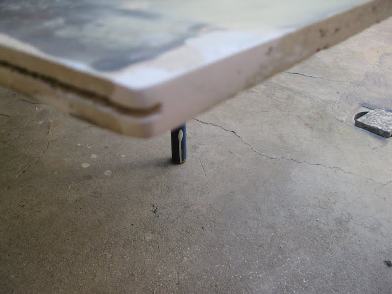

Donkbaca, I was going to go with a suggestion from another thread and hot glue it.
Here's some more progress from today...
Drawer installed
Backing board cut. Letting the butt hang out shaved 3" off. It's probably better for airflow anyway.
It's shaping up!

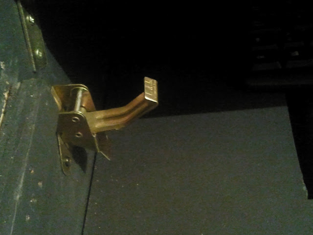

I want to keep the iMac un-modded, which means, I can't mount it. Currently I have it sitting on supports, which do a fine job of keeping it where I want it. I don't plan on moving it much once we have a place for it. Do I really need to worry about anchoring it somehow?
Also, It looks like I won't be able to mount the speakers under the marquee because it's too tight in there for me to have room to work. Weighing other options. What about in the marquee but mounted out the sides like the image below? It's not as clean a look, but I can manage it. Any other options? I thought about mounting them so the point out the top of the cab, but they'd be dust magnets, and hard to clean.

If you don't secure the iMac in there and then start carting your bartop around it'll either 1) get off center and be annoying 2) hurt something else in the cab by bumping around 3) fall out
Just throwing it out there but a palm router is a cheap multifunctional household power tool that will benefit you on more than just a MAME cab... and hot gluing T-molding will be a short term solution at best.  First drunk at a party and that stuff is on the floor.
If you uncase the computer you may find you have enough room to get those speaker in the sides then you can just cut holes on the sides of your cab, which can look nice like on the Taxi Cab

Le Chuck, I was thinking of just having the iMac be completely removable via the rear. So if I wanted to move it, i'd just take it out. That said, I don't plan on moving it much, even though it is a bartop.
