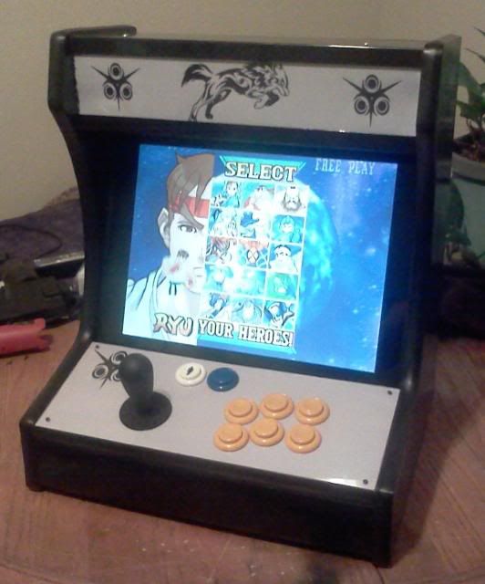

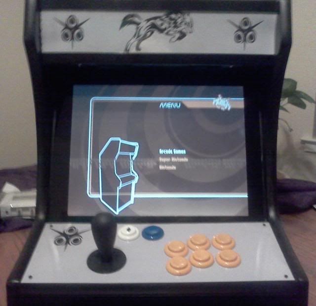

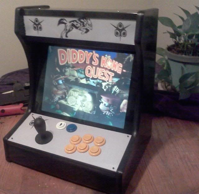

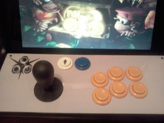

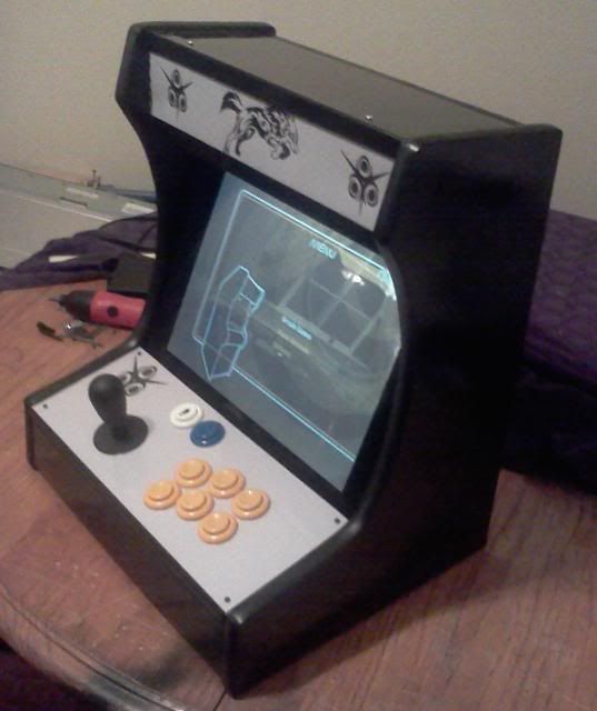

**********************UPDATE: PROJECT COMPLETE**********************
The first and second machine basically look the same and I just noticed that I didn't take any pictures of the second one.
Then my machine after another 14 months and an art redesign.

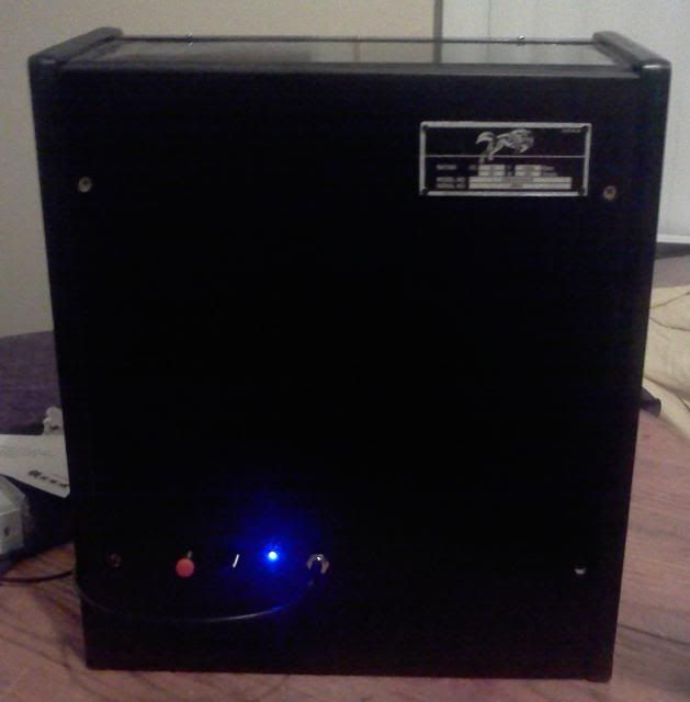

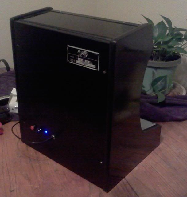

Backside of the control panel
Inside the box.  I still need to get a little wire cleanup in here done.
