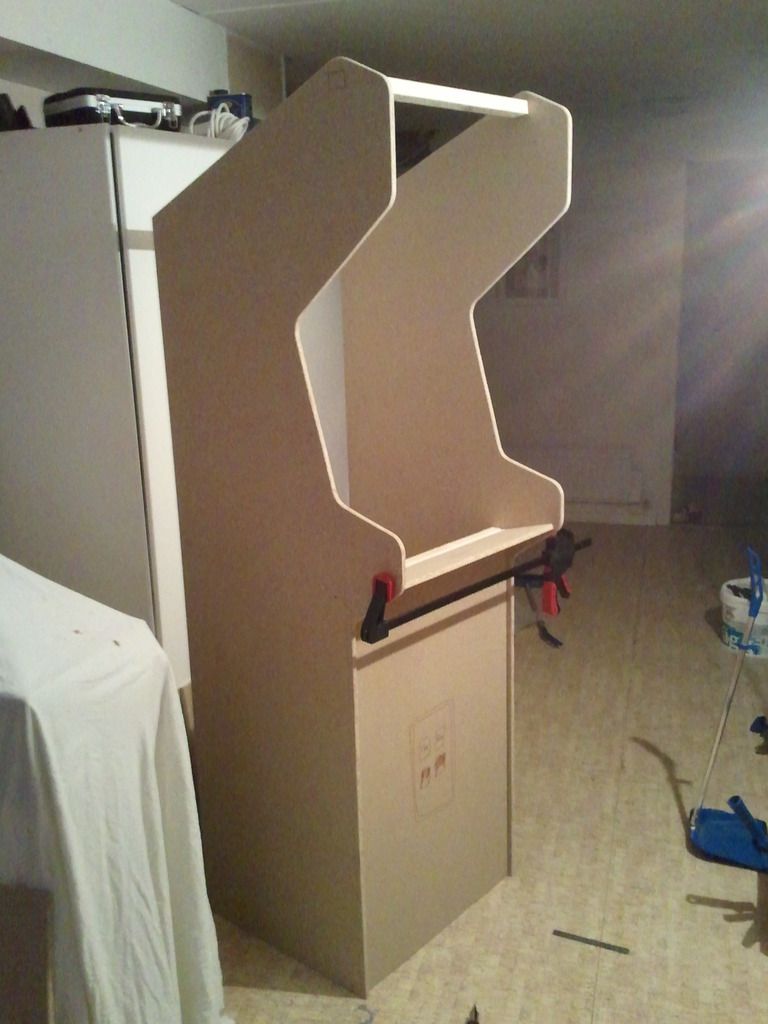

Ok, first the material
19mm and 10mm Medium plate, 16mm Aglo Wood and a strong 22mm Plywood for the bottom
And some "real" wood
Let's start !
Stage 1 : Inside Part
The CAD blueprint
Preparing the wood
Should assemble something like that
It's pretty hard to be 100% by woodworking
Drilling
And first test...
Look good !
Test with the 4 legs
The stability is really poor
I had some extra wood
Test again, Look better  ;D
Time to glue !
That a complicate part and you must be at two minimum to fix it good !
Thanks to my neighbor  ;D
After the dry (24 hours later)
As you can see, it's not perfect, but hopefully the wood can be move a little
I ifx the leg on the Ply botton
With bracket
and dowelled join for be sure
more to come !

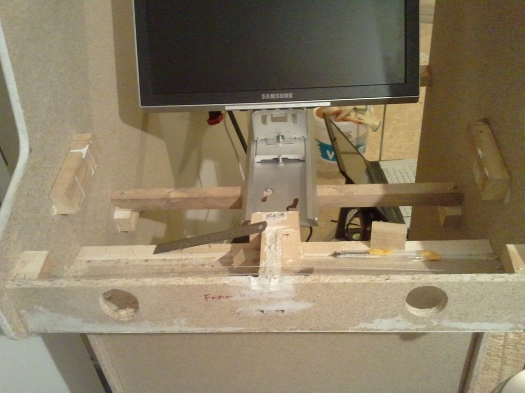

Something more for the side
The side are fix with 4 screws on the legs from the inside base
(on this picture you see the coinbox, this will be explain just after in stage 4  ;D)
I put 3 screw more at the bottom
That was not a good idea. I keep only one because it's easier to assemble and only necessary at the front finally.
Stage 4 : The front and coinbox part
Time to attack the front !
First a test without fixing
Not so easy, I must take care of the panel control for adjusting perfectly the coinbox
I prepare the front coindoor part
I think the a real coindoor is the key of a real arcade cabinet  8)
Ok, now the glue part
I check alway if all is straight
Test with the front panel
Now some technical part.
Here are the system for fix the panel
I don't want see any screw outside, but that must stay disassembled.
Look something like that
I continue with the coinbox, I will fix it with 4 strong metal screw on the bottom
I prepare before the T-molding insert.
At the bottom I prepare something special (not present of the original cabinet)
It's mean for an alu rail to protect the corner from some kick of angry players
Should look like that
Ok, the wood block for the panel are ready
Adapted perfectly
From inside, you can see the system
First it's was forsee to fix the panels with nuts, but the adjustment is so (too) just, that I don't need to fix more with nuts, I thinks.
Adjust such a construction is very hard when you don't have industrial cutting machine, that why I let cut the panel by the woodshop with the cutting robot  ;D

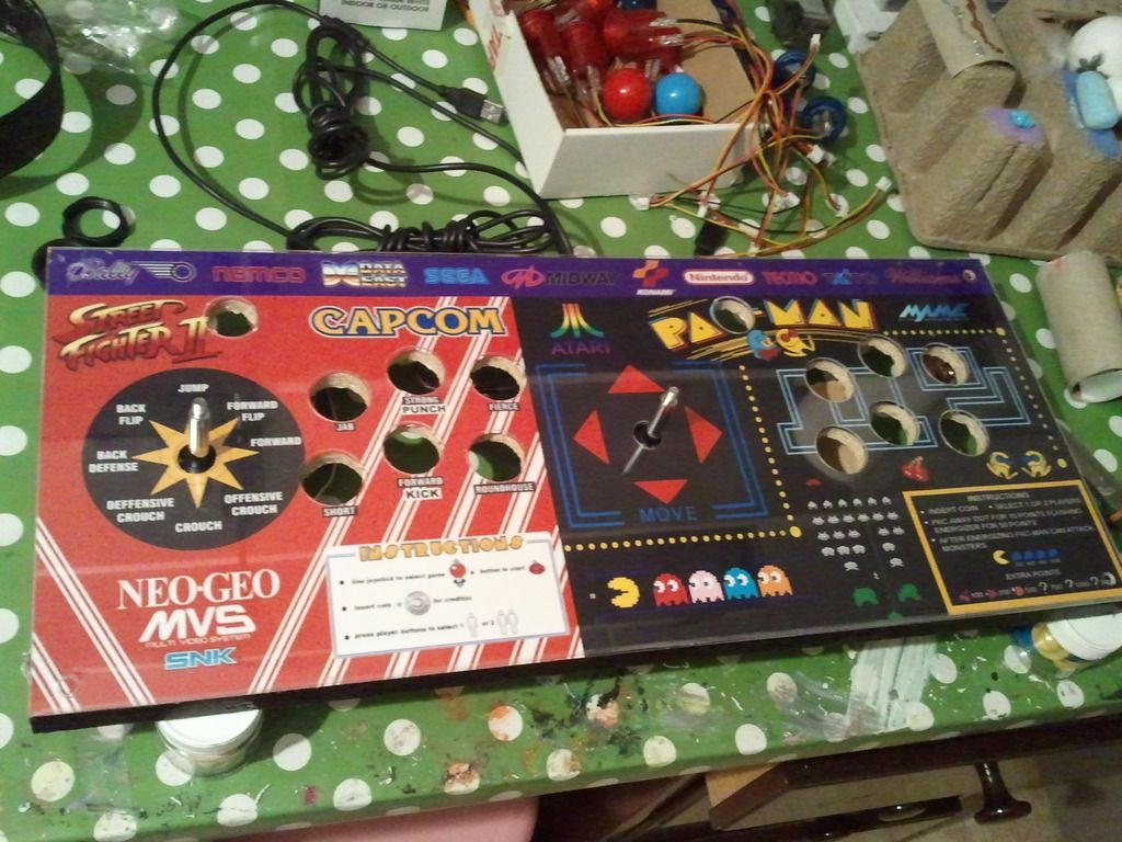

Stage 5 : Control Panel
This is a little special, because the control panel of this namco cabinet is unusual.
First I want do that:
But The real one look like that :
They use an agglo plate with groove, bend and fixed with some strong glue.
I test this solution, but it really hard to obtain that (test with agglo and medium).
So I think for another solution to obtain the curve
I will use thick MDF and sand it to round.
I will put a little woodblock behind to keep the corner strong enough.
Today I work outside, it's sunny and good for cutting  ;D
I cut first the botton of the control panel block.
Test on the cabinet (place just over the coinbox)
It's not 100% adjust, even I take really care  :-[
Ok, I will use this fine 1mm sheet of wood to make it perfect.
Now come the side part of the panel block
Here the block for the future round corner
I begin to assemble with metal bracket
But that not a good idea.
By screwing the bracket, the medium move and let light between side and bottom...I put the bracket away
Only glue should enough
Not easy to span, I use here a strap
Ok after the night a little test
Ok adjustment are need !
I put the top panel, the right side is not terrible
Left look a little better
Ok, sanding operation
Great victory  :D
Now I need the metal backet for fix the Control panel block to the cabinet
First cutting the metal
I don"t like cutting metal, is really hard to work straight without a industrial cutting machine.
Time to bend 45°
Result...
Drill the hole and test
After I have the good position, I "cut" the square hole with a little file
I put the carriage bolt and nut
I had 35mm wood block in the control panel for have more stronger side
You can notice the 45° angle on the end, it's mean for have more place when I lock the nuts  8)
I begin to curve the side
I decide to stop, when it look good for me
The difficult is to do the same curve each side...concentration  :P
View under the control panel
I finish with the hole in the middle of the bottom (like the real one).
It's mean for cable and especially for the possibility to fix the clamp (see later)
I will finish with the panel itself.
Cut and rounded like the panel block
I let 1mm between the side panel block and the edge of the panel to look really like the real one.
I'm proud of this part, it's was not easy with poor hand tools  ;D

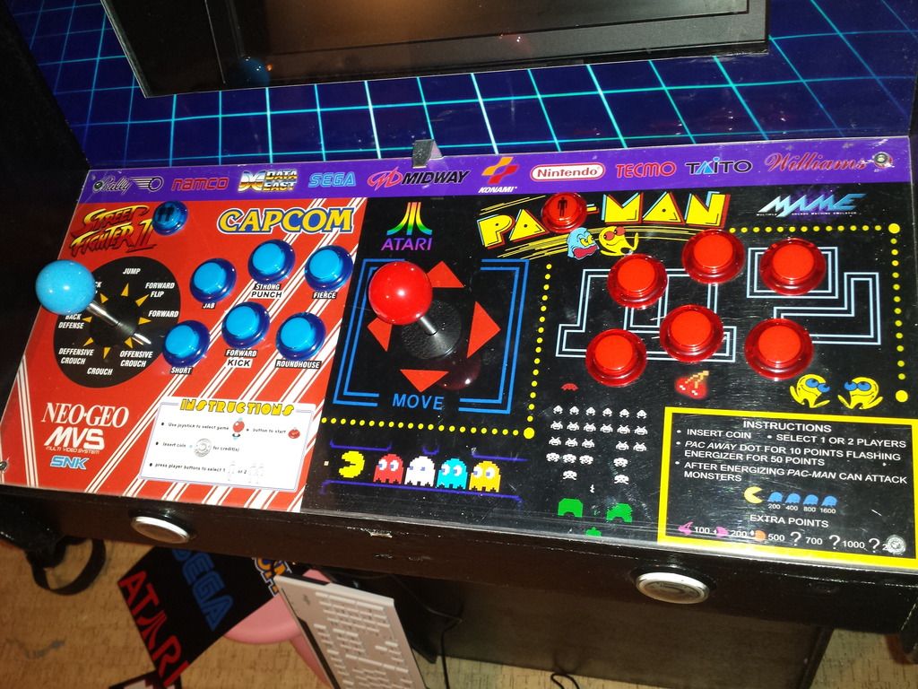

Time to fix the panel
I get some latch (not really strong, but will be enough)
I take a block of medium, drill and but an carriage bolt
On the other side, I fix my latch
(the 2 additionnal screw come later)
After I glue the block on the side
But before I do a test in situation, for have the good position (not easy)
Ok, look good I can fix it
It's Ok  ;)
I fix all
Aerial view !
Inside

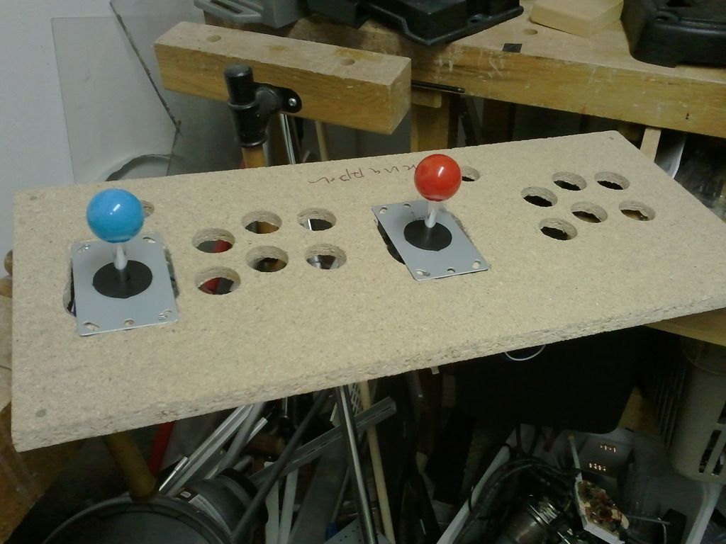

Next the buttons and sticks hole
The position and disposition is like the real one.
You can notice a metal plate over the wood panel
The real one
I must cut a large metal plate straight, it's a nightmare, but I will show you next time, how I do !

Today, cutting the metal plate for the panel
That a hard part, cutting metal is not easy, especially with hand tools like a simple saw...
Hopefully, my father lend me a jigsaw with a special metal blade (until 3mm)
It's better, but impossible to be 100% straight...
I cut little part and adjust each time with the file
Very long...(take me 2 weeks), but finally I get that :
Better as I hope  ;D
I wait  3 weeks more for get this precious, but very cheap, drill
Little test
It's really easy to drill the 1.5mm metal plate !
Let's fight !
In the wood
In the metal
I get that (I begin to paint during the waiting of the tools)
The joystick are, like the original, Suzo-happs system 500 sticks
After, I get the screw 8-32 carriage bolt (who only exist in USA in this size)
So I can fix correctly my joystick and metal plate
Unfortunately, it's was impossible to find carriage bolt over 3/4" length. It's okay for the joysticks, but to short for the panel and the wood  :(
Maybe I will find some later...
(if someone know an shop who send to Europe ?!)

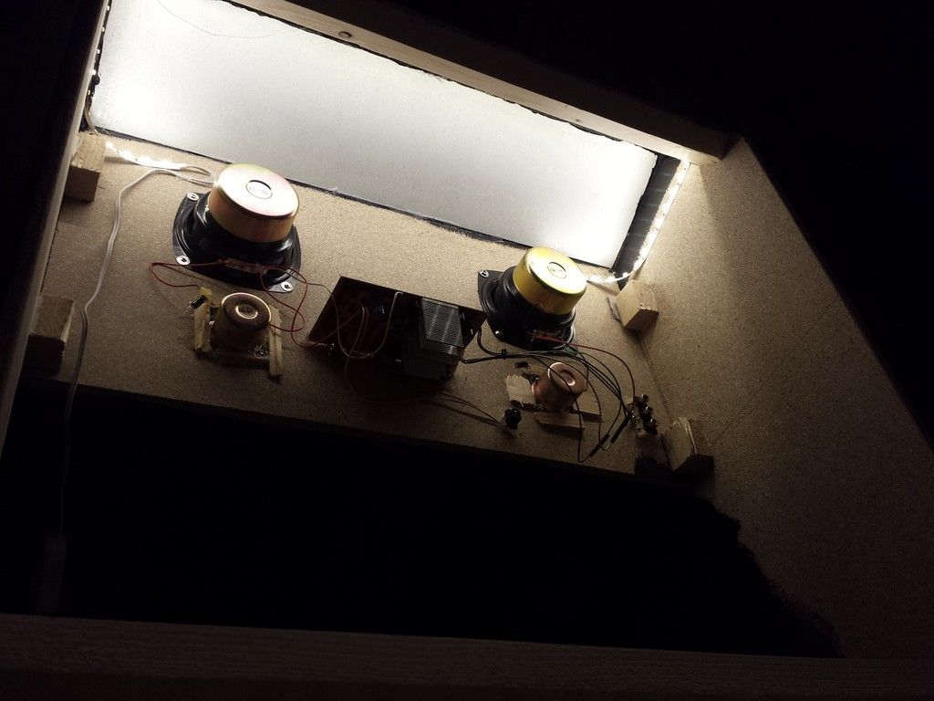

Stage 6 : The Instruction and Loudspeaker panel
This part was long too
First CAD draw
It's always like the real one.
This time I get ill, and cannot work too much...I lost one week  :angry:
"Sir Kayne was seriously wounded, but the soul still burns." ;D
Ok, let's go
Cutting the panel (10mm Medium)
Inside
outside
(you can already see the special support for the screen, I will explain later how I built it)
I need a wood block for support the glass
I use the router for do it clean.
I fix it with bracket, I don't like this system but I must keep the disassemble possibility
Adjusting is not easy, but I done !
Now the very long part...
Here are the original
You can notice the many hole for the loudspeakers
Let's do the same
Horrible to be straight :P
440 holes later...
Time to fix the loudspeakers
I will put a second 10mm plate behind the first one, so I can hide the screw
Preparing the second panel
Test by installing the loudspeaker
Look OK ! 8)
On the first panel, I do some carve in the wood for the head of the screw
It will look like that
Glue and clamp !
Here a more advance photo (with painting)
I begin to try a plastic sheet for the future instruction holder
PS : sorry my photos are not in chronological way, sometime I work on my side, after on the panel, and again on side, etc... That why you can  notice more advance of some photos as I describe.

Stage 7 : The monitor
The monitor I have, is about 35Kg., so I must imagine something really strong to support it.
I imagine a frame with wood and support in metal
This system allow to give different angle of view.
The monitor have 4 ring fixation like that:
Time to cut, with the Japanese sword !
This saw is call "Japanese saw", it really really good. You cut faster and more precises as a normal any saw. Even the quality of cut is better than the best electric saw !!! Must have !  :notworthy:
Here you see as test block, to find the good shape to fit around the screen
After I copy the shape with the router on the final wood block for the frame.
After I drill for 10mm bolt (should be enough)
I fix the complete frame with bolt again. I want something really strong and prevent from wood splitting with normal wood screw
(and can be disassemble, If need).
Test
Ok, time to prepare the base for the frame
I use 19mm medium
Prepare the bracket
You can  notice the corner are round, to have a better rotation
I assemble the frame and fix the bracket
The screw look too long, it's just a test. I will put shorter later.
I put L-form metal rail and metal profile to complete the system.
It's begin to be night...hard to stop when you "wip"  ;D
Inside the cab
The base will be screw on the inside table for fix everything strongly.
The advantage is that the monitor is not fixed on the side (like many arcade cab), but on a inside table.

Ok, today an assembled view !
(without the roll)
Everything fit perfectly, but I should let more space it's difficult to assemble and disassemble.
(I will later correct a little the different part)
On this fotos, the bezel cut, the control and loudspeaker panel is not drill already (it was before fotos)
Extra stage : Side decoration
The original cabinet has such strange side decoration. It make look the cab bigger, but especially heavier  :laugh:
I want do a reproduction, so I decide to ad that too !
First, I need a 19mm plates
I put the two together and fix
cutting
cutting again and sanding
I put my sides decoration with the big sides from the cabinet
4 layers sandwich !
I want sand all together, but that was not a good idea
Finaly , I use the router and work with only 2 side (my router tool is not long enough for 4 layers of 19mm)
Time to fix
Look like the real one !
For finish some extra photo from inside
I will put shelf inside the cab (2 or 3), so I can easly install different system (jamma, mvs system, pc, etc...)
