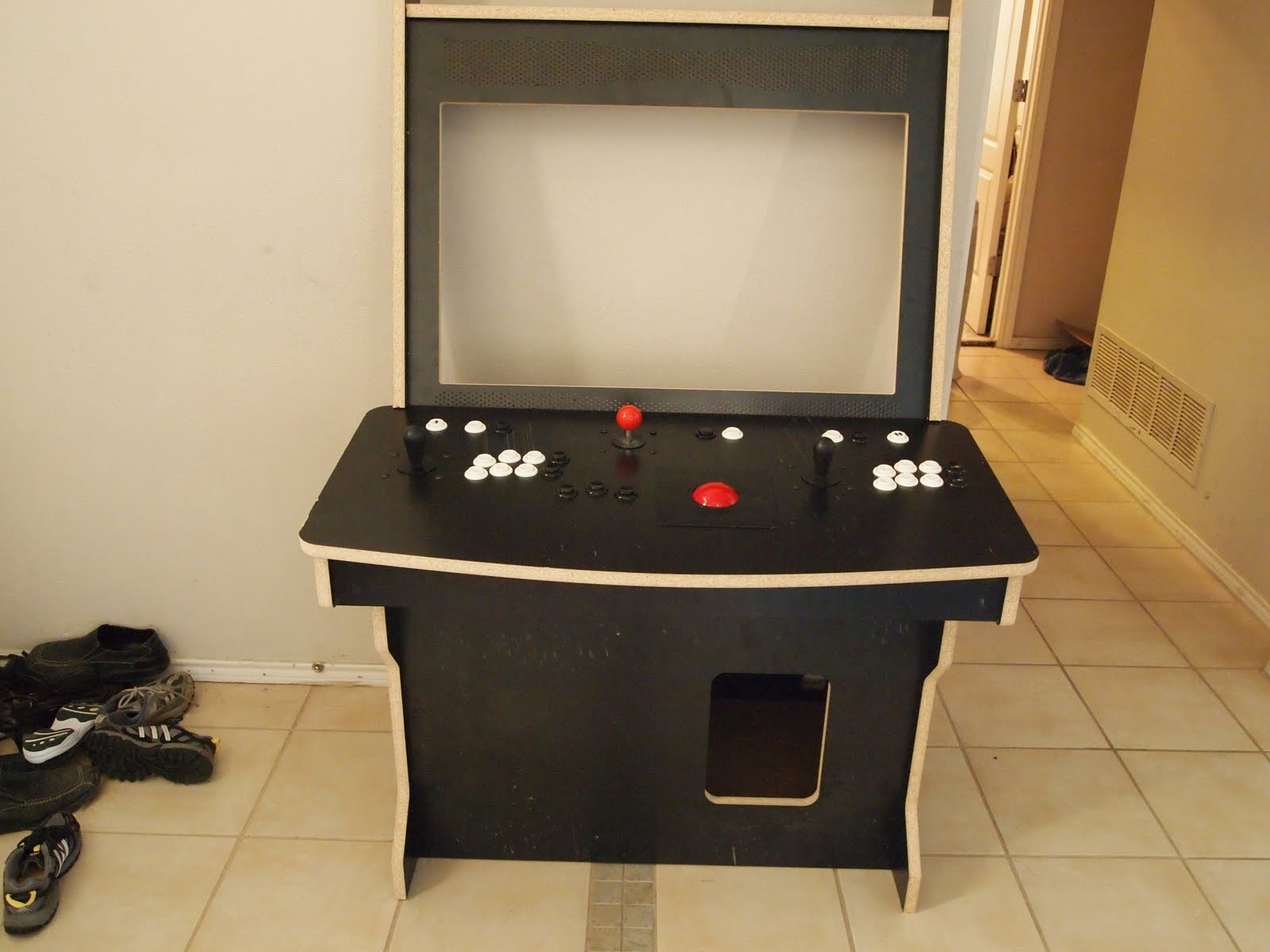

Ok, so Ive been working on stuff out of order, but ill order here in the log for reader ease. Ill go back to where I left off last; the console.
I decided to glue the box, instead of nail it... I built it in a way that will let me mount it to the booth while always keeping pressure on the right part of the console so it always pulls itself together... in other words, it will always be clamped. Nails or screws would be overkill here.
After the glue had dried on the box, I then started thinking of a way Im going to be able to attach the console to the booth.... I figured I could just use some straight bolts, that way I could take it off whenever I wanted.
I then created the mounts for the bolt to attach to. Hopefully these pics explain what I did here...
I put the mounts on the back of the front piece of the box, since pulling pressure on this will help keep the sides and bottom of the box tight.
As for the top of the console, I cut this out from pressed wood / melamine.
I was a little scared of making the round corners on it, since I would have to do it by hand with the router.... but after mounting the router upside down and manipulating the piece itself instead of the router, I found out it was easier to control than I was expecting, so I just finished off both rounded edges.
I put in the hole for the one single button that will be on the console. I plan on probably putting in more buttons for various things later down the road, but for now, the one button is all I need.
When I tried to mount the button in the hole...
...I noticed I had a problem.
The button mount was shorter than the wood was thick. It didnt reach. It scared me at first, but a second later, I realized I had my router right behind me, haha... so I cut a recess on the back of the panel.
That solved that problem. I was able to attach the nut on the back side now.
After the button was taken care of, I just needed to mount the top of the console to the actual box. I decided that I should do it the same way that I did the box bolt mounts, that way I can easily take it apart to be able to alter it later.
Heres the unpainted console sitting next to the early cardboard prototype I built for a reference. As you can see, the design changed completely, haha.
Heres a frontal view of the console.
As of last night, I had just finished applying the 3rd coat of black paint to the top, and the second coat of stain to the box. Also, I ordered some T-molding for it that should be here in a few days. Hopefully that should pretty it up a bit too.

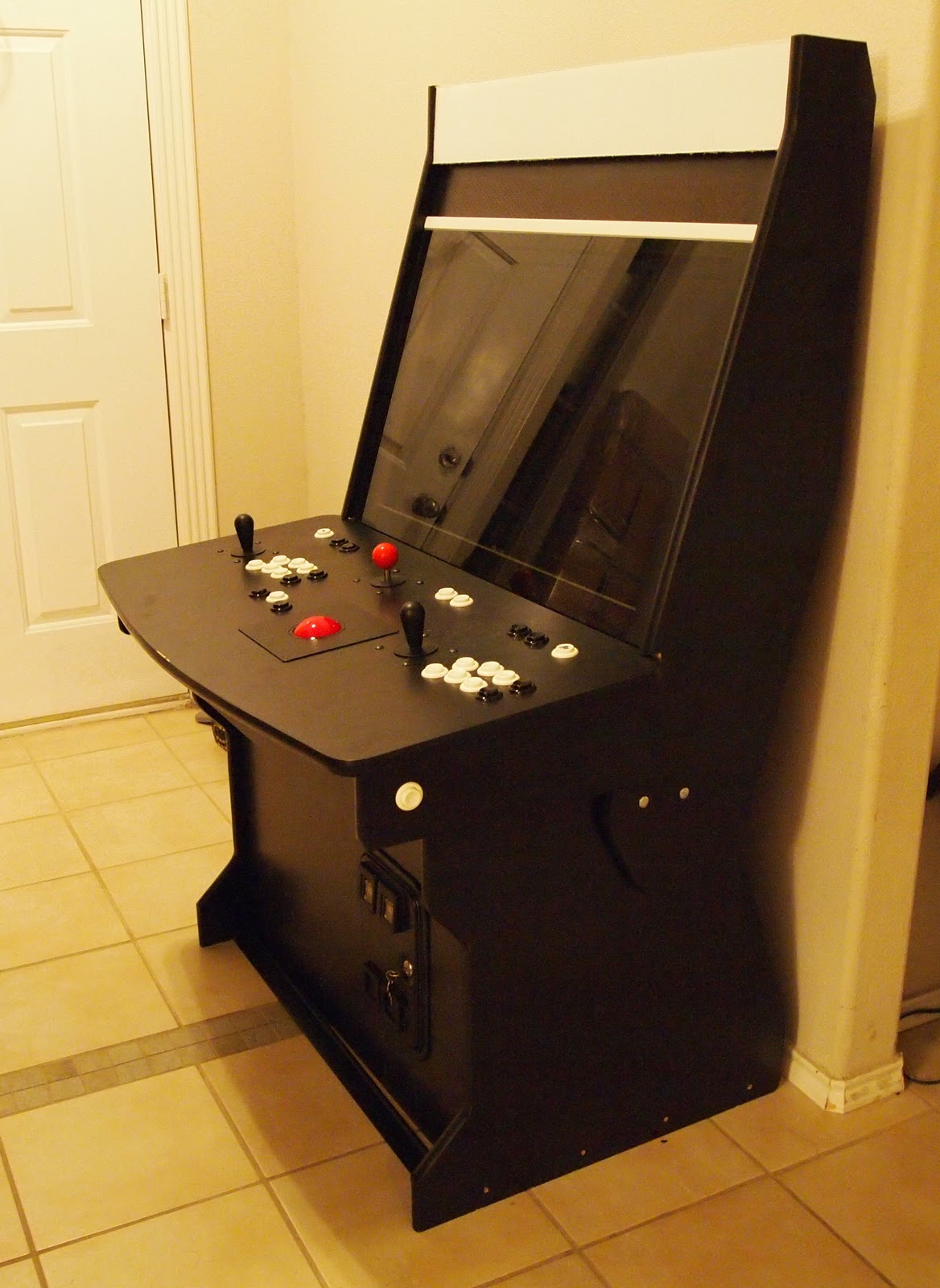

Heres what the console looks like after being painted and stained (Still have to put on polyurethane and the T-Molding)
All that was left to do now was attach it to the booth. To do so, I used some long bolts and screwed them into the bolt block things I made earlier. This left me with 2 bolts sticking out of the console.
I then drilled 2 holes in the front of the booth, below the monitor. The bolts of the console go through them to the inside.
The bolts come into the bottom inside of the cabinet. They pass through a 2x4 on the way in. At first i was a little skeptical about using the 2x4 as support, but I later decided that it will help the leverage of the console from the inside.
I put some oversized washers and some wingnuts onto the bolts and started tightening it down from the inside...
While i was tightening it down, i started hearing that dreadfull sound of wood splitting. I immediately loosened the nuts and went around to check out what was going on with the console. Apparently, it seems that the bolt blocks weren't attached to the box very well. I was able to easily pull it off, which revealed that the screws had barely gone through the wood to the box.
Easy to fix, but that could have caused some serious problems later if I hadnt discovered it.
After I had driven the screws in deeper, I tightened the bolts again, and everything seemed to be good. I think im going to have to add a small piece of wood to the outside-bottom of the console, because right now it tends to slide around a little, even when tightened (as I expected it would).
Heres the current state of the entire photo booth.
