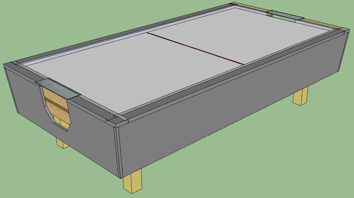

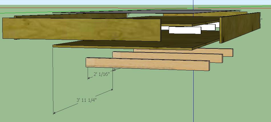

One possible plan I'm considering.  This allows the entire air box to be supported by the legs quite nicely.  Was thinking angled aluminum for the sides - for the puck to bound off.  Read something somewhere about  an air filter.  I might just enclose the blower in a box and use a normal furnace filter.  This might reduce noise at the same time?
Picked up some 7-segment led thingies (another Active Surplus bargain, tube of 15 for $5).  I plan to build a simple circuit to drive them.  Thinking to use optical sensors for scoring to drive it all.  Guess I'll need a 5V wall wart to power it.
The clock showing here will actually be the signal from the optical sensor.  Given that I have so many of these, I may allow for double digit scoring.
(my 7-seg LED's are common anode, unlike the linked article, so I'll adjust accordingly, swapping the 4511 for a 7447)

How about this for a cheating fast way for a play surface.  White counter top laminate on pegboard.  You'd still have to drill through the laminate though, and probably build a support structure.  Just a thought.
« Last Edit: May 27, 2010, 03:39:17 pm by syph007 »

That's actually my plan - white laminate.  Saw a sheet at a local Rona for maybe $30.  I honestly can't think of anything better.
Was planning to use a sheet of pegboard to guide the drilling.  Clamp it on and go to town.  But was thinking to have something sturdier under the laminate for support.  However, I'll have to consider your idea, as I am concerned with how much airflow I'd get through 3/4" (mdf/ply) with such small holes.  I'd either have to drill larger holes in the wood (so we're up to 8000+ holes now), or hope it works as-is.  Using pegboard under the laminate would require more supporting pieces underneath...which may not be so bad.  In the pic above, the plan leaves 3.5" which just happens to match any *-by-4" piece of wood.
Surface markings: considering red sharpie for centre line, that sort of thing.  Paint would invariable add substance to the surface, which I want to avoid.  A permanent marker would not.

Started modelling via sketchup
Missing goals, legs, blower, 4000+ holes, etc.  This is just the main air-box.  Some dimensions seem to be off by just a little bit.  See attached model for more detail - shows an exploded view (as above) and regular (all put together) view.

The attached model, as shown above, no longer has an exploded view, which is easy enough to make, but does have a plain view as well as as view showing an early concept for mounting the legs (shown in this image). The model is not at a point where one could actually build it, but is getting close.  The sides are angled at 5 degrees, which makes measuring things a real pain.  The goals are not complete (stating the obvious?).  The 2x4 support at the end runs right through the goals - this need to be addressed.  I am also thinking of using steel as support at the top (shown), then bending a curve into another piece of metal to discourage bounce-out, .....
The goal is to paint it black, but sketchup sucks at rendering, so I chose grey for now.  Also, I'm thinking of using 5/8" particle board everywhere, whereas the model uses 3/4" sheets.  Open to suggestions on this.
Overall advice is welcome and encouraged?

Updated counter circuit (see below).  An SVG version can be found here.  It shows a single 7-seg display, but I am thinking of going with double-digit scoring per player.  The diagram shows how to add the second digit.  It also contains some LED's I've added for debugging, and which are otherwise not required.  The de-bounce circuitry is another addition.
Updated build plans also.  I guess details are not visible in the attached pic.  I can upload the sketchup model if anyone cares.
Working on a cutting diagram, updated shopping list (incl pricing), etc.
Decided (for the moment) that all supports will be 3/4" strips of ply.  Now that I have a table saw, this is quite doable.
Also, may adjust the rails - as it is, it's too easy to place a drink there....and hilarity ensues  :'(  I'm thinking maybe to add just enough slope (away from play surface) to discourage placement of beverages.
