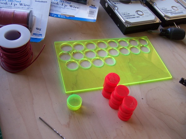

My first problem I encountered was (I know problem already : )  ) was that I couldn't make the control panel without the artwork being close to finished.  This is because I'm going to have button surrounds and curves etc and I am going to use a black and white print out as a template to cut parts out with.  So while I scratch my head on the big picture, I thought about beginning with something small, the illuminated pushbuttons.  I wanted them lit but not the entire button like the translucent ones offered many places.  I wanted just a 'ring' of light and with many thanks to Ond's retro build thread (thanks for the idea!) and a little thought I came up with this...(p.s. I used some scrap light sensitive plexi to achieve the glow more efficiently and one white led to light it)

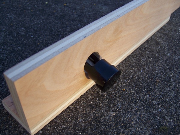

So I did replicate the process Ond used to make my first button and let me tell you it was a pain in the buttox! Hats off to ya man!! Heres what it came out looking like after 3ish hours!!
So then I thought about a different way to cut the disks out besides by hand...and found an local engraving shop that has a laser cutter! Now here's what I had after they did their magic...

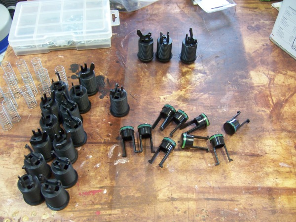

After the disks were cut out, I had to come up with a good way to cut my competition buttons at just the right place to maximize the glow effect and so you could see the plexi (so it wouldn't be totally hidden below the holder part) I have a table saw and came up with this simple little jig to hold the button in place while I cut it-

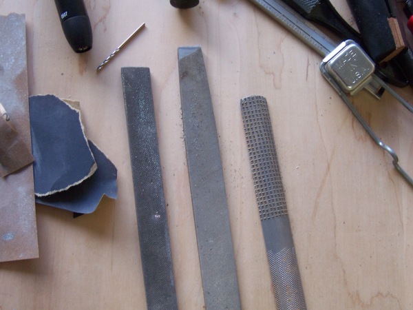

After the buttons were cut I then used sandpaper and a fat surface to smooth out the saw marks and scuff up the plexi disks so the glue would stick to them.  Then I used super glue and my fingers to line up the 3 pieces and glue them. After glue up I'm left with-
No matter how 'perfect' the laser cutter may be (which the disks are close to perfect but had a slight slant on the cut edge) after glue up I thought they needed to be filed and sanded to flush up the 3 sections-

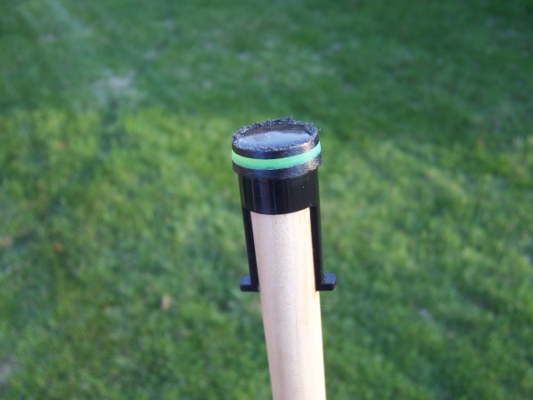

After filing I was left with this-

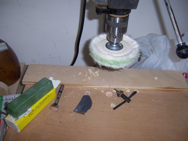

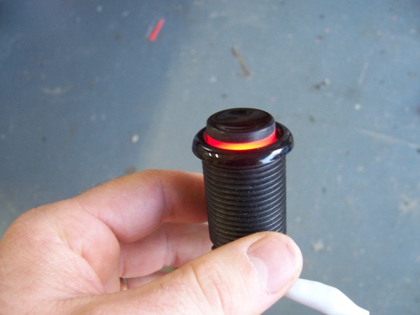

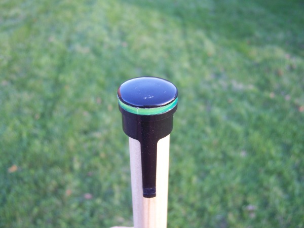

Then by hand I sanded them using 220 grit sandpaper, then 400 grit, 600 grit, and after that I buffed with some compound and came up with-
That took awhile now all I have left to do is-
Oh well

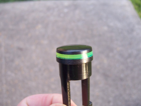

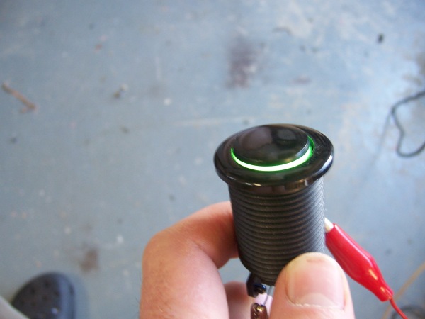

Well here is one button filed, sanded, polished and lit up in daylight-
Oh and in case any wanted to know, that dowel REALLY helps when trying to sand these things by hand.  It's just a 5/8" dowel that I wet on the end to make it swell so it would fit snug in the button bottom.
Does anyone know of a good cheap plastic polish, I just can't get the original glossy shine the buttons used to have on the top.  It's close but I know I can get it better
  Have you tried Novus?

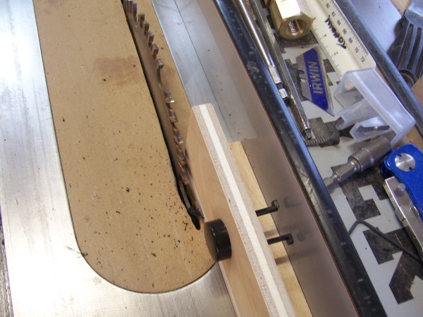

Well I was able to get a little done today.  So after I had the cp laminated, the next step was to attach the second piece of 1/2" mdf to the bottom of the cp to give extra strength to the controls area.  It also allowed me to use the straight edge on the bottom to make my kerf cuts.  So here is the first pic of the attached extra piece-
And like Hewskie was explaining, here is the kerf cutting I was describing, I did this both behind the speaker section and at the top between the screen and marquee-
