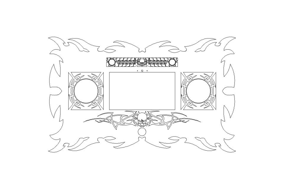

My big trouble at the moment is that I can't decide on a color scheme so that I can buy the trim and start designing the artwork.
