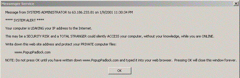

This worm could have been a lot more destructive...  It's actually kind of a good thing because it will force Microsoft to repair a potentially devastating bug, and also to encourage people to protect themselves behind firewalls.   (Hmmm, I think I should probably use a firewall).
Ha ha...  Moments after I fixed the worm, I got this popup on my computer:
Another little reminder that a firewall is a good idea.
Can anybody recommend any good firewall software?  I'm running Windows XP Pro...

I heard zonealarm tracks your activity and sends all the info back to their servers..  So don't be downloading anything illegal, say, mame roms. ;)
About the popuppadlock.com "popup" (irony anyone?) that is just adware.  download adaware and scan your system.

GRRR ! !  >:(
I got one that looked similer in black dos box.
Also asked to click yes or no(can't remember).
This is some kind of virus ? ??  ???

« Reply #26 on: August 12, 2003, 05:48:57 pm »
Those "Messagner Service" pop-ups are actually an exploit to use Windows Messanger service. It's not a "virus" per say, but it is another MS Exploit. Don't worry, It won't hurt you, it's just another annoying way for spammers to pop-up info in front of you.  If you want to make them go away for good disable your Windows Messanger service.

BTW, just diasble the messenger service and you won't get those 'pop-ups'
