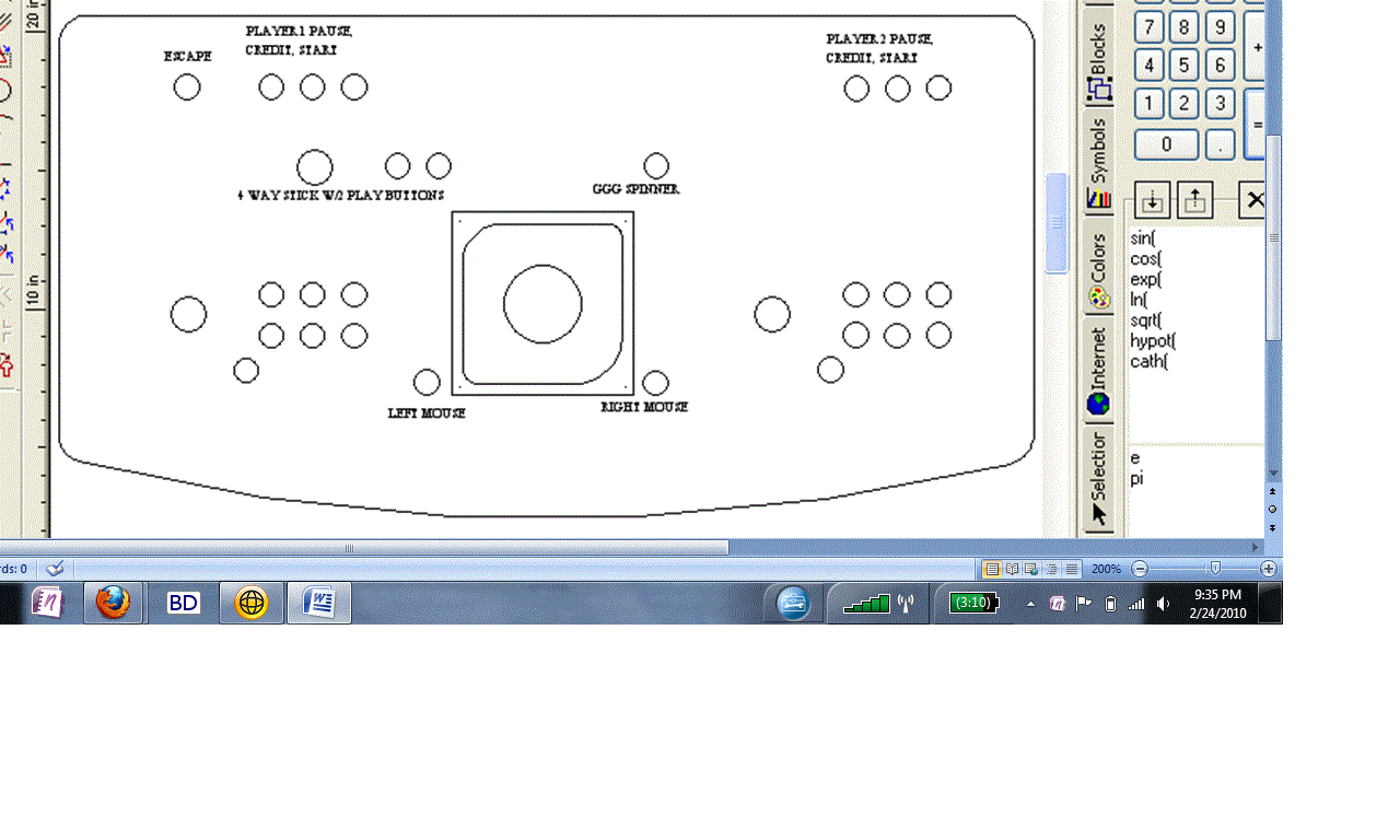

So I am in the process of designing my control panel layout and control panel overlay art.  I ordered a 2p control panel from arcadesrfun. I also have some decals I bought from pongo.  Very nice quality I must say.
So I do have one stupid question and one opinion quesiton.
1. First the stupid question, you guys are going to kill me for asking, but...
What kind of screws did you use to install your joystick? I want to buy those now, so I can have them later. I see them on the arcade store websites, but I have a feeling they will be cheaper to buy from home depot or ace hadware.
2. I have asked around to see what buttons people think are best to have on the control panel, you probably saw my thread, any suggestions on what buttons are needed other than the p1, p2, coin, and player buttons?
I asked Jack, from arcadesrfun, to see if the jukebox buttons would work on the front.  I also want the side buttons for pinball.
I'm using Maximus Arcade, in case that's ueful in thinking about what buttons may be needed

Also what do you think about this idead? I thought of mounting an ipac underneath the control panel.  I really like how it looks when people do that, because it makes it easier to be neat about things.  I'll probably drill those holes on my own. So I can decide where everything goes.
also another update about the cp design, I really like this button layout (combined snk and capcom design)
I'm taking out the slot that's cut for a flight stick.  I won't really need that. I'm trying to figure out where I can place some jukebox buttons and how many I will need (add, next,)
These are the buttons other than the ones used to play with I will be adding. Player 1, 2, coin 1, coin 2, pause, exit.  I think that's good right?
And i'm still looking for an overlay.  Delusional, Would you mind sharing the art you used for your space invader cab? I might do something like that.. but blue? I was hoping to see if I could make my cab stylish, and since I'm starting with the control panel this will influence how the whole cab will look. I've been having a hard time finding images or user made control panels that look stylish.
I tried a wood patter.. looks funny, marble, looks cheap, so maybe I should just keep it black with button labels as part of the overlay?
*edit* I also forgot to mention that I've narrowed my design for the rest of the "cab" to either building a stand for the cp and mounting an lcd tv, or making one of those new custom made slim arcades.  I think Taz designed one, but I also saw another one that was really fancy and made out of metal. I think that same guy that designed this won some kind of award for his previous arcade cabinet, can anyone remember his name? I can't find his design anymore.   if I can figure that out then i'll probably be doing something alone those lines.
Glad you like it!
I have a better drawing of that layout now. Not to be picky but it is really closer to the Hybdrid layout on www.slagcoin.com without the right two buttons, and then the seventh button added in much lower on the left. Also, the joystick is closer. I can't give SlagCoin enough credit on this, I read everything on that site and made a lot of decisions based on his info.
Cowboy Arcade Project ThreadCowboy Arcade Project Website

Wow! That looks great!  I'm in the midst of configuring my control panel.  It will be franken panelish... but it seems to be the case with everyones first cab.
I really like how you've designed cabs for specific types of games (like your space invaders arcade and shmup arcade).
 Here's the layout I started with
I'm asking him to move the trackballs button to the left of the trackball and add a third one.  I'm pretty happy with everything else.
Does anyone have any ideas how many side buttons I would need for pinball?  The player 2 pause I'm probably going to make a reset buttons instead.  I don't think I need two pause buttons.
The trackball and spinner will be added at a later date.  I didn't expect them to be as expensive as they are. I also have some lightguns.  I'm going to try and find a holster for them.  I've seen a bunch of people using bike rack pieces.

I would get rid of the left and mouse buttons next to the trackball.  Instead, you can put them next to the 4-way joystick.  That way in Windows, they would work as mouse buttons, but in MAME (here's the stroke of genius) you simply reassign them to be buttons 1 and 2.  So, for example, in MAME you would see:  Button 1:  CTRL and Mouse button 1 and Button 2:  ALT and Mouse button 2.  What that would do is allow your mouse buttons to be use in games.  That's what I did on my panel.  Works perfectly.
If you plan to use Maximus Arcade, you'd probably want the following buttons:  Select, Exit, Favs and Back.  The back button will get you back to the main screen so that you can choose which emulator to use.

Here is a sample of all the colors.

Genius! What about the trackballs that use 3 buttons? How did you configure that?
Re: Recommendations on Arcade Cabinet Kits?
« Reply #65 on: February 25, 2010, 10:21:02 pm »
I never use the middle button, so I don't have it on my panel.
I have the capability to wire it up, but didn't even bother.
