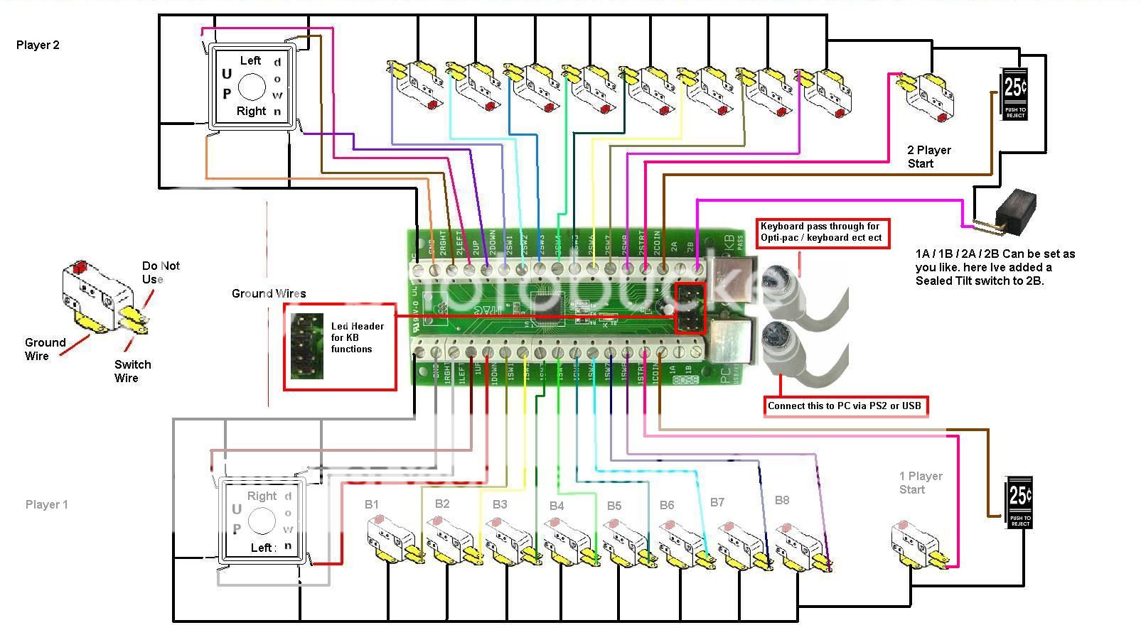

hi all.have an old fruit machine which i have turned into a touch screen  jukebox.what i want to know is how can i wire the buttons on the fruit machine to controle the volume,if it is possible.
i have managed to wire one of the buttons as a power switch to turn the computer on and off.
thanks for any help

You'll need a keyboard encoder of some sort and then depending on what jukebox software you are running you will need to assign button/keys to those functions.

Buy an Ultimarc IPac
or
Groovy Game Gear KeyWiz.
They both would be great for what you need and if you wanted to add buttons for something extra later, its right there with a neat and easy setup!

if i get one of these,can someone explain how to wire it up to the keyboard  as shown on the picture.
the on off switch is already wired up to the motherboard.
thanks

Use one of the two mentioned keyboard encoders above. Run wire from the buttons to the encoders. Plug the encoder into a PC PS2/USB port. On the bottom of the buttons, you should have a switch similar to these in the diagram below:
You can daisy chain the ground wires to each other and connect each button wire to one of the terminals.
Depending on what encoder you use,
You then need Ultimarc's WinIpac to program the encoder:
http://www.ultimarc.com/download.html
or Groovy Game Gears KeyWiz program:
http://groovygamegear.com/webstore/index.php?main_page=product_info&products_id=303
Program the encoders to your desired keyboard settings and you should only have to program just one time.
Fordman

thanks for the diagram.the switches on the fruity are like the ones shown.on the diagram of the switch, it shows not to ues the top terminal.what will that one be for.is it possible to connect a bulb so the res switches can light up.
That contact would be NC, which would keep the switch always ON.

how do we power the ipac?

« Reply #10 on: January 21, 2010, 04:18:56 am »
the Ipac is powered through either the usb or ps2 cable. It is low current like a keyboard and only needs 3 volts (correct me if I'm wrong here) for power. Some of the wires in the usb/ps2 cable are for power and others are for the actual keystrokes.
