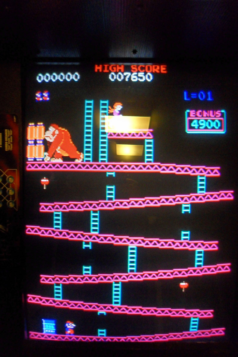

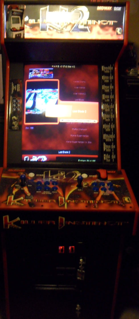

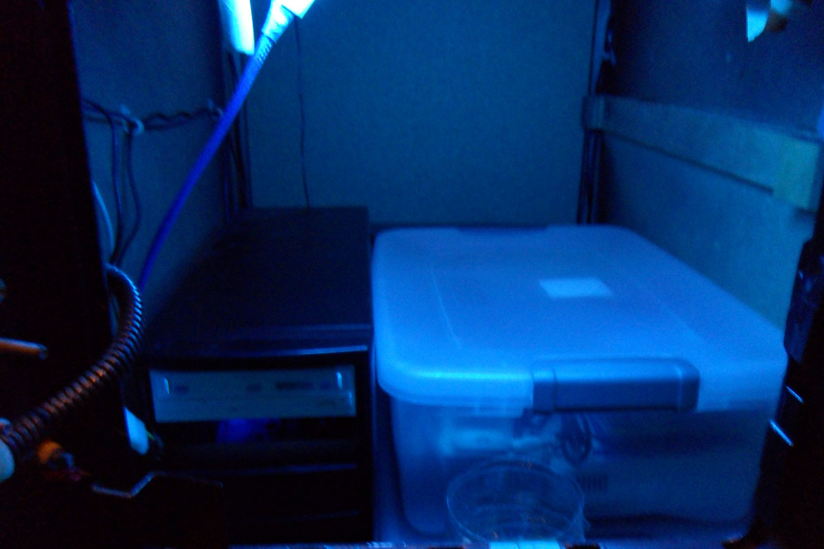

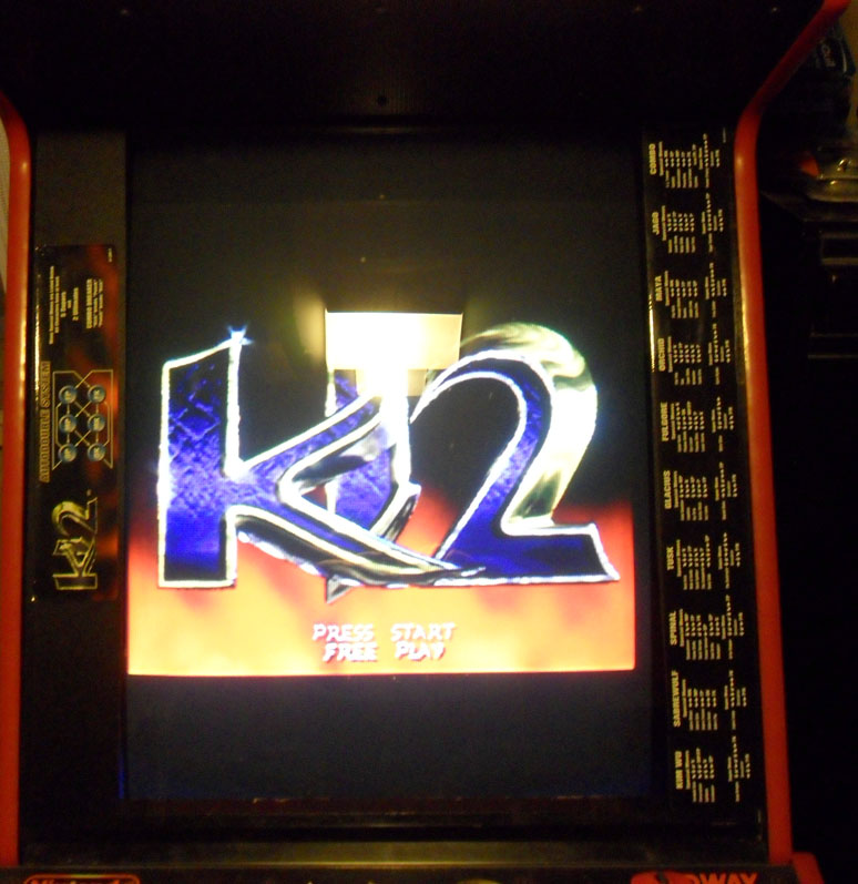

Re: Killer Instinct 2 MAME
« Reply #14 on: February 11, 2010, 11:10:43 pm »
3 months later, lol.
not much has changed with the cab, I set up almost all the game lists , still trying to find out if any other emulators will rotate the display, considering emailing the guy who makes Kgen/Fusion, see if he could do it.
Anyways, I added black vinyl to the glass to act as a bezel, then I put the old KI2 stickers on it for some "art" and to break up the black, but it does look kinda weird vertical but I like it.
heres the pix:
plenty of stoage inside! got my tub with my xbox1 and games, and my 2 dreamcasts and games, might have enough room for the PS2 tub as well. The Saturn Tubs will go on top of the cab =)
MaLa running my KI2 theme, which is just a quick edit of John's Arcade theme, the lighting sucks, I know.
Samurai Shodown 5 Special, for no real reason.
Do the stickers look weird vertical to you?
the very very top , and very very bottom are clipped by the wood, this was the best game to show that on. Nothing to really interfere with game play, but there none the less.
EDIT:yes, my high score in donkey kong is that pathetic
