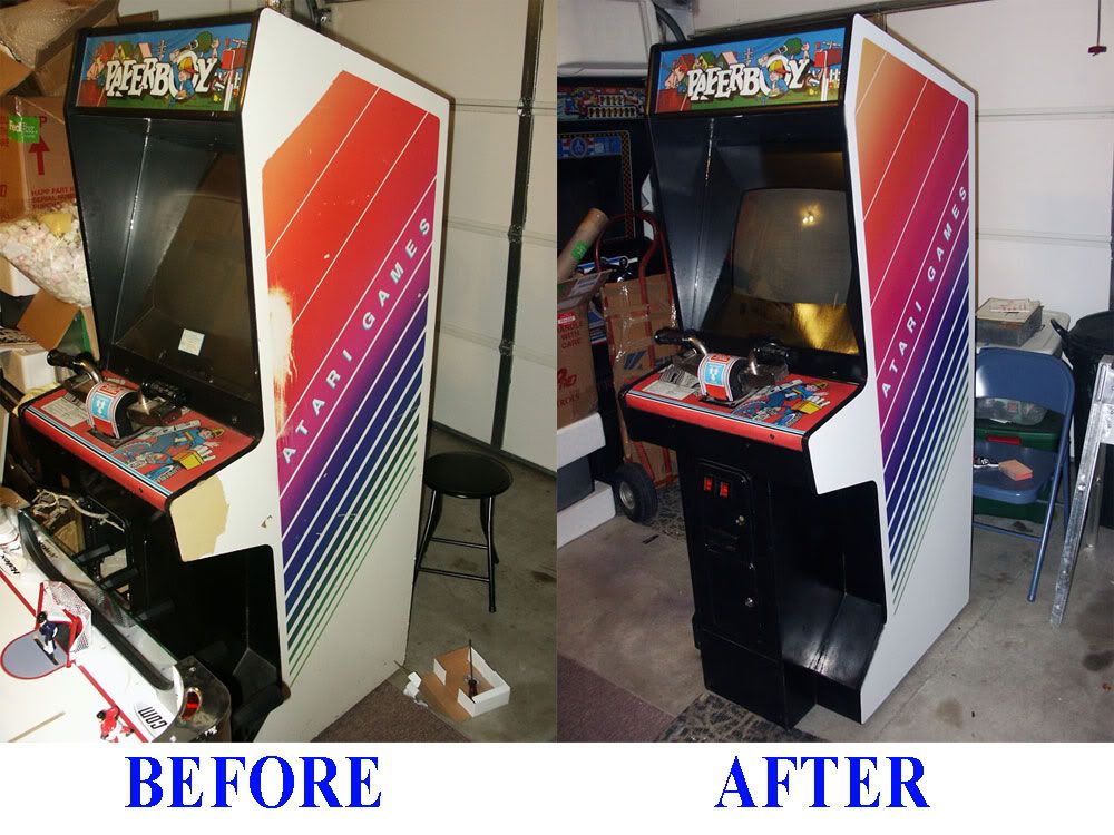

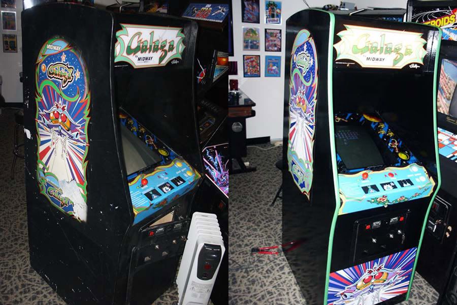

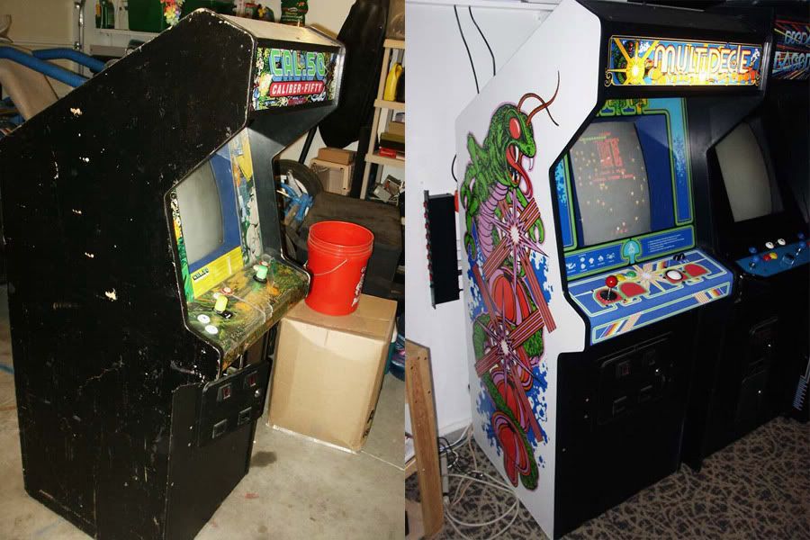

Well at least 2 of us who stated we are waiting for ultimarc gun housings are collectors/restorers, so you can't accuse us of being lazy with regard to this hobby. ;)
bkenobi
  • Posts: 1668
Re: Its Here: Ultimarc AimTrak Light Gun Module
« Reply #335 on: October 05, 2009, 12:29:39 pm »
So if you clean up a dusty cabinet, it's restored then?   :lol
Yup...just a rag and some Simple Green...
drventure
  • Posts: 4152
« Reply #341 on: October 05, 2009, 12:56:18 pm »
That and a great big bag of magic pixie dust  ;)

Ya, you just buff out all the scratches right, then the artwork magically comes back! :D
