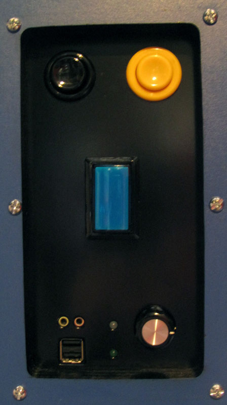

Why put them in the back? Put the at the front and make a feature of them:
There are a few more examples here
And because i'm building a bartop, then there isn't any room for at the front, so that's why it's at the back.

Check out frontx - they have lots of nice stuff like this:
That stuff is cool, but it adds up FAST!  I like how clean it is though.
  • Posts: 7994
Re: How to build audio jacks in the backpanel of your MAME cab?
« Reply #13 on: September 16, 2009, 02:02:36 pm »
yeah - you are correct.  I ordered a bunch for my jukebox (will I ever finish??) and it came out to around $60 or something for some USB extenders, the headphone jack, ethernet port and some RCA jacks.  Long term it will be worth it though.
The headphone one pictured is super easy to install - just drill the hole and screw the ring nut on and that's it!
