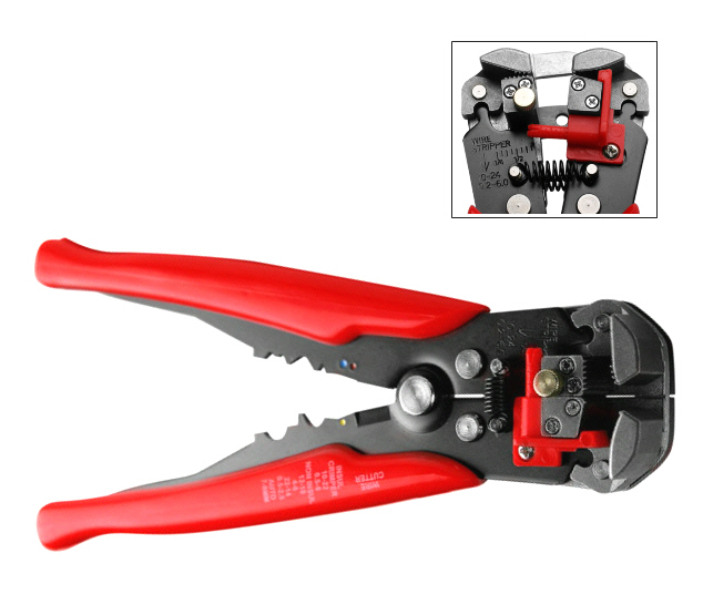

FrizzleFried
  • Posts: 5159
    • Idaho Garagecade
Re: New arcade buttons? No wiring?
« Reply #12 on: August 09, 2009, 02:28:50 pm »
The key to success is to get a quality wire stripper.  I'd go absolutely ape ---steaming pile of meadow muffin--- if I didn't have one...

Encryptor
  • Trade Count: (+34)
  • Posts: 1287
« Reply #15 on: August 09, 2009, 10:00:41 pm »
Frizzle,
What brand of stripper is that and where did you get it if you don't mind my asking?
Encryptor
