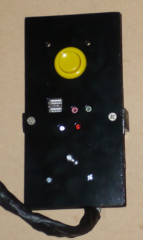

OK, I followed your plan and used a 100K pot. It is wired as such:
PC -> POT -> Headphone Jack -> PC Subwoofer (powered)
As it should, when I insert my headphones, it cuts out the line going to the PC Subwoofer, which of course was the desired effect. The problem I am having is that the headphone volume ist wayyyyy to low and does not adjust to changes of the pot (twisting the knob). Only when you adjust to pot to full (= 0 resistance) does the volume turn all the way up.
After talking with a few friends of my, the consences seems to be that a 100K pot is way too large for the widerstand found in your garden variety headphone (4 - 16ohm). They suggested I replace the pot with a 1K pot.
What would this do to the connection going to the pc speakers. I have no clue  ??? Is this even a choice? How did you solve this problem? (Questions, questions, questions...)

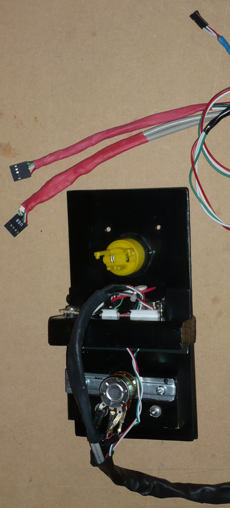

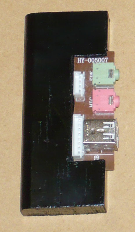

Thanks for your reply. What do you mean by both speakers? The left and right signal from the pc (speaker out) is wired to the pot. Just like your setup, I have one (line in) cable that is fee d into the subwoofer. From the subwoofer, the speakers are wired into that. The subwoofer runs fine and reacts to the pot movements.
I have a 100K Linear pot. The writing on the side says 100KB.
I guess pictures are worth a thousand words - here you go.
Let me explain what you will be seeing:
Front.jpg: This is the front of my panel 2 buttons Exit and Tab, 2 USB Ports, 2 Composite Sync Ports, the Volume Pot handle, and 2 headphone jacks.
Back.jpg: (see front.jpg)
input.jpg: the rightmost cable is from the pc and goes to the pot. Next to the pc cable is the subwoofer "line-in" cable. It is feed from the first headphone jack. (see wiring.jpg)

Looks like your headphone jacks cut the active signals, not ground?
You seem to have a linear pot, but perhaps a 50k or 10k pot would work best, especially if you are finding that all the volume variation happens over a small part of the knobs' rotation (I have seen a little of this with 100k pots too, but never enough to worry me at normal amplifier output levels). I still think that 1k is a bit too small though. I have had the best results using some small B50K dual-gang pots (linear) that I de-soldered from old PC multimedia speakers (I couldn't find exactly the same ones at Jaycar, which is a popular electronics parts shop in Australia).
