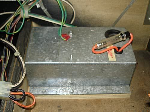

First off I think this is a re-import game. The filter line does not have an outlet plug. Here is a pic of the line filter:
(the external fuse thing was put in by a pinball tech because the original fuse holder was not staying in...

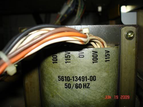

Here is a pic of the Xformer:
I don't know anything about these components but the highest value listed on the tranformer cover is 115v and the sticker on the back of the pin says 120v... does that mean anything?

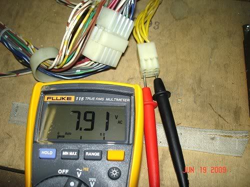

« Reply #3 on: June 19, 2009, 10:39:18 pm »
That's how you measure it? I would have never though to do that!
I get the same reading 7.9:
I don;t know how you measured with the harness conneced though...did you measure at the pin on the power driver board to get the 7.7?
So by getting 7.9v does that mean that it is not a problem with the transformer?
