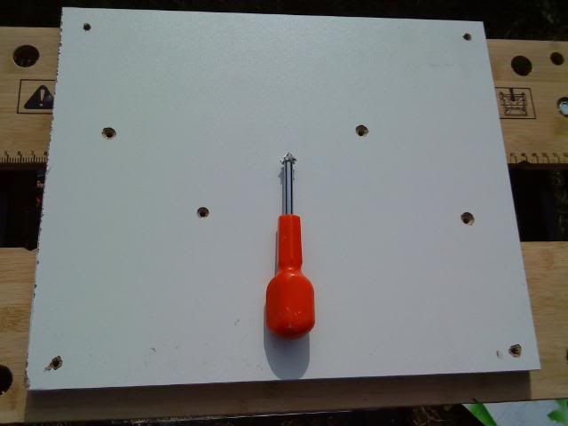

OK, time to bond the new base onto the cab.
I've used a high grade ply 'sandwich' of 2 sheets to allow for both strength and the inclusion later of either adjustable feet or castors.
The original base of the cab was pretty uneven in places, so I had to make sure that all 4 corners were level before the new base could be fitted. The cab would only rock like a table with a 'dodgy' leg.
This seems the best option for me. The thought of knocking the 'old' base out and putting a new one in, then fill in the bottom edges doesn't seem the best solution. This cab needed a new base to sit on, the old one was simply retired. I understand that it will be about 0.8" higher than before, but hey, it's close enough and way better than before.  ;)
The base will be bolted in all 4 corners as well with large washers attached both sides. Countersunk as well. The base will be finished off before the filler is applied, probably slightly chamfered to the bottom and painted matt black.
Pilot holes were drilled to support the new base whilst the Evo Woodglue sets. This glue is just fantastic and is actually stronger that the wood itself. One has to be careful though. Once this stuff has set, forget about repositioning anything, so it's 'right first time'.
I decided to place it upright as there is over 40kg on the new base to set it completely flat. Next job ...... Woodfiller the rough edges and sort the hole out.

The base is nearly sanded down completely now. The result has been positive I feel and it'll look so much better when the laminate is applied and the T mounding is sorted. The hole was finished with glass fibre and woodfilled to finish. The new base was then treated and hardener applied. It really is SO solid and probably stronger than new !  Don't forget though, the base is far from finished as the final smooth coat has to be applied once the remainder of the base coat is sanded with 1500 paper.
I did some work on the power board this afternoon. I used the rotten original one as a template for positioning the pilot holes. The 4 bolts used for grounding were drilled straight through and countersunk. I removed the surface rust from the transformers and the connections with the trusty Dremmel and polished what needed to be done. There are new zinc coated hex nuts throughout.
All of the contacts & solder has been cleaned using PCB Alchohol cleaner and they've come up well. The casings of the transformers were also given a coat of enamel spray.

The front was relatively straightforward compared to the sides. I had to carefully measure the exact dimensions of the front, in this case, 18" wide x 29.75" long.
I did this using a long steel rule, which I use also to cut the straight lines up against, again, remember that if you attempt this yourself, WEAR GLOVES !!
Anyway, the front was checked for any dust & crud, then painted with Contact adhesive (same for the laminate) right up to the edge. Don't worry if some excess squeezes out, you can deal with that later, but for now it's important to have bonding up to the very edge.
You'll notice that the edges of the cab are now protected by 'low tack' masking tape until the T-moulding arrives, that's to stop any accidents !   also, the inside edge of the sides are masked out to prevent the Contact adhesive from spoiling the black finish. as soon as the laminate is applied, remove this tape as it will be a bugger to remove when the adhesive cures.
The coin door was then cut out by hand after marking it from the inside with a pencil. After the two were brought together, lots of pressure is then applied to ensure good adhesion.

The coin door aperture has ovals cut on the hinge side to accomodate the fixings so this had to be done with a round file. The sides were done with the ba$tard file same as the sides, then some countersinks were cut on the facia after the pilot holes for the studs were drilled. The reverse side of the coin door has strengthener rings welded to the base of the studs and the countersinks accomodate these.
The frame was then offered up to the facia to check for an exact fit.
The steelwork has been finished by hand as well. The shotblast, treating and powdercoat did the job, but after the completion of the CP, the rest of the exterior steel didn't meet this standard, so I decided to finish them in the exact same way to the CP.
The signage from the cab has been cleaned up and laminated ready for installation, but I still require a Bally Midway aluminium plate from the rear of the cab as this was missing.
