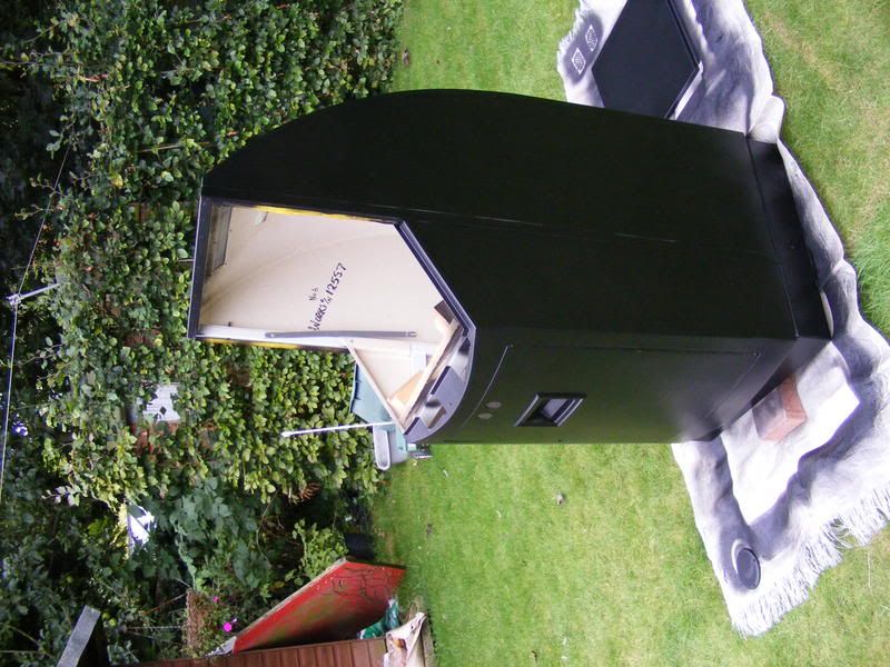

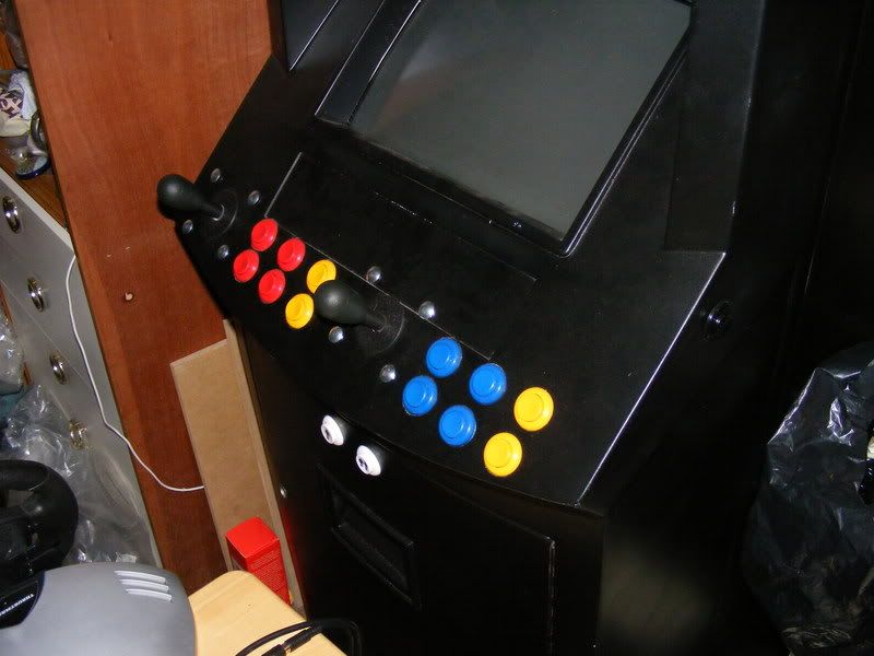

Okay, here's a photo of not the greatest cab in the world. This is the first one I built and its the only one I can get to at the moment - my plan is that now I know the problems and hurdles with these cabs I can make a far better job of the next one! (Yes, I have multiple cabs! :)) This ones just for messing around with ideas!
Sorry about the photo quality but if you look closely - above the buttons is a rectangular indent - this is obviously one hurdle... its not deep but to make the panel presentable you obviously want a degree of symetry! I havent taken the measurements but hopefully the size of the sticks and buttons will give you some idea of scale... if anyone really needs them then I'll venture into the dive of a cave that is our garage! Suggestions please! (not on the garage! ;D)

wow...thats going to be tough.  did you build that?  was this cabinet originally not an arcade cabinet?  i have never seen a cabinet shaped quite like that before.  the control panel angle looks uncomfortably steep. (unless you play from some kind of reclined position with your legs straddling the cabinet.  what is that rectangular cut out there for?
with those dimensions, i don't see how you would ever make a 4 player control panel work.  if this was my cabinet, i'd bust out a saw or two, cut off the control panel, build a box type panel to attach to the cabinet, that is wider than the actual cabinet.  preferrably at a much lower angle.

Man, that's an extreme angle!

The cabs are actually transport kiosks - the indent was where an adhesive label once was - however, the shape very much resembles that of an arcade cabinet (other than perhaps the steep front panel - which I think when you look at the photos below isn't quite as bad as you may think - you note this may be uncomfortable, but actually it is quite good when sat on stalls - it had originally been a concern but it works pretty well, I think!) The shape of the cab is actually very nice - here is an early shot -

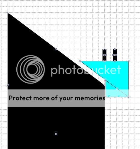

I made this quick drawing before I saw the full cab:
Thought maybe you could make a "deck" to sit on that slanted area and secure it
somehow to act as a 4p control panel.
Now that I see the full photo however, I don't think I would do it that way.
That is a very unique cab and a deck would ruin the lines on that thing
horribly.  I would suggest if you want four player, hook up a four player
USB hub and use two additional gamepads, it will be much cleaner,
and really how often do you play four players?
Just out of curiousity, how did you score one of those kiosks??

I think the first picture was very misleading on the angle - it is steep but not too steep - haha, yes, its very odd how I got hold of the kiosk - I'll let you all into a secret, I have around 10 of these! :o
They convert really well to arcade cabs - I don't think it would enter your mind that they once were transport kiosks - great size too and very light compared to your standard cab as they are made from fibre glass!

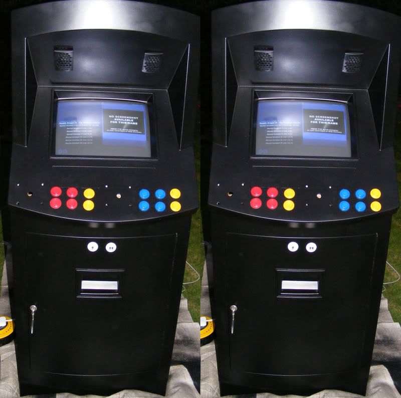

since you have so many, you could always have two cabinets side by side, linked together.  you'd only need 1 PC even..just wire up the second cabinet as players 3 and 4, and make sure the video card in your PC can support two monitors.  have both monitors displaying the same image.  then you'd have plenty of room for 4 players, and with two screens, it wouldnt be crowded
it might be where I had them set out though! ;D No, its a good idea, I had considered something similar but not quite the same. I thought if I ever decided to emulate anything other than MAME/Arcade I could always do some kind of system link between 2 cabs. Could be quite nice!

How thick is that fiberglass that you have your joysticks mounted in?  Cause those style joysticks need to be mounted in at least 1/2", and better for 3/4 or 5/8" thick panels.  If you don't then the joysticks are too tall.
Also, the buttons should be closer together if you are going for a SF2 layout.
I'm sorry if this is too critical, but this is the truth.  You would never be able to play any Street Fighter game on that cabinet at anything approaching skillful without causing severe damage to your wrists.
I think you should consider some option to make the CP much shallower before you do anything else.
Also, now that I think of it, I think a steering wheel would sit very well on the current angle.
Not too many people build dedicated driving MAME's.  I know that I am always scrolling through my rom list and wish I had a steering wheel.
I like this idea. You can get 4 people on there and keep the cool shape of your case. Plus, I'm not sure if you could make Mame work for this, but you could set it up so that multi-monitor games display properly across the displays, which is something that you don't see very often in home-made cabinets.

As I'm intending to have 2 cabs for myself, I've been building them so they are easily swappable with whatever system I want to run MAME on (PC or MAME)... As I have a few PCs hanging about I think I may well build both cabs with this idea in mind... I agree with you Chris2 - it is a nice suggestion - one worth investigating!

The fibre glass isn't all that thick but the sticks don't look odd or feel uncomfortable at all - I'm pretty happy with how they are - and there isn't much I could do about this anyway without making it look like a dog's dinner... the fibre glass is also really stong so I have no concerns about stability either! I may consider replacing the sticks with something different - any suggestions for something better?
Totally agree with the comment about the buttons - the buttons as they are, are admittedly a shambles - but with doing this I know how to ammend them next time. They aren't actually that uncomfortable and they are still easy to utilise but as you say they can definately be improved!

put a PC in both cabinets, on the second cabinet use a KVM switch so that you can switch the controls and monitor between being a stand alone cabinet, or 3rd and 4th players on the PC in cabinet 1.
or, do the xbox method, wireless controllers for the second cabinet, and just send the video output to both monitors.

4 Player Cab/Dual Screen Project - with Photos...
« Reply #31 on: February 15, 2009, 06:36:39 pm »
Amended title...
I found this - http://www.amazon.co.uk/Rextron-Port-Share-Switch-REX09422/dp/B001HN5540/ref=sr_1_9?ie=UTF8&s=electronics&qid=1234739802&sr=8-9
and wanted to get people's opinions. If I was to use 2 seperate computers and keyboard encoders but have the same picture beamed to both screens would this do the trick?
I have a feeling when it says 'first come, first served' it means when people are hammering away at the buttons on each cab it might struggle to register the keys... opinions please!
So effectively you have something like this -
(obviously with joysticks this is an old photo!) each cab would have a PC inside with a keyboard encoder for controls but they would both effectively controlling only one of the computers (which ever one is running MAME)
Kind of want to know whether or not the hyperlinked box would allow this to happen!

here is what i would do:
two cabinets, two computers, two keyboard encoders, two monitors
each cabinet is completely independent from the other.  cabinet 1 is set up completely normal, it's video card needs to have dual outputs.
the second cabinet is set up relatively normal, however the keyboard encoder is reprogrammed so that it uses a completely unique keymapping from that of the first cabinet.  a KVM switch is installed in cabinet 2 so that it can be a stand alone 2 player cabinet, then you press a button, and it is mirroring the video from cabinet 1, and is not players 3 and 4 on the cabinet 1 PC.
i hope i am making this clear.
i dont know if the encoders you were planning on using would work with this or not..but this would work fine with an ipac, or any other encoder that allows for reprogramming.
