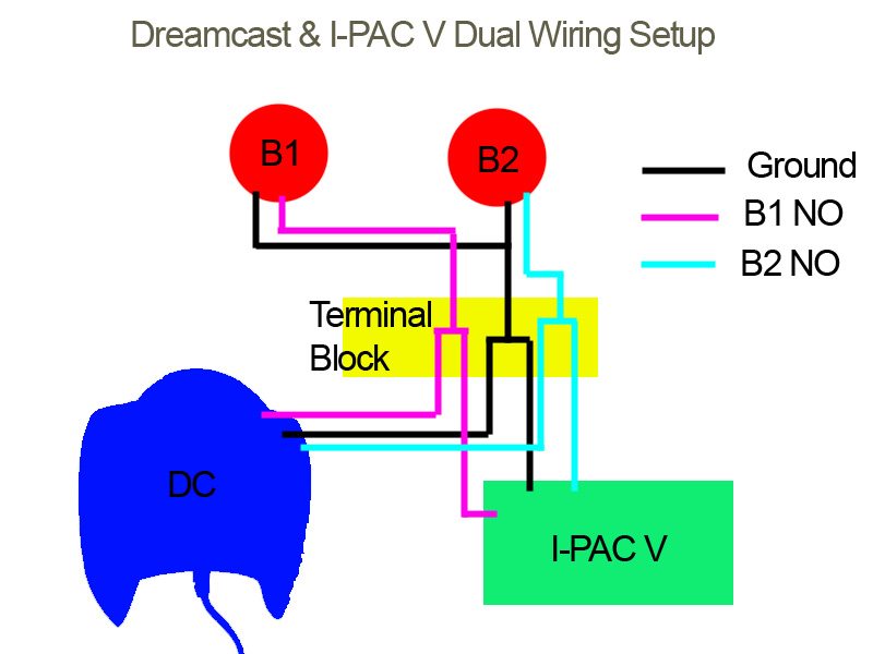

Ok I think I will get the offical pads, it may not have wire holes like the madcatz but its just some scaping and its done.  Looks very easy.
So the big question how to wire it along side the I-PAC so that I can use both.
I think this is how you would do it:
Just split the wires to each right?   But I want to say somwhere in a diagram on another thread that they showed the +5v and +3.3v from one device connecting to the other and also the ground connecting from one device to the other.
I do not know if this applies to my setup, also would anything bad happen if both systems were on at the same time (PC and DC)
The I-PAC uses USB, and I can wire the DC up into a project box with some kind of connector (I know DB9 is preferred but maybe easier for me to use a ATX extender) so if I had too it should not bee to hard to unplug the IPAC and plug in the DC adapter.
so looking for words of wisdom here, on how to run both at the same time or if its just smarter/easier to only run one of them at a time and unplug the other if its not in use.

Im still trying to learn what  need to do to simultaneously wire both the dreamcast pads & the ipac to the buttons at the same time.

He kept the sensors attached, the new method is to short them out.  I think thats the difference.  One way or another I will found out first hand and can get back with my results.
My picture I drew is not showing up for the wiring question so I think I need to go host it somewhere else.
So this is what I was thinking off the top of my head:
But I think I saw somewhere that you need to wire the power & ground of the controller & ipac together too?
Also curious of the effect of haivng just one or both units powered at the same time.

Update: Yes I found the source you need to wire the power source of the two PCB's together, the ground is already tied together in the block so thats ok.
However this setup has one very big problem, you can only have one pluged in at a time, failure to do so means frying something.
So I have labored over what I am going to do all night, I am going to spend more than I wanted and this is going to take a lot of work (hopefully I can solder good enough to do it and find the parts I need.
Im going to go for a fully modular setup.

Madcatz are great hack controllers! Prove great on any system I used them for so far. No need for wire holes on the DC they already have all the solder points ready to tack on to on the center of the pcb, don't even need to touch the contacts. I grabbed a pair of these and had them up and working in no time.
Just wondering what the advantage to the IPACV is? I'm sorry don't know much about it I have some homework to do on it. Why not mount the DC on a piece of wood and use a jamma edge connector and call it a day? Then it would be plug and play like any other pcb.
