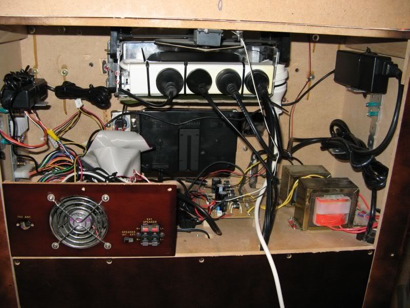

I went to work striping out the insides of the cab i removed the speakers, headunit and 10 stacker cd
Lucky for me everything was powered by 1 board so the neons would stay on if i left the switch on.
Once gutted i brought a Logitech x530 5.1 surround system and installed that into the lower compartments where the original speakers where
Note i didnt take any pics as i used a L bracket then cable ties to hold the speakers in place as i said no tools space and very few skills its embrassing compared to what most people here can do.
Speakers fyi
Once the speakers were done i went on to cutout the cd section and mount the LCD where the cd front plate was i also installed a 20cent coin credit button onto the original power button
I then installed the Mini itx into the jukebox.
as you will see i used more L brackets for the power supplies for the LCD and the PC (the pc is using a 40watt psu so i couldnt just wire the lcd into the psu)
Once the powersupplies were installed i mounted the mini itx inside and wired up the power for the credit button to light up.
I was originally gonna make it coin operated but there is no space for a coin bin let alone get a coin to roll anywhere
Once that was wired in i put the harddrive inside and layed it on the top of the pc to test it running.

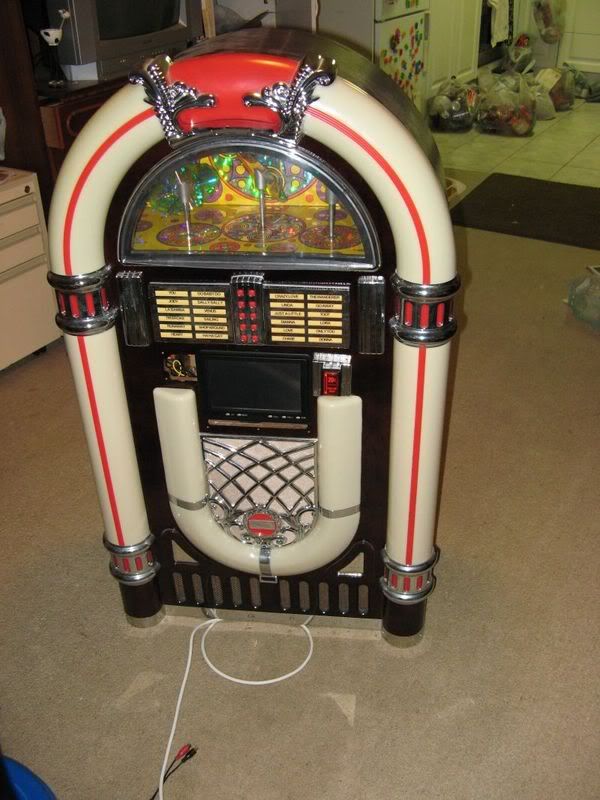

It booted up fine i went and downloaded the dw/wincab jukebox software and tried various skins
Sadly all the skins weren't very useable on a 7" touchscreen the buttons and text were just a tad small.
So i spent a whole day changing around the cdbox4up skin to work on the 7" touchscreen and came up with this
I have just now loaded it onto the jukebox and tested it out and it works great :)
Below are pics of where im up to right now as of this posting
Jukebox unplugged
Jukebox turned on
Jukebox turned on without flash
Credit Button
Touchscreen
Another view
CD Display Spinning
Turned off closeup
I dont know why the cam is showing it orange but its a blue and pink colour on the neon parts
Again it isn't the nicest install with most things being held up with L brackets and cable ties but it works and is strong nothing moves or will slip when the jukebox is moved or shaken so im happy with that.
I still have to workout where and how to mount the harddrive and also get another button for the otherside of the jukebox to turn the pc on and find something to fill the hole under the monitor then it will but all up and running :)
