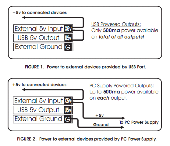

I was thinking about powering my usb hub from a 5v line of my power supply.  The hub requires 4 amps at 5 volts.  I couldn't think of any issues with this but I wanted to check to be sure.

If you are running two LED WIZ's as well as 5 other devices from one USB port (via the 7 port hub) you will more than likely exceed the 500 mA.
All you need to do is feed the LED Wiz'z 5v from your PSU and they will take power from that which will free up the USBs power for the other devices.
I'll be running 5 volts from the ps to the led-wizs but I still want to run 5 volts to the powered usb hub just to be safe and to make sure all the devices get the power they need.

To answer the other questions, if you have a passive hub (draws its power from the usb port) you do not get the full 500ma delivered to each port on the hub, you get slightly less and this is enough to stop some devices working (usb hdd, dsl modems, etc)
Providing additional power through an external power source to an inlet jack as is available on self powered hubs you provide the full 500ma to each port and do not suffer the same problems.
