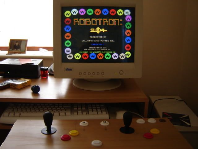

 Hi Friends,
                  As I am a newbie to all this...well kind of (I did construct some controls on a
 wooden box a while back). I have decided to pull the trigger & make my own cocktail cab
 blah blah...I know you have heard it all before.

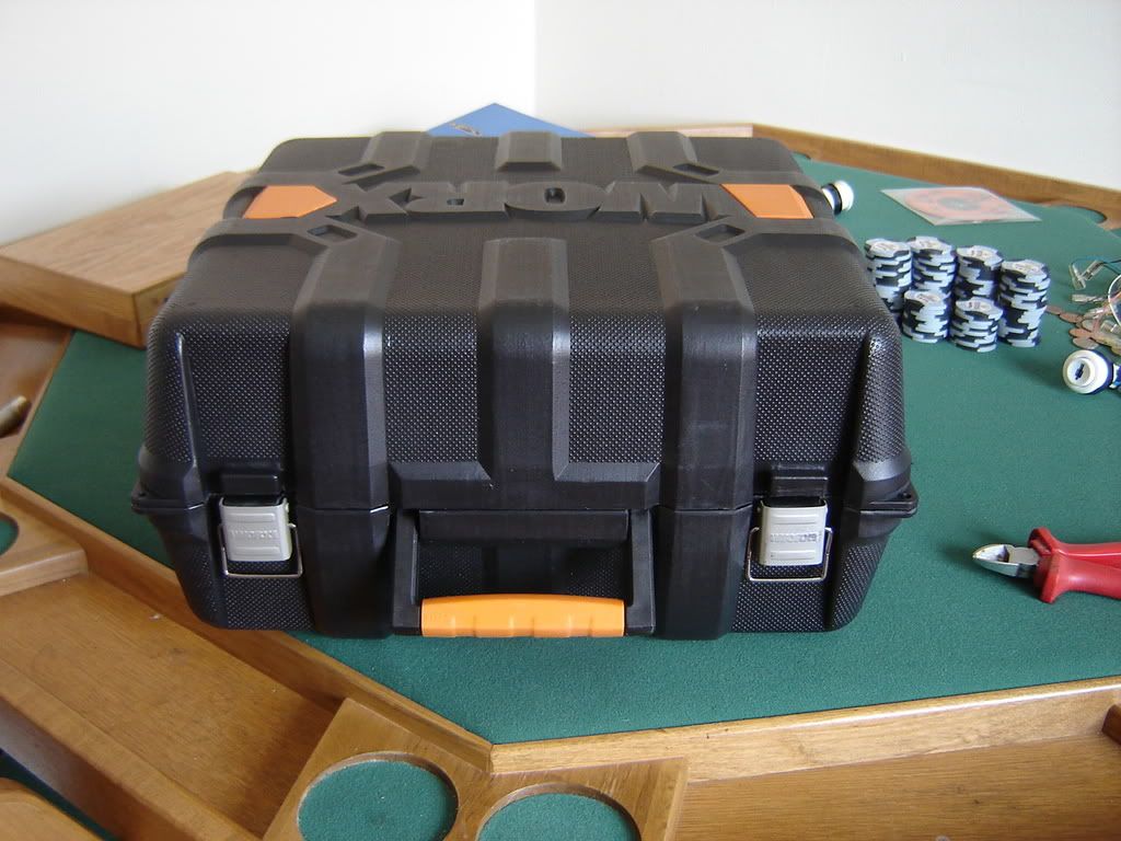

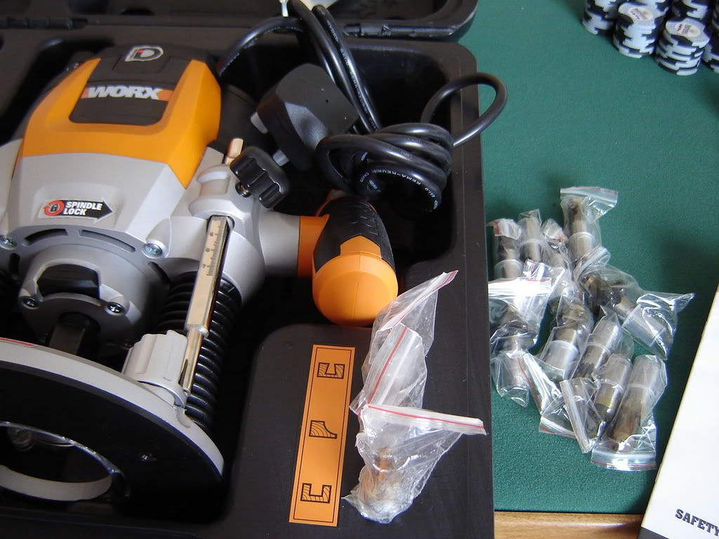

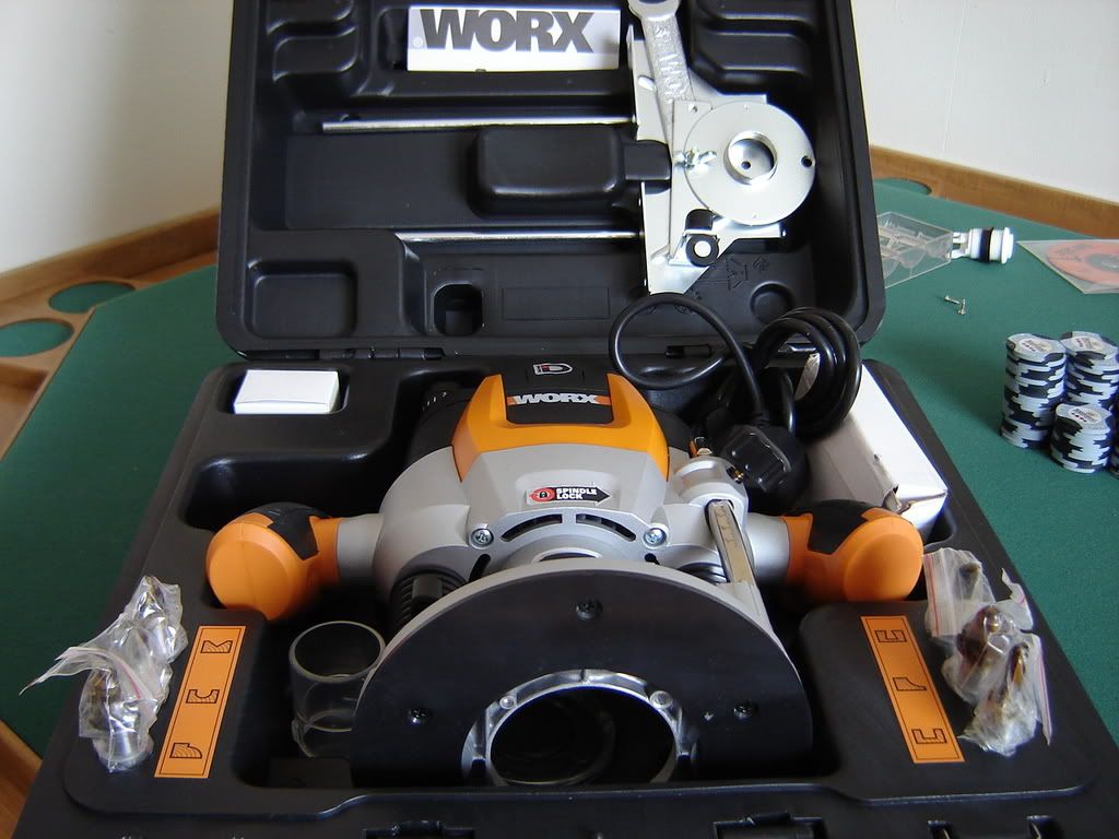

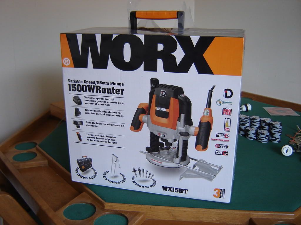

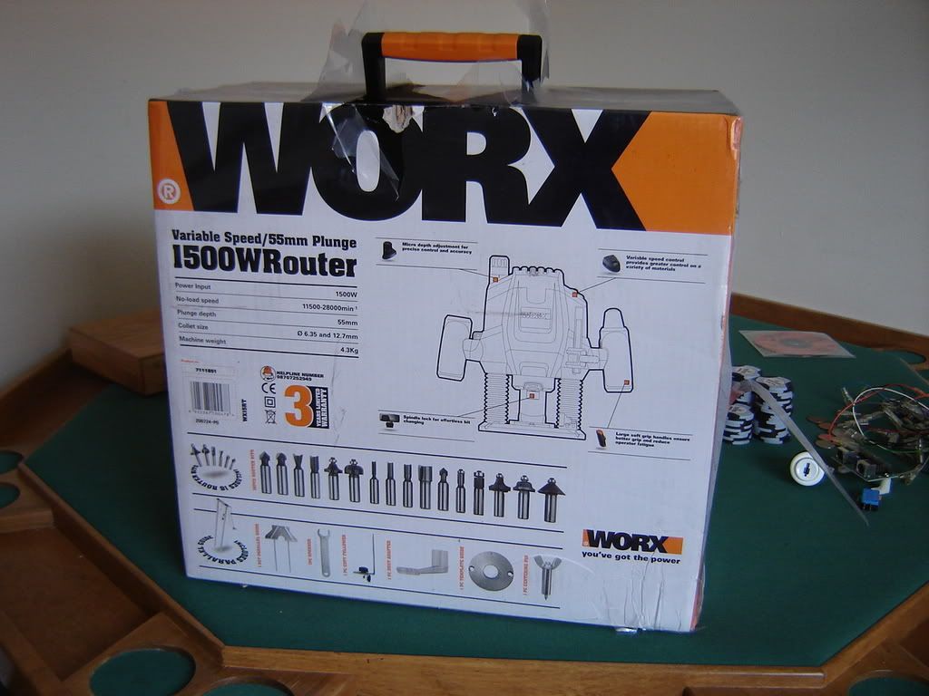

 So this morning I went out and bought this router:
 I'll be using it mainly for cutting T molding grooves so it should be
 perfect...it also came with 16 cutting bits :)
 I don't know much about these kind of power tools but it seems
 like hell have a lot of router for only £39.99
 Reduced price at Argos (for UK mamers)...
 I'm sure they have given me the wrong one cause the listed
 one is only 1100w & this one is 1500w
 Happy building folks.
Franco B
  • Posts: 3766
Re: New Router
« Reply #1 on: July 23, 2008, 06:24:58 am »
Looks like a bargain to me. Probably the best £40 you will ever spend.  :)
You will find many more uses for it than cutting t-moulding slots, they really are a versatile tool.

Does your router have a 10mm collet?  If so, you can use a bit with a 3/8" arbor/shank without an adapter.
Paulson
  • Posts: 106
  • Last login:January 29, 2015, 06:55:37 am
Re: New Router
« Reply #4 on: July 23, 2008, 03:26:36 pm »
 Just looking at the manual...I guess the collet is the same as chuck?
 (lol... I'm very new to this type of power tool) and it says:
 Collet size: 06.35mm & 12.7mm
                    08 & 12mm
 So I guess not?
Chadwick
  • Posts: 174
  • Last login:January 11, 2010, 03:23:34 pm
Re: New Router
« Reply #5 on: July 23, 2008, 04:37:30 pm »
Well you're in luck, 12.7mm is 1/2" and 6.35 is 1/4"
You can use any 1/2" or 1/4" shank/arbor router bit from the US with that 12.7mm or 6.35mm collet without any adapters.
I'd recommend using 1/2" shank router bits with the 12.7mm collet (chuck) on that router (1/4" is typically for laminate routers.)

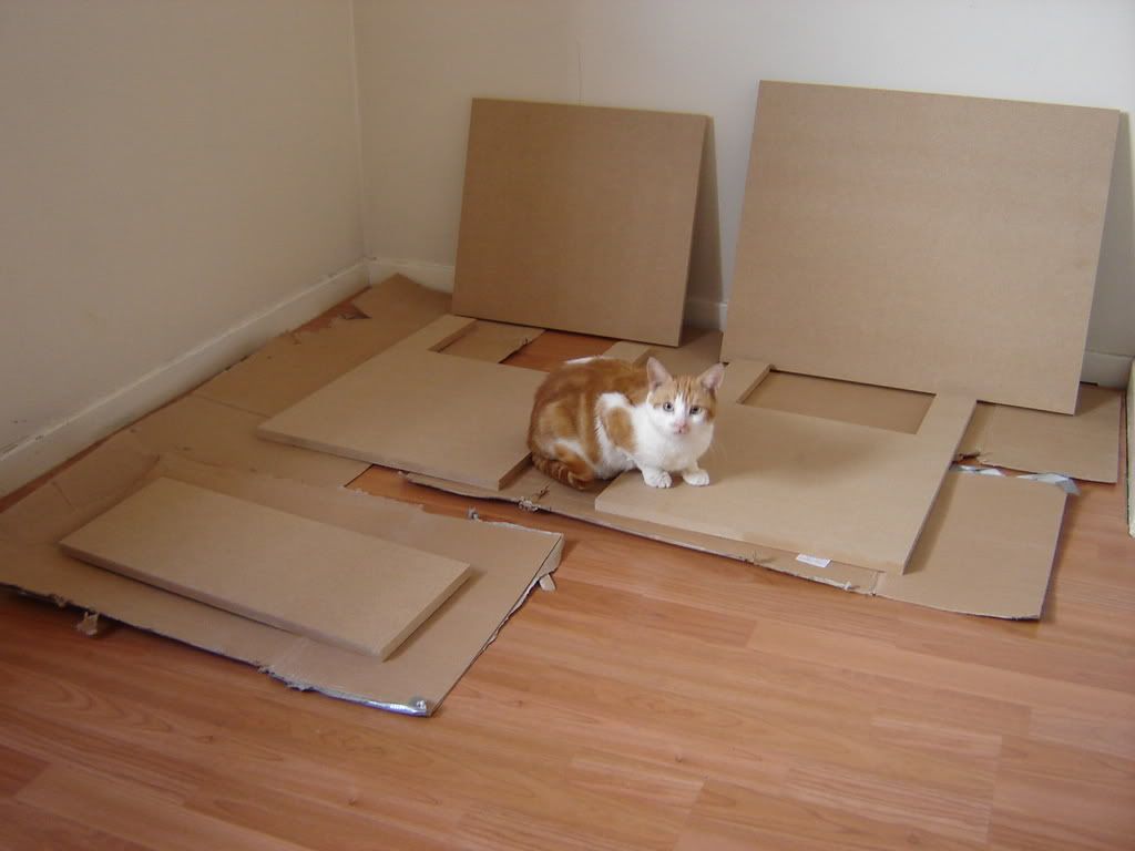

 Well I guess so...but I already have the sides already cut...I mean if I start putting
 it together I'll have to take it apart again.

The confusion is that you said you can't start on your cocktail cab, which indicates that you, well, haven't started on it yet.  Chad was basically asking you, why not cut out the sides and do other stuff while you wait.  Still, there's no time like the present for getting your control panels built and wired, and your coindoor cut and your monitor mounting taken care of . . .  (this is coming from the guy who's just now finally finishing his cab that he started building at least three years ago).
Yep... you appear to have done what I was thinking you could be doing.   ;D

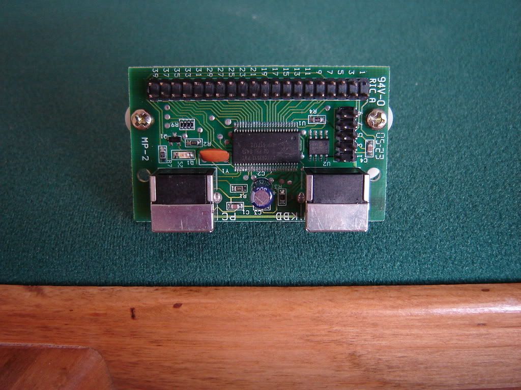

 I found another problem...I have a IPAC mini pictured below...
 & have realised that the wiring won't reach to both panels  ???
 Unless there is a way around this? I've only build a mockup panel
 before...

« Reply #22 on: August 01, 2008, 02:13:08 pm »
I'm guessing that the IPAC Mini uses a pre-made custom cable?  You can use pretty much any wire.  In fact, contact Andy from Ultimarc and I wouldn't be surprised if you can get a longer version of the cable it came with.  Otherwise, you can just cut the ends off that are supposed to connect to the joysticks and buttons.  Then just add more wire and crimp new ends on the wires or solder the wires directly to the terminals on the joysticks and buttons.
