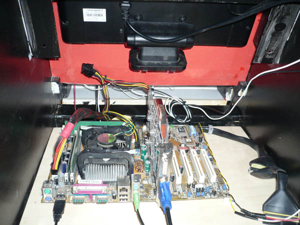

THE PC
Instead of using a case I mounted my PC components using motherboard risers on a slab of wood.  The specs are:
-Pentium 4 2.53 GHZ
-512MB PC1066 RDRAM
-80GB 7200 RPM HDD
-GeForce 6800 AGP (complete and total overkill, I know but this is the only spare card I have and it doesn't have much resale value anyway.  I wanted good D3D performance though for filters and non-mame 3d games).
-Wireless NIC
-400 Watt Antec PSU
-Onboard Audio (AC'97)
-WinXP service pack 3 (minimal services & applications running of course)
-Mala (as shell w/ custom theme)
-BootXP for custom boot screen
-MAME v.125
The Slab

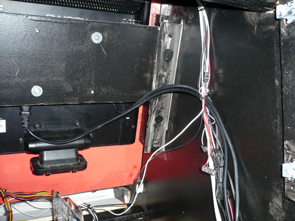

The Fully Mounted Machine (Plus 17" LCD) Running MAME.  The cables are a complete mess but they'll be nice and neat when the times comes.  I used a standard WinXP install but I disabled every unnecessary service and app that I didn't need so it runs pretty clean.  I will be using Mala as a shell.

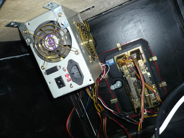

Next up - I a molex off of my power supply and wired in some disconnects...I also did the same on the coin door molex:
I had to mix and match the lamps between the two sets of coin doors, but I wired everything up and eventually found a set that work.  I may go back and get LED lights after I'm done to reduce the heat output.  But they work:
Now for the moment of truth, do the damn things work?  I temporary wired up my IPAC to the coin door to test:
Success! On the first try, no less:

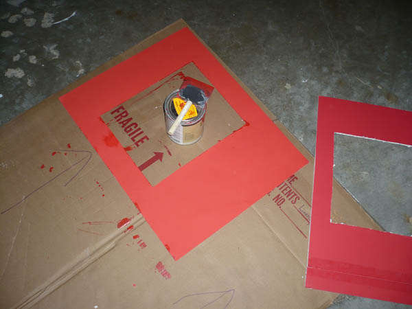

PAINT - ROUND 3
2 Coats of Primer All around (+ 1 coat inside).  Sanding in between with 320 grit
2 Coats of Black (+ 1 coat inside).  Sanding in between with 400 grit.
3 Coats of Red.  Sanding in between with 400 grit.
After all these coats I'm getting a nice smooth orange peel finish.  It's not 100% perfect but I don't think I'll be able to get it flat without a sprayer, which I'm not willing to do.  The paint is so thick in places that I had to sand panels down so they'd fit.
Back view after 1 coat of red, 1 coat black:
Back view after 3 coats red, 2 coats black (white spots are mostly dust from sanding):
Front view after 3 coats red, 2 coats black:
The blue on that last pic is just painters tape - I didn't want to smear black on the red portion when I was painting the trim.  The big white splotches you see everywhere is actually dust in the air from sanding, they aren't on the actual product.  The inside of the cab is a little on the ugly side, but once again I don't' really care.  I just wanted to get the wood sealed so it wouldn't disintegrate after moisture exposure.
So after some minor touch ups tmrw painting is done (finally  :cheers: :cheers: :cheers:).  After this I will begin fixing up the speaker panel and control panel and getting them attached.  The fun part starts soon!

After wiring buttons and everything to the control panel, I started work on the bezel and monitor glass.  I went to Michael's crafts and picked up two sheets - one of red Elmer's foamboard and one plain ol' piece of red posterboard.  The foamboard was very thick and sturdy and I thought for sure it would work:
After cutting it and trying to insert 2 things became clear:  1.) foamboard is damn near impossible to cut evenly and looks like crap after you cut it and b.) can't bend barely at all without breaking or cracking.  So after a test fit where the monitor cut was WAY off, I scrapped it and instead just used the plain posterboard.  It was a little flimsy but a little tape reinforcement on the back and support from the monitor glass would take care of that issue.
I did have to touch up some torn parts along the cut with red pain from the cab:

WIRING AND TEST
Last but not least i spent the night wiring everything up - smartstrip, computer parts, etc.  I used cable tie downs to keep things neat and keep the air flow going out the top exhust.  I mounted the power supply to the bottom of the motherboard slab - a little creative use of space that will allow for less cramping:
And here it is, playing some Capcom classics.  It looks, sounds, and plays just like an arcade machine.  I can't believe I didn't build one of these sooner, it's the greatest thing ever.  I'm starting to actually wish I had more to do on it because I'll be done soon.
