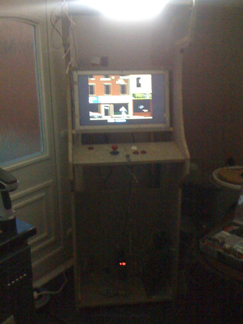

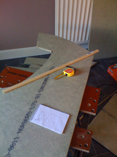

Well finally after a long crappy rainy winter I have started my first cab build. The aim of this was to have a functional jamma cabinet, originally for just one game but I may or may not put a multi jamma in it to run more boards in the same cab. As this is my first ever build please be gentle, I know it will not win any prizes for looks (My woodworking skills or should I say lack of are very, very bad!!!) I had no idea it was so hard to cut a straight line with a jigsaw, suffice to say I have invested in a circular saw for the rest of the panel cut's which is what I should have used in the first place but ofcourse I have now learned this lesson!!! Sorry for the lack of build pictures also, I was concentrating so much on cutting and joining that I forgot to take any pictures, and the one's I have taken are not that great as they were done on my phone (Can't find my digicam)

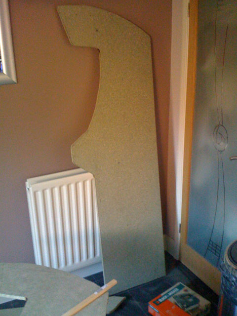

This is obviously the sides but they are deeper than I thought they would be, I could have made them much slimmer but im sticking with them
EDIT: I also took the probably bad choice of not routing a slot for the t-molding, a bad move but I have not yet borrowed a router.
They are slightly off in some of the cut's but I am hoping it's not too noticable once it's completed.

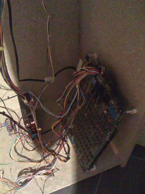

The 2 jamma boards I have at the moment
Now I know that control panel is squint and the joystick & buttons are not in a good place, this is just a temporary cp for me to test out, it was made from an offcut of wood which had both sides a bit wavy! The final cp will be for 2 players.
The light at the top is the marquee light just sitting on top for no other reason than just testing the wiring and the speaker is up there too, again just so I can test the audio

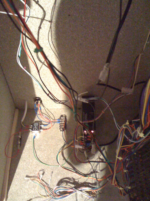

That was all done last week, tonight I wired it up properly using an emi filter, fuse holder/fuses, dpst switch, distribution block and the switcher so it all now work's like a proper cab in the sense that it's now 1 single throw of the switch to power up.
That's as far as I am going for the moment, I was just pleased that all my wiring worked first time with no problems. I feel that the cab is knowhere near the quality of some (most!) posted here as my woodworking skills are pretty non existant, some of the cab's here look like really pro efforts compared to mine, but hey at least I have given it a go, im confident I will get better as time goes on but as a complete rookie I think it's ok.

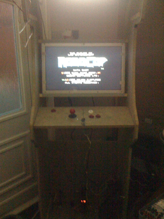

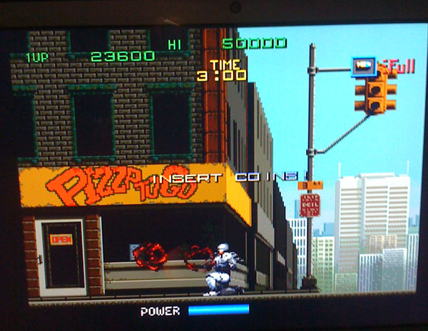

I like it -- can you talk a bit about the monitor and how you wired the video ?
Working: Not Enough
Projects: Too Many
Progress: None
TheDriver
  • Posts: 208
  • Last login:December 21, 2008, 04:08:37 pm
Re: Robocop/Jamma cab
« Reply #2 on: March 18, 2008, 04:36:52 pm »
That's the Pentranic I picked up way back in november, it's a proper gaming monitor which accepts the signal's without a problem
It's a d-sub connector on it but for the jamma board's I got an interface board with it
Regards.

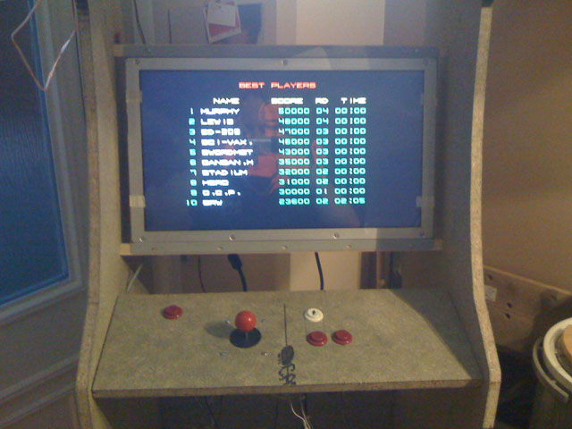

« Reply #20 on: August 19, 2008, 04:58:12 am »
Well well, no update in almost 4months!!!! and it really hasn't got that much further forward. I hadn't touched it since may, been buying plenty of
arcade related item's but last week I decided to mount the monitor again, the original mount's just didn't look good, functional yes, but looked sheeite!
so it was just to mount it really so as you can see there are a few squint lines, not worried cos there is a bezel to go in there still. Also the control panel has been replaced with an all new control panel and a plexi top, looks better imo & the button moves feel wore comfortable. The big thing for me was seeing it painted, really changed the look of the whole thing which is what made me put the tmolding on.
So it will probably sit there now till I do something with it, but when that will be is anybodys guess, too much going on atm.
Regards.
