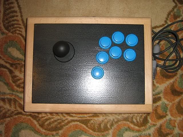

http://i59.photobucket.com/albums/g308/k-kowal/Custom%20Arcade%20Stick/seria%20III/Shinden-01.jpg
http://i59.photobucket.com/albums/g308/k-kowal/Custom%20Arcade%20Stick/seria%20III/Shinden-02.jpg
http://i59.photobucket.com/albums/g308/k-kowal/Custom%20Arcade%20Stick/seria%20III/Shinden-03.jpg
http://i59.photobucket.com/albums/g308/k-kowal/Custom%20Arcade%20Stick/seria%20III/Shinden-04.jpg
wood 4mm + metal panel 2mm I use washer from crap KC-04:P
originally you need metal panel with hole about diameter 45mm.
but I do not like how joystick gets up high.
I command second way from your drawing add only new big washer from iL Eurojostick or Compact joystick. You can alone make new washer from CD box.

I love your panel Kowal. That's more or less what I've planed for mine. I don't want to use artwork, but a textured surface like the one you used. What is it, paint or any kind of textured vinyl? I see you're using a replacement shaft. Unfortunatelly I have not access to that here in Europe. Anyway I don't like the idea of disassembling the stick so I think I'll use a hand-made washer cut in the half which I'll install glueing the two pieces one the stick is installed. If I'm carefull the result will be acceptable.

it is metal panel painted with "hammer-paint"
better take out stick before add washer
