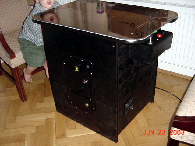

When painting, how do you avoid the final product looking like this:
(no offense to the dude who made it, as i'm sure it functions fine).
I'm using plywood, but it's finished on one side, so I anticipate that even if I were to paint it poorly, it wouldn't be as bad as in the pic.

Looks like he didn't use any primer to me.
That's the first step.
Same here. And also, depending on what wood is being used, a finishing carpenter friend of mine told me that there are different primers that you need to consider.
On the other hand, I like the look of that primer-less cocktail cab. I am one who likes woodgrain showing.

Yes, I agree.  Primer is the key.  Also, he may have used a water based paint.  Make sure it is NOT water based.  Also, the more coats the better in my opinion.

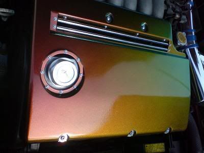

This is the third time, I think, that I have linked to this quote.  Somebody could call me a stalker....  ;)
This is basically what  I did:
1.  Sanded MDF with 600 grit to get it as smooth as possible
2.  Applied OIL-based primer - rolled on with a 4" foam roller (2 coats).  Sanding after the 2nd coat with 220 grit.
3.  Applied water-based pink paint - rolled on with a 4" foam roller (6 coats).  Sanding after the 2nd, 4th and 5th coats with 220 grit.
4.  Sprayed on 25 coats of lacquer straight from the can - no sanding.
5.  Wetsanded like crazy with 1500 grit - I spent 8 hours just on this step
6.  Applied rubbing compound with soft cotton rag (2 coats)
7.  Applied polish with soft cotton rag and buffer (2 coats)
HERE are a few good shots of the difference the rubbing compound/polish makes.
I did not have access to any spraying tools/materials, unfortunately.  The lacquer was easy to apply though - I did it all in one weekend since each coat dried in 20 minutes.  I couldn't get it perfect but the finish still looks 1,000,000 times better than leaving brushstrokes on there with ordinary paint, IMO.  It almost looks like it came from the factory or something.
Good luck with whatever you decide to do - I'd be happy to answer any questions if I can...   :cheers:
His paint job looks incredible.  Someone posted once after I quoted him again, that it seemed like too much work.  If you want a great paint job, follow his steps.  If it is too much work, then you may end up with less than stellar results.

Thanks, HooPZ ... I was just looking for exactly that post ... and there is no way I would ever go to those extremes (25 coats of lacquer!) , but if i did, i expect that the finish would be BEE-YOO-TI-FUL!
