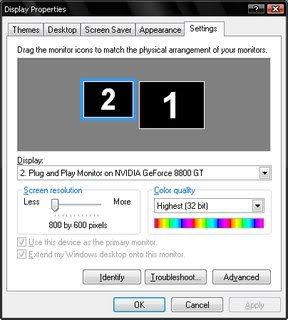

-To clarify what I was talking about earlier - this:
In the pictured configuration, Display "2" is set as Primary, and Display "1" is set as secondary.  This is great for Mame, which defaults to Display "1" and keeps the Mala layout from moving around when the games screen switches resolutions because Mala Layout starts at Primary display.  for other emulators and PC games which start in Primary this obviusly doesn't solve the problem but here are some instructions anyway for clarification.
First, a correction  It is not called span mode: with Nvidia's it is reffered to as dualview, I've forgotten the proper term for ATI's.  In both brands the Windows taskbar shows up only on one of the displays (I think it's Display "1") when you have the correct mode.
*note you may need to try this without any helper apps like Ultramon running at first.  Also just another warning;  this may not even help you out, I am still not completely sure what you are going to accomplish.
1.  Open Display Properties - you can do this by right clicking on the windows desktop and selecting "Properties"
2.  Click the "Settings" tab
3.  You have to see two monitors in this box to continue.  If you do not see two monitors in the settings screen then you have to rectify the situation to continue - let me know your video card(s) and I might be able to provide further info.
Anyways,  so there are these two (at least) boxes that represent the two monitors in this window.  One of them is labeled "1" and the other is labeled "2".If neither box is "grayed-out" then proceed to step 4.  If either box is "grayed-out" click on it and check the selection box Labeled "Extend my Windows desktop to this monitor."
4.  You may have noticed the very first words on the "Settings" tab.  Across the top of the child window it reads, "Drag the monitor icons to match the physical arrangement of your monitors."  TRY IT!  Click on the box labeled "2" and drag it to the left or on top of directly above the box labeled "1".  If all goes well it should snap into position and stay there.

NickG.  Can I ask where you found this setting in Mala layout?
"I turned off stretching in MALA Layout, and ensured that the MALA Layout top left corner started in the Display 1 even though the other display was set as Primary
for the games/emulators to work in fullscreen overlay mode."
On a positive note, I am making progress with just moving the monitors around and specify correct primary and secondary displays with the display properties configurations above.
Thanks, Shane

oops -  thats another error from my first post.  It had been a while since i had messed around with this and I was going from memory.I don't know of any setting that can get MALA to start in Display 1 instead of the Primary.    What I meant by "I turned off stretching in MALA Layout"  is that I use a fixed-size layout.  I had a problem with scalable layouts because my Mala layout spans across both screens.  If I use a scalable layout and the game screen resolution changes , then then Layout stretches or shrinks to fit.  Since I need the layout to stay still even when I am playing the game I use a fixed size layout.  In this situation the Mala layout stays the same size no matter what the games screen does.  The layout would still move around on the secondary screen if I were to change the resolution on the primary screen.  so that is why I configured it similarly to my previous post.  Now that I realized this only works for MAME , I have to go back to something like Ultramon or something
Ok, that is what I thought, but was not sure.  I have my layout fixed at 1024x768.  Well, I am able now to play the emulation games without the shifting over to the extended display.  What I had to do was set the primary display as display 2 (CRT 21") and the 15" Planar touchscreen display to display 1.  I then in display properties, moved the second display to the right of display 1.  Now, emulation does not shift to the extended display due to the extended display being on the left of display 1.  Wow, that is a mouth full.  Hopefully your falling me here.  Ok, so since I moved the extended display the left of the primary display in display properties, I can't get the jukebox application to load correctly on the extended display.  I am thinking this has something to do with the display properties (location of display monitors).  I have reverted back to Ultramon and am having a little luck with it.  You can't specify monitor 1 or monitor 2 anymore to run applications, but rather if I specify in the Window configuration box within Ultramon for the jukebox application to use the last used postion, the jukebox software loads on the primary display and then jumps to the extended display.  So I guss I have that partially working.  Almost there before I have to tackle the sound card switching with quicksoundswitch.  I am going to have to go back to my dos days and try to remember some of those commands that I know I will need to use.
Well, keep plugging away and eventually we both will get there.  Thanks,
