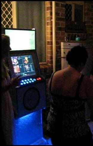

I have installed a 12" plasma plate into my jukebox i have just built, and as soon as its switched on , it starts affecting the IPAC running the buttons. The pages on SKJukebox keep flipping over and random numbers are typed in... stopping you from selecting a song.
As soon as the IPAC is unplugged , and the normal keyboard is plugged back in .. theres no problems.
Picture on left is the jukebox in use at a party , and the one on the right is during testing stage - without the buttons built in - just the keyboard.

The power lead did make some feedback through the speakers , but I just seperated that lead from the speaker lead and its all fine.
I have tried some aluminum foil wrapped around the ipac , but it didnt stop it .. maybe i should try a bit more .. make a decent shield.
I bought this plate from an importer here in Australia.

I think i found a solution
I tried running the program while having the plate turned on and outside the jukebox at a little distance away.
Had no problems.
Brought the plate closer, and found that it started to affect the ipac when it was only a inch or so away from the front of the jukebox.
So tomorrow ill move the ipac away from where its sitting now , and put it high up in the back of the jukebox.
This should fix it i hope.
