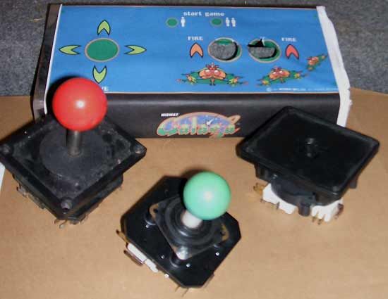

Okay, I'm recovering a Galaxian cocktail from a Trivia whiz conversion, designed my own new overlay and everything..
(that's just a paper prototype to check my layout.. only off a bit)
but there's no room under there for a standard wico/happ joystick!;
 in fact, I'm going to have to re-order some buttons because the ones I have are too tall.. agg!

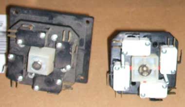

Fortunately, my purchases along with the cabinet included a box of varied controllers, and I studied the designs,
and with a few washers spacers and springs..I put together this: (the green one)
I know,the acutator thingy is upside down, just figured it out taking the pictures :)
So far in theory this will work, a bit stiff, but I can move it and it seems to trigger the switches decently..

It was already 'hurt'. I'm recovering it.  Some things are lost to the conversion, but a re-conversion back to a faux  jamma Galaxian is better than nothing..
that was the first game run through the system.  a bit different than the original, but original panels can always be put in place of my new panels.
Here's what I ended up doing on this: 2 rebuilt wico leafswitch joysticks, mounted directly to the metal plate,
with molded plastic overlays.. metal bending plates+heatgun+patience= custom molded panel covers that look like they're supposed to be there. :)
All designed so it goes back together exactly like the orignal panels, no modifications to the cabinet that weren't already there from the Trivia Whiz mod.
I have the white panels that are missing in the pictures.. this was just an initial 'testing install'.
Cabinet stays original, and the original panels are otherwise still original other than the button holes.
and the 4 small screw holes to mount the wicos to the panels. big mess o' technology, but it fits, and is playable.
just need a fresh set of centering grommets.
