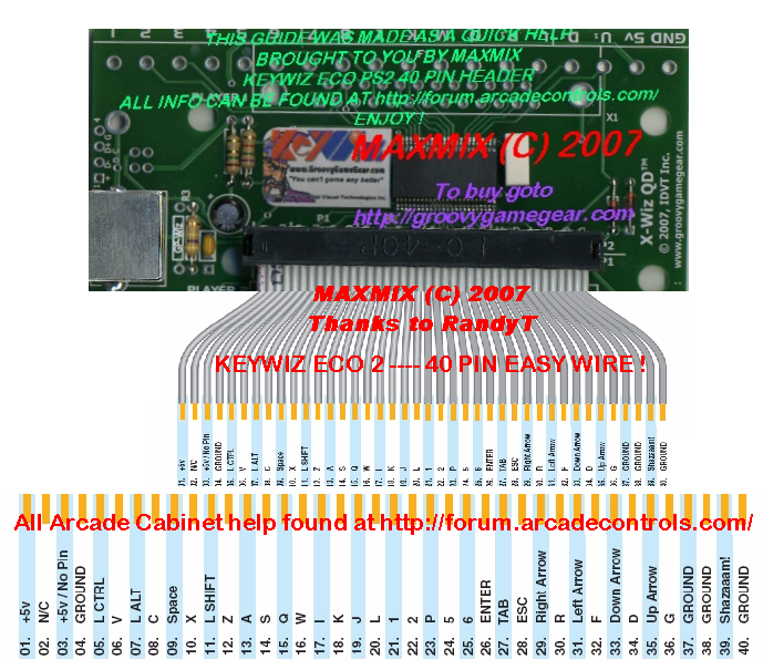

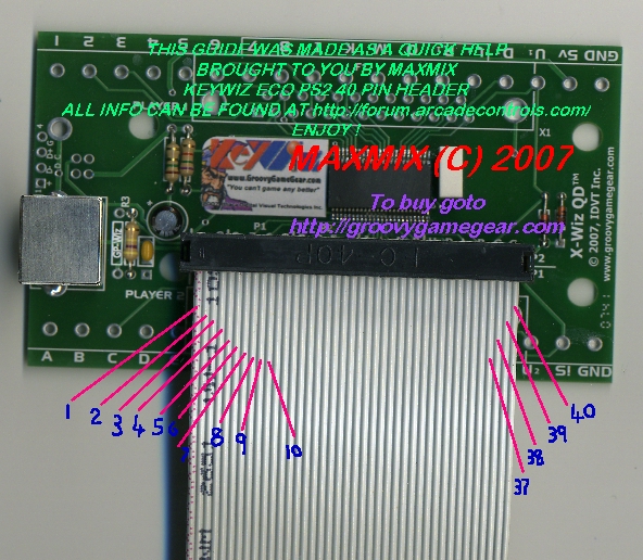

Hi Guys.... Going to finish this quick guide with updated pictures once one of you kind people help out !
You will get some credit also :)
Righty.... Can someone quickly run along from 1 to 40 (Left to Right etc) what the pinouts are....
I know they are also printed on the board, but I want to make this easier for me and everyone else....
Thanks
maxmix
PS I will update the photo with simple 1-40 pinouts once I get some help here....
We will get a nice and easy solder job with this diagram lol :)
maxmix

Here's a diagram sent to me by a user who was nice enough to allow for it to be distributed.  It should probably be on the site.
40 Pin Eco Cable Diagram
I believe it is accurate, but a double check never hurts.
RandyT

Randy. Your a star :)
I'll update photos etc with the diagram.... I am converting some X-Arcades ATM, so I am usuing the Eco's
Just wanted to make it all easy with pics lol
Will update my pics ASAP and repost....
If the diagram is wrong at any stage can someone let us know ASAP :)

Here we go.... Nice and easy to print out etc....
Enjoy
