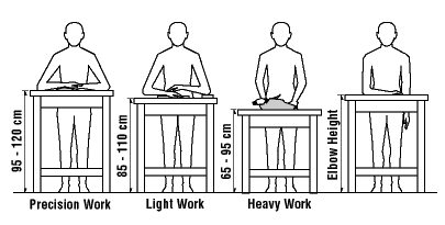

control panel height
I found this site: http://www.ccohs.ca/oshanswers/ergonomics/standing/standing_basic.html
The most interesting part is this:
Quote from: www.ccohs.ca
What is an example of a workstation designed for a standing worker?
Workplace design should fit the variety of workers' shapes and sizes and provide support for the completion of different tasks.
Different tasks require different work surface heights:
    * Precision work, such as writing or electronic assembly - 5 cm above elbow height; elbow support is needed.
    * Light work, such as assembly-line or mechanical jobs - about 5-10 cm below elbow height.
    * Heavy work, demanding downward forces - from 20-40 cm below elbow height.
I guess an control panel could be regarded as precision work?

Interesting point.
The height difference of some machines can be a lot. Take the difference between Defender and Donkey Kong.
I am designing a new cabinet and I marked the CP at 1m which feels comfortable.
torez
  • Posts: 276
  • Last login:December 20, 2009, 09:40:12 pm
Re: ergonomics collection for upright cabinets
« Reply #2 on: September 10, 2007, 09:25:28 pm »
Nah, precision work includes eyesight directed at the item on the table you are working on (be it some blueprint or some assembly).  Smacking some buttons does not involve much of looking, as you are concentrated on the monitor during the game.
Only if you're 4'11"
NO MORE!!
Green Giant
  • Posts: 1124
« Reply #4 on: September 11, 2007, 12:58:18 am »
I don't think people would like playing on my cab if the control panel was 48" high.

« Reply #5 on: September 11, 2007, 02:08:36 am »
Mine is 38" including the casters, and it feels great
good topic

Mine is about 40" with castors and I wish it were a few inches shorter.  But honestly after a few sessions it's all fine to me now.
It's probably about the height of the lower end of the light work graphic for me.
