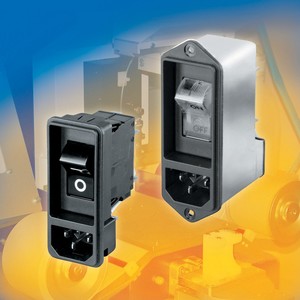

I set my PC's to boot up when the power is turned on. I use a power entry module like this one:
I flip this switch and it powers up everything. I use the front end to power off when I need to power off. There is plenty of room inside a full sized arcade to have coin mechs and a computer case.
superbigjay
  • Posts: 667
  • Last login:October 22, 2023, 02:50:03 pm
  • I'll always be a kid...
    • superbigjay website
Re: how do i mount a pc inside a cabinet?
« Reply #6 on: September 03, 2007, 10:55:48 am »
Lew, where did you get those switches?
