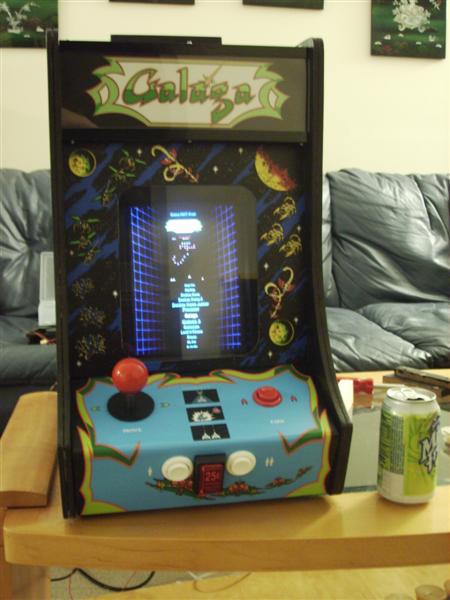

Test fitting everything together.
Man, was I glad when everything lined up ok.  :)
I need to drop the monitor shelf a bit. The monitor needs to be slid over a little. Minor stuff (famous last words).

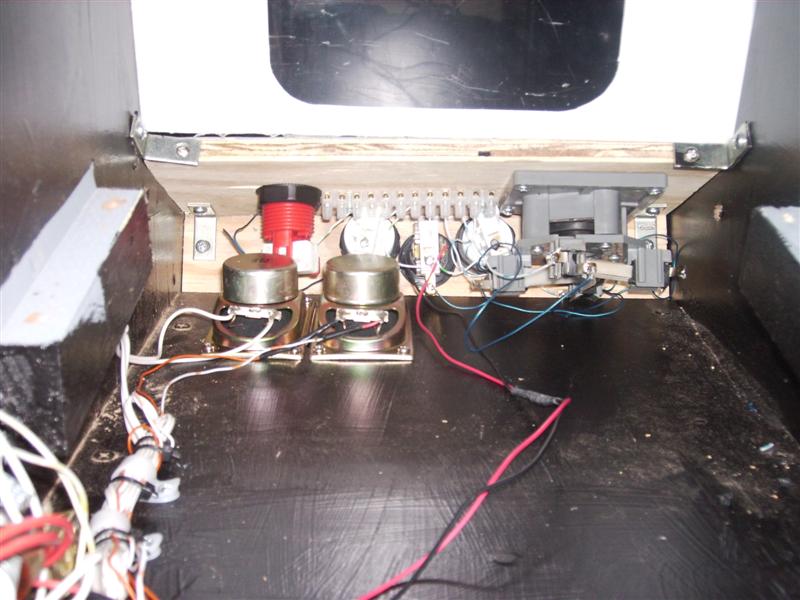

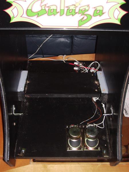

Insides eh? Hmm, this isn't going to be pretty - here goes:
Before the CP goes on, here is a shot where I mounted the speakers. I cut a hole through the base and put a 120mm case fan grill on the other side to keep anyone from poking their finger through the speaker.
CP on! The laptop is mounted to the side and bolted down to the side of the cabinet. I extended the power button to 2 wires which I will attach to the back door
Here is a shot from the back looking in - you can see that things fit.
I don't really like the way I mounted the CP on, but I couldn't think of a better way to do it really. There just isn't enough room.

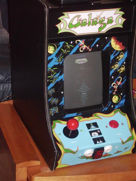

Here is a couple pre-finished test shots. I was confirming everything lined up and the screen was rotated the proper way.
Here it is next to a soda can for scale.
Finishing shots coming up soon - probably this weekend.

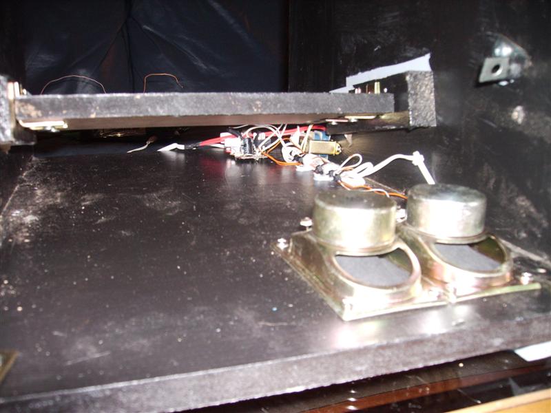

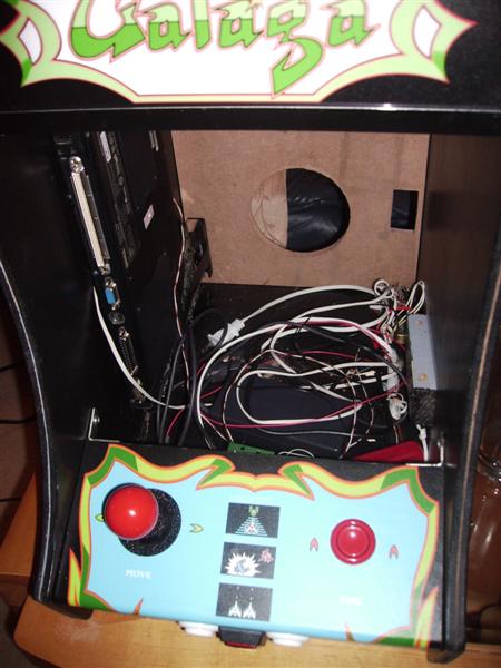

Here are the last of the interior shots. It ended up being a big PITA mounting everything inside because I didn't take into account the laptop was going to have a monitor, speaker plug and power plug in it. It didn't fit on the bottom of the cabinet, and I had to mount it along the side.
Prepping to put the monitor in by tying up all the wires:
Monitor mounted:
I used 4 large L brackets screwed into the CRT case to hold it down. While I know this isn't a great method, a 10" CRT is pretty lightweight and I don't think it'll move around too much.

One of the coolest bartops...EVER. Nice job LeapinLew.

That's just too cool. I'm so jealous :P  Adding the sideart and the t-molding does give it a more complete look yes.
Looks like all that wiring must have been quite a challenge.
I'm amazed that you did that in your home. I'm living in a temporary place waiting for my new house to be built with a garage. I can't wait to finally start building a cab myself. You actually did this without a seperate place to work on it. Amazing.

hey lew, just curious. Did you use an encoder or just do a keyboard hack on on that? Trying finding it in the thread but didn't see it. Awesome project!!

I would normally let the person you were asking the question to answer it, but I just wanted to interject real quick (for safety's sake).
Black is not ground!!!  (for AC)
If you have Black, White and Green, then Green is most likely the ground, and black and white are the 120V AC.  Always double check though.  Use your DVOM to check continuity between the green wire and one of the ground ports on the strip.
If your colors are not standard white, black, green (I just hacked a cable that was white, purple, white w/ green stripe!), then you'll have to check anyhow.
Disclaimer - I am not an electrician!!  But I did sleep at a Holiday Inn Express!
