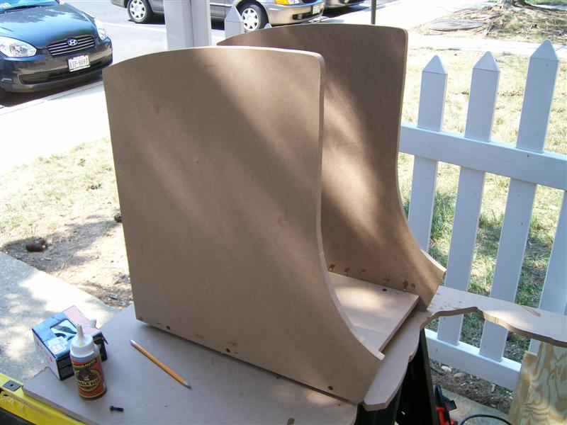

I said small because I didn't want to say mini. Projects like vrf's and psychotech are mini's. This is just small.
I want an arcade machine at the office that was small enough to sit on a corner of a desk, and also resemble an arcade. Here is what I came up with:
Based of a Galaga/Ms. Pacman design. (if you couldn't tell)

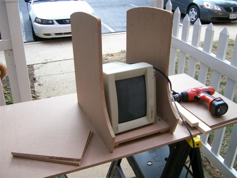

This is the monitor I'm going to use. It's a 10" CRT 9" viewable. I have 3 of these guys. I may build another machine and keep a monitor as a spare. These guys are hard to find. I have an old laptop that will be the guts and I have a wico 4 way that will be the controls.
Marquee top and T-molding slots routed. The router got away from me a little bit on the left side. Shouldn't be a problem getting the t-molding to fit still.

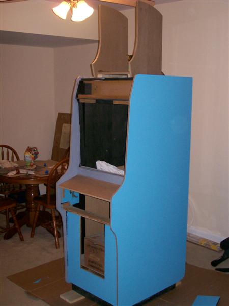

Here is a comparison shot of a donkey kong I'm rebuilding now.
The small bartop is made of 1/2" MDF. Not real fun to work with. Can't really put a screw in it without pre-drilling. It should work fine for this purpose, but it isn't real high on my list of quality material. The Donkey Kong is priority, but they'll probably both finish in the next couple weeks.
So far I think the bartop is looking good. It's proportions are right that I should be able to use scaled down artwork. I'm currently trying to figure out where to put the speakers and what kind of buttons to use for player 1 and player 2.
Dimensions are 11" wide x 20.5" tall x 19" deep.

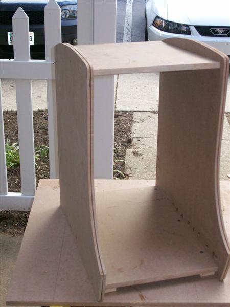

Small update for a small cabinet
I installed the lower marquee and monitor support.
Look at all those screw holes I have to cover up! Eesh. I wish I was going with laminate on it now. I already have the black paint for Donkey Kong though.
Looks like I could've shaved another inch off or so.
Lots left to do.

PPS. Are you using supports under the horizontal panels (ie. marquee top/bottom) or did you just go through the sides and into the MDF (?) panel sides?
I went through the sides of the MDF. I don't get that warm fuzzy feeling like I do when working with plywood. To compensate, I'm using the glue/screw method.
