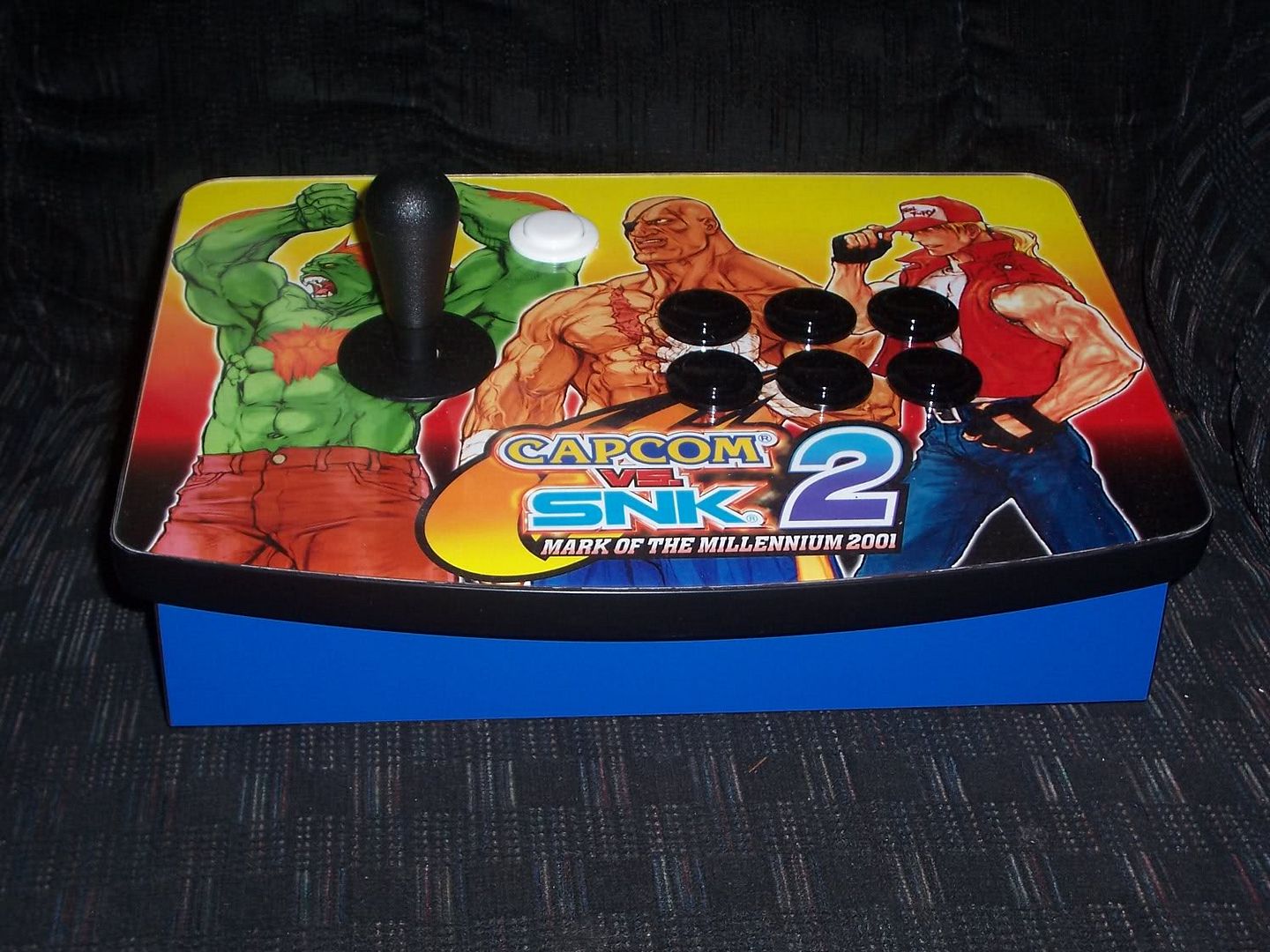

I've found the most universal and friendly layout is having the buttons 4" on center away from the joystick. Space between the buttons is 1 1/2".
Here's a drilling template for what I mean. Print with no scaling. For Happ buttons and sticks.
And here's how it turns out.
Nice universal layout that's comfortable and works well with a lot of games.
