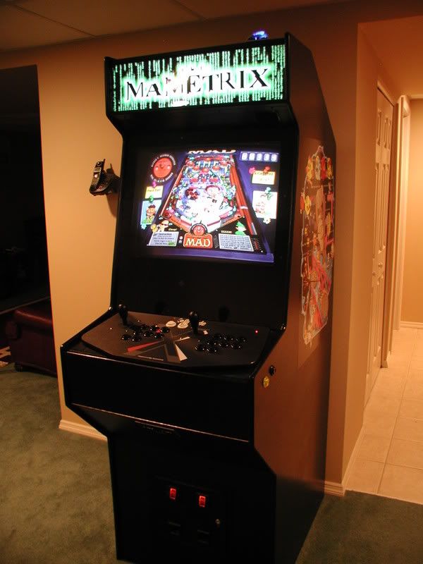

Alright, its been awhile since I posted in this thread, but my game is done.  I was lazy about posting, but I did take pictures along the way so I'll post some here.
All in all I'm reallyy happy with the game and the way it turned out.  Nearly everything turned out well, except for my work with the Lexan for the CPO and the TV bezel.  I will probably end up redoing that at some point, but it looks OK and is good enough for now.
Thanks to Andy from Ultimarc for the Magstick Plus switchable joys and the ipac and optipac.  Great products.
I'd like to thank RandyT from GGG for his help (I broke the connector on my LEDwiz when my son kicked over the CP while I was working on it - Randy fixed it for free!) and his great products.  The NovaGems and the LEDwiz work great, and I love the TT2 spinner.
I'd also like to thank Scott from Mamemarquees.com.  I posted about this in the hardware review thread, but he was pretty patient with me and did a really nice job on the marquee, sideart and CPO.
On to the pictures and some discussion!

When I left off I was having a bunch of trouble getting the 1 button power on and off working, but I finally figured it out.  Just suffice to say that Dell computers can be a pain in the ass sometimes.
My wife's uncle finally came over to help with the cabinet portion of the project.  Unfortunately he wasnt able to help as much as I had hoped, but this actually turned out to be a blessing in disguise.  It forced me to do most of the work and to learn about woodworking (and make many mistakes), so that was a benefit.  He also let me borrow most of his tools, so I am grateful for that.
After following the LuSiD cutting plans, I set out to start assembling this thing.  I didnt feel comfortable enough in my skills to just have the TV sitting on a shelf with no support underneath.  Because of that, I built a shelf and support for the TV.  I'm sure I overengineered it, but I feel fine with it and I dont think it added to the overall weight too much.  The shelf was angled back somewhat (about the same as the side angles of the cabinet).  Here's a picture of what it ended up looking like:
The other benefit to building the support was that it made assembling the sides of the cabinet a little easier since I did most of it myself.  I just stood the side panel cutouts next to the support and held them in place with pipe clamps and the sawhorses.  Again I'm sure that I overdrilled the cabinet sides, but I wanted it to be secure.  Here's a picture of the cabinet with the sides attached (all the light spots are the hundreds of woodfiller-filled screw holes):
I also got the speakers mounted in the speaker shelf and the marquee light put up.  I had trouble finding speaker grills for 3" speakers, so I ended up cutting the speaker holes with a hole saw and routing a slot around the holes.  I put some 120mm fan grilles that I found on frozencpu.com on top of the holes and the the speakers on top of them.  I then planned on putting t-moulding in the slot so that it didnt look too bad.  I used some old Harmon Kardon computer speakers and pulled the PCB out.  The PCB is now mounted on the right side of the marquee where the shelf is routed out a bit.  I drilled a hole and dropped the volume knob through so that I can adjust the volume very easily.  Here's a pic:
I had wanted to have a cabinet door on the front so I could access the computer easily, but was worried about the weight of the door.  At the suggestion of someone in the woodworking forum and my uncle, I ended up cutting the door in half so that there were two doors.  This is probably the part of the cabinet I had the most difficulty with.  I spent a lot of time getting the doors lined up, and then when I finally mounted them, realized that I didnt build out the side that they were mounted to enough, so they wouldnt open without hitting the sides of the cabinet.  I finally got it reengineered and it looks OK, but there are still some noticeable gaps around all sides of the doors.  I decided I could live with it and when the cabinet was all painted, if it looked really bad, I would redo it.
The only really dumb thing I did during the whole construction process came while I was building the CP box.  I couldnt for the life of me figure out how people were getting rounded outside corners on their boxes.  I thought about it for a bit and decided that I would use quarter round moulding on the corners.  They didnt line up perfectly on all the corners, so I spent some time with the sander trying to get the edges flush.  It didnt occur to me until later that I could build the box square and then use a router to round the corners over.   :banghead:  By that point, I didnt want to redo it, but I'll know better next time.
Once I got the cabinet done, I started on the control panel.  I ordered a CPO template from mamemarquees.com when I got all my artwork and taped it down to the CP to drill the button holes and screw holes.  I debated top mounting or bottom mounting the joysticks and ended up topmounting them.  I'm not sure that was the best way to go, but there were pros and cons on either side.  I ended up topmounting mainly because I didnt want any carriage bolt holes in the CP top, but I also lose easy access to the joys unless I take the whole CP apart.   Anyway, here's what the CP looks like before I bondo'ed in the trackball mounting plate:
I ended up putting cardboard cutouts on top of the joysticks so that the CPO would lay flat and not sink into the holes.  A little woodfiller in the edges and some sanding and it turned out pretty flat and would not be that difficult to get to if I needed to adjust the joysticks.   I went a little overboard with the bondo the first time, and spent a bunch of time sanding it down flat with the CPO.  I also cut the Lexan CP cover at the same time.  I had some trouble making the Lexan cuts right, so it wasnt cut perfectly, but its mostly in places that only I will notice.
Once I got that done, it was time for the paint.   I put 3 coats of grey primer on, followed by 3 coats of black semigloss with just a little sanding in between.  It ended up pretty nice looking and I'm happy with the way it turned out.  After the paint, I got the t-moulding in and moved it to the basement where the other games are.
The CPO that I used was actually the background of the marquee that I chose (one of mamemarquees stock ones).  There is a bright star on it that I wanted the trackball cutout to replace so that it looked like the starburst was coming from the trackball.  Because of this and the button labels that I had printed on the CPO, I was worried about getting everything to line up with the lexan and the CP, so I didnt remove the adhesive backing at first.  Instead I just clamped down the lexan on top of the CP with the CPO in the middle.  I used an exacto knife to cut all the holes out, and it worked fairly well (except for one big scratch I put in the lexan with the knife when cutting the trackball hole).  Once I got everything cut, I was still worried about getting it all lined up, so I decided to leave the adhesive backing on and just use the buttons to hold everything in place.
I got the Novagem buttons in and wired up, along with the joysticks and trackball/spinner to the optipac, iPac and LEDwiz's that I had.  As I was wiring the Novagems, my 3 year old walked by and accidentally knocked the CP off the table, causing the USB connector on the LEDwiz to break.  RandyT was awesome and repaired it for free.  Unfortunately it set me back a couple of days waiting for it to get shipped out and back.  Once I got it back, I was in business.  I also was able to get the LEDwiz plugin mostly configured so that the buttons light up for use in specific games, which add a cool factor when showing it off, but also help people who are familiar with the game know which controls to use.
I had some problems with the lexan lifting off the edges of the CPO.  I debated using carriage bolts to hold the edges down, but I instead used just some silver screws that I had and countersunk them into the lexan.  That's the one thing that I dont really like about the game.  I'll probably try to throw some paint on them to make them not so noticeable or swap them out with short drywall screws, but I havent gotten around to that yet.
I moved the computer and TV into the cabinet and hooked everything.  I got the marquee mounted and the sideart attached.  I made a bezel out of black foamboard that I got from Staples and covered that with a sheet of lexan.  I may end up painting the TV case black in the future since you can see the edges (the TV is grey/silver), but its not something that I will lose sleep over.
 There are a few things that bug me, but nothing so much that I dont consider myself effectively done at this point.  I'm still toying around with some software stuff, but the game is assembled and functional.  All in all, I'm pretty happy with it.   Here are some final shots.
Finished game:
Control panel:
Control panel buttons lit (note that the top admin buttons are actually red, not orange - the pics dont do justice):
Marquee (not a great picture, but hard to get the lighting right):
Sideart (same on both sides of cabinet):
Finished cabinet doors:
All my babies (Star Wars pinball, Galaga/Ms PacMan Reunion cabaret and my new creation):
That's about it, sorry for the length and lack of updates. If you have questions, shoot.  Otherwise, I'll be playing my game.

« Reply #17 on: April 23, 2007, 02:04:56 am »
The lexan was originally held down with just the buttons, but started lifting along the bottom and side edges.  I countersunk and put #8 woodscrews in to hold it down.  There's 2 on each side and two on the bottom (basically at every angle cut on the CP).  It was very easy to cut, drill and rout (I used a roundover bit on the trackball hole since I didnt have a chamfer bit, but it worked out the same).  It does scratch very easily.  I was cutting my CPO and the exacto knife slipped, and left a pretty large scratch right above the trackball.  It bugs me a fair amount, but not enough to cut a new CPO right now.
As for the foamboard, I put a few pieces of scrap wood on the inside of the cabinet to mount the lexan to.  There are two on each side near the top, as well as one right in the middle on the top.  I countersunk and put 1" black drywall screws through the lexan and the foamboard.  Also, I did the same on either side at the bottom where the lexan meets the TV shelf.  5 screws is plenty to hold the lexan and the foamboard in place, and the black foamboard hides the black drywall screws fairly well.
