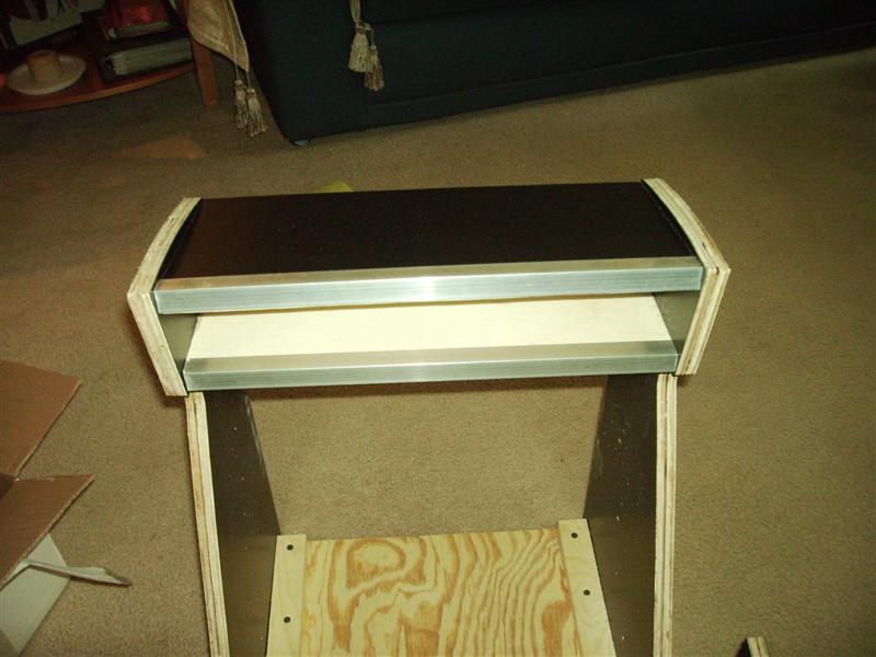

Some assembly shots after applying the formica -

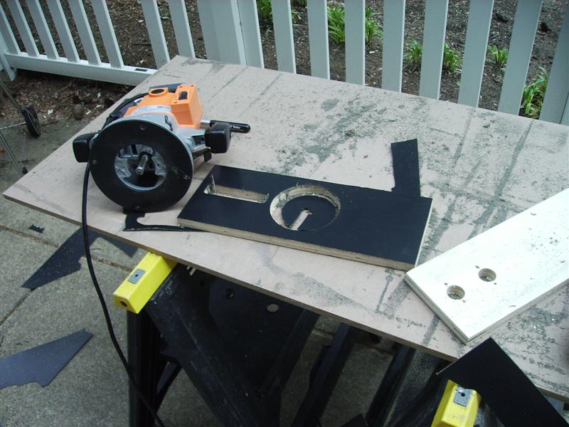

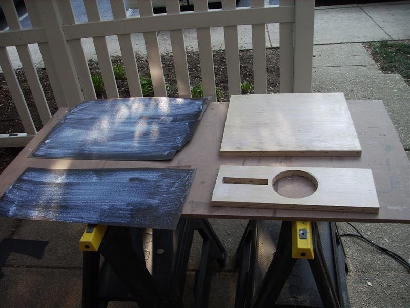

I had an issue with the formica and had to remove it, remove the glue and try it again. What a job! I used some bix stripper to soften it up and lots of elbow grease to with some old towels and eventually got it up.
Here is how it looked with all the glue on it still. It didn't look like the formica would sit level on all those glue chunks. I put some masking tape on the edges before I applied the stripper because I didn't want to get any on the other side somehow and cause the formica to unattach. I'm not sure if it was a necessary step but it only took me a few seconds to apply (took me longer to find the tape).
And heres the bondo repair. I sanded this down and reapplied formica.

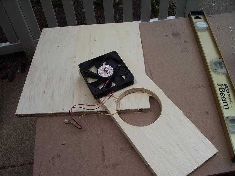

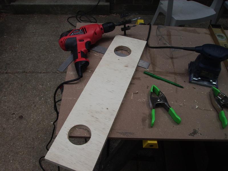

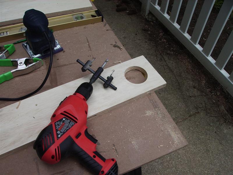

I purchased a hole cutter bit for my drill from ebay. I've never used one of these before - but they actually work pretty good. I cut a practice hole:
I did some measuring and cut my holes:
Next I readjusted the hole cutting bit to 120mm (it's max size) and cut a hole for the fan:

Yes! The last pieces that need formica:
The hole is for the fan, and the square is for USB. I'll be installing a power entry module in this section as well.
All trimmed up:

About the circle cutter, I didn't think they could be used safely with a hand drill. Any hiccups there? The holes you drilled looked great.
What was you issue with the laminate? I'm wondering because I'm about to switch to water based. I do know it requires strict temperature and humidity ratings. It also takes longer to dry than solvent based.

I've got one of those hole cutters; haven't used it since, what, day before yesterday.  It works really well in a drill press.  By hand, it moves around a bunch, and can really mess up your wrist if/when it snags.

I thought that too but the one lew used looks like it has a counter weight so it won't wobble as much. I thought about getting one but my circle cutters for my router have been doing great. :dunno

Heading towards the finish line now... into the details.
Here you can see the back of the cabinet. The hole over to the right is where the USB plugs are going. Also, underneath you can see the 2.5" rubber feet. They work very well and I'm glad I ordered them off the ebay link that nitewalker sent me.
The latch that holds down the CP is external. When I planned out this bartop, I wasn't sure how I was going to access the clamps. Initially, I thought I might be able to put them inside, but after the computer and monitor go inside there won't be much room to get to the latch. The solution was to mount them outside.
Hinged CP:
Here is the kickplate:
I'm ready to install the CPO and controls.
