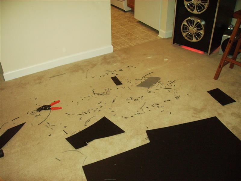

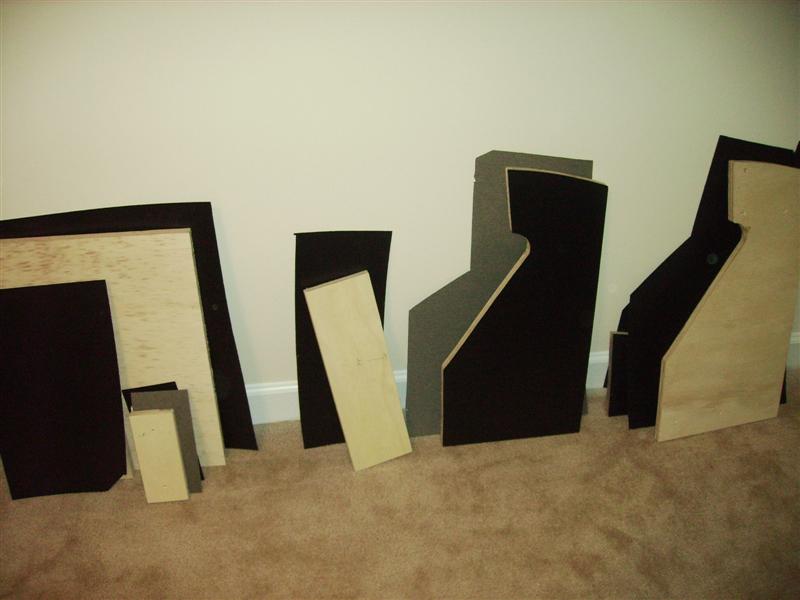

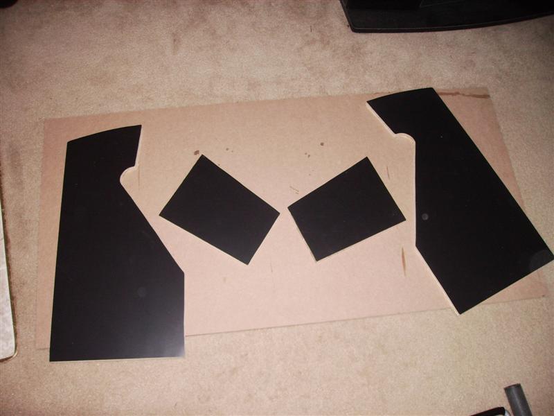

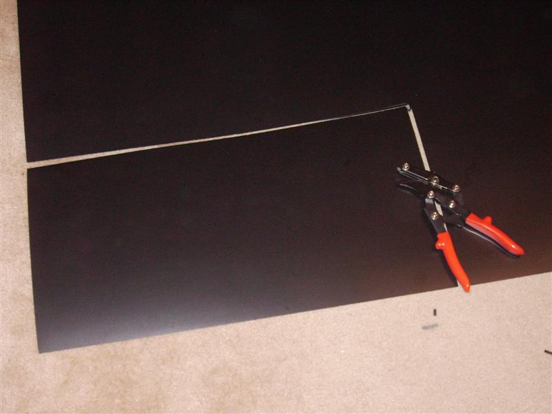

This worked out good.... I decided to use black formica. I have no idea how it'll get here, it's a 4x8 sheet. I imagine it'll be rolled up or something. This should take up any overlap - now I just have to learn how to apply it.  :)

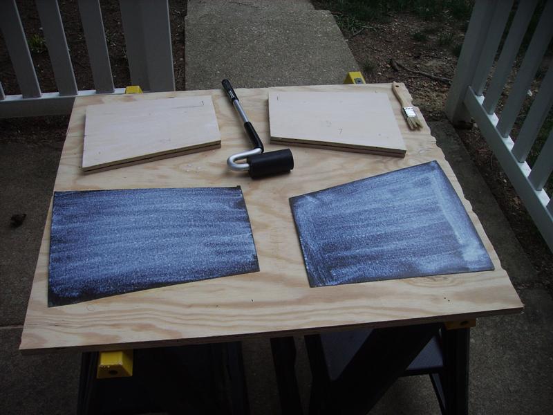

Once I mount the monitor I'll be ready to apply the formica. I bought a J-roller, some water based adhesive and formica snips to cut it down to size. All together it was near $60.  :o Hopefully it's worth it.

Had a bit of time to do some work today. First thing on the list is laminate. I did a bit of reading online to find out what all was involved with this process. It's not too bad. I bought the water based laminate as suggested by Knievel.
The first thing I had to do was cut the laminate using the special laminate cutting tool.
The chunk you see thats missing is actually how big of a chunk the laminate cutter takes out of the laminate. I see now, why you can't use scissors. The laminate would just crack. I used this tool to get the laminate to a more manageable size.
Next I lined up the pieces.
Then the waiting game. It goes on white, and it turns clear once it's ready to be applied. Put an even coat on between the 2 products, I put 2 coats on the wood because it's so porous.
The tool is called a J-roller and I would suggest saving the money and using a rolling pin.

I am very happy with the results and wish I started using laminate sooner. These are the inside pieces that needed the laminate. I cut all the other pieces and they are ready to go
Look at the mess this stuff makes!
