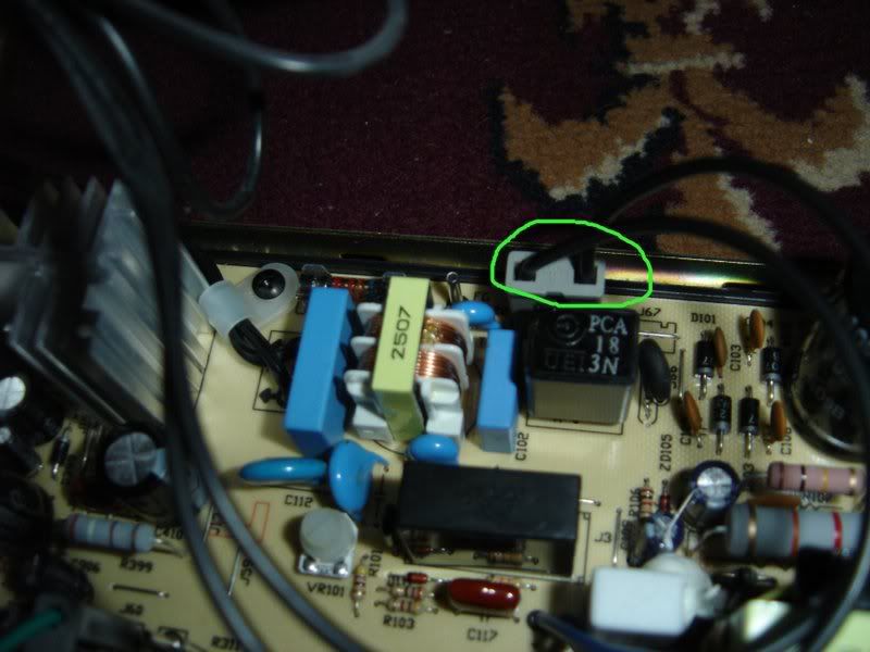

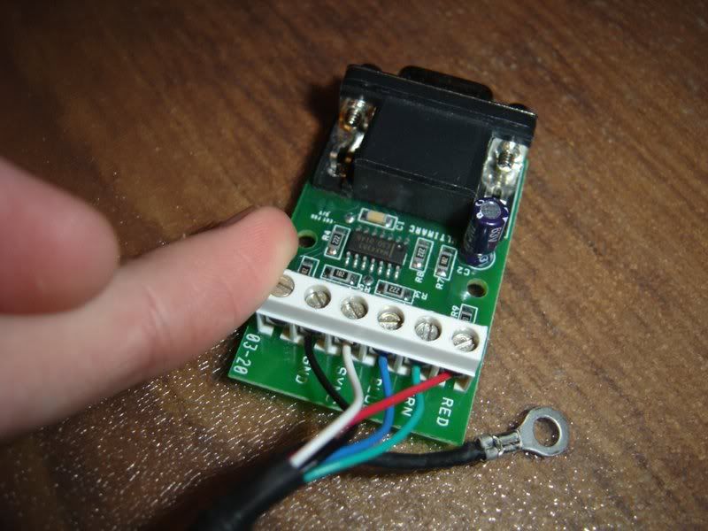

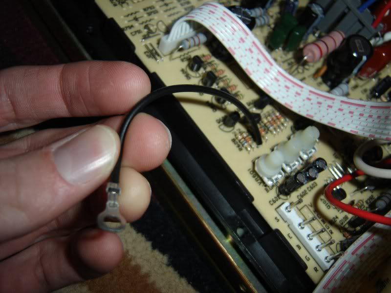

I just got my new weiya chassis in for my monitor. I got to the 2628h model.  I connected everything and just tried it out...The color is good, however the sync is completely crazy. Im using a video amplifier going from my arcade vga to my monitor. I have used numerous monitors with my setup, so I dont think its anything to do with the computer ect. The monitor keeps scrolling vertically and I cant get it to stabilize. I have got it pluged up for com sync not seperate h and v. Im not quite sure whats going on. When I entered windows with the rolling screen the monitor shut off, then starting making a pulsing white spot in the middle of the crt and it was shutting on and off. Any ideas whats going on and how I can fix it? Thanks,

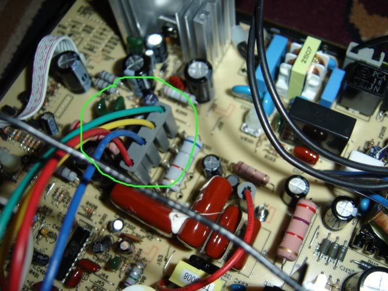

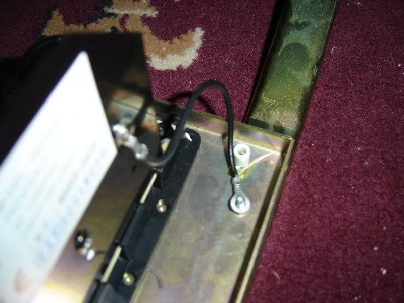

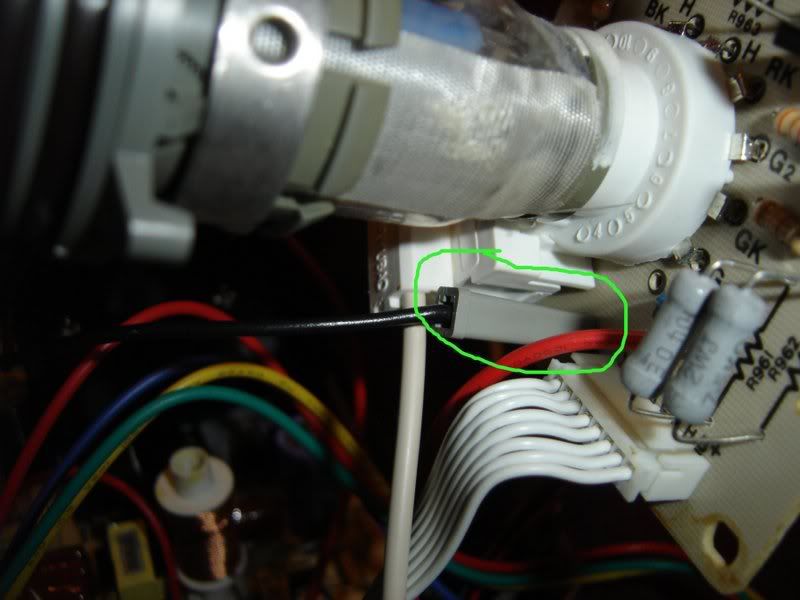

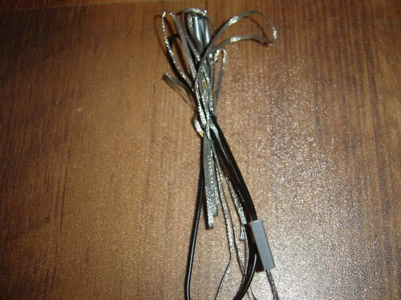

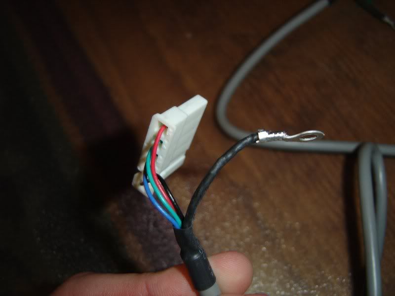

Here are the pictures of all my connections. Take a look and see if you see anything wrong. One question I have is the empty pole on the board next to the degauss poles. Any idea what is suppose to go there? I ignored it because I had seen empty poles on other boards I had....

The empty post next to the degauss connector appears to be a frame ground pin for a ground wire.
All your connections look ok.
Have you checked the chassis for shipping damage like cracks in the foil?
Some monitor chassis will go into shutdown mode if the horizontal hold control is way out of adjustment

Hmm. No noticable shipping damage..As for the ground pin next to the degauss...Is this a ground wire for the monitor?
Also about the h  hold...Theres one pot on the remote, is there another on the board I should be aware of? Thanks for the info Ken, and please excuse me for my newbieness at this.

Yes that's the ground strap that wraps around the tube itself then plugs into the board.

Ken,
As you can see in the picture w/ the tube and neck board....I have that ground strap connected right near the tube. Is that the correct place for the ground strap?  Also about my 1.1 ohms reading for my horizontal....I remember you saying that most chassis are for 1.5 ohm h. Could the low H ohms be the cause of my problem? I know that with gen shinn chassis, the 8 liners guy says to add a resistor to boost the ohms if it is less than 1.5. I know its not a jen shinn but maybe the same rule exist for the weiya?

3.) Do I have the ground strap connected to the proper place in the bottom picture? Or do I need to move it next to the empty pin next to the  degauss post?

I have one of those boards... it looks like your wires to the neck are wrong.  I had to cut the 4 wire connector and spin each pair around.  My monitor was scanning backwards (from bottom right to top left).
The Wei Ya chassis dont work 1:1 with the wells monitor configuration... but they will.

Im a bit confused about your comment....Your saying that the connector from the yoke to the board is not correct?  If you could please describe a bit more in detail on what needed to be done to fix this.

The 4 wire connector Green,Yellow,Red, Blue.  It is keyed so it can only go on one way.  To make mine work correctly, I had to cut the connector in the middle and separate the yellow/green from the red/blue pair.  the red/blue pair connected the same... but I had to spin around the green/yellow pair.  Sorry I dont have a picture... i sold the monitor in a game.
