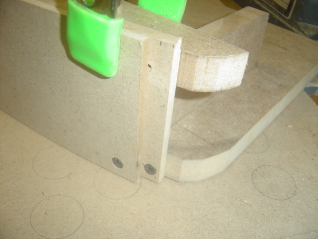

My Plexiglass for the top of the control panel showed up today. I really wanted to get it cut because the artwork should be done in a few days.
After much thought I ended up using the spacer that comes with the 3" Happ trackball. It is excactly the right size to use a a template for cutting the trackball hole. I spaced it about 1/4" off of a piece of scrap MDF because of the gap between the bearing and the cutter.
I then flipped the scrap piece and routered out the hole. It worked perfectly. So I left it assembled and clamped the Plexi to and did it again.
I am still amazed at how easy this was. Here is a shot around the trackball after I ran the 45 degree bit around it.
I finished cutting the rest of the holes and trimmed the outside edges of the panel.
By the way, those green clamps are on sale at Home Depot right now for only .99 cents :applaud:.

Well, I took a week or so off from working on the cabinet. Last night I mounted the base that goes under the CP to the cabinet. Whoa! It looked horrible. It didn't match the cabinet like I thought it would. I don’t know how to explain it other than it just looked out of place. Since I am wrapping it with laminate, I could not round the edges. This made it seem to stick out like a sore thumb. It needed to be more subtle.
So I took it apart and started over. I thought it would look a little more streamlined if I rounded the front edges as well as shrink it all the way around.
To make the curve for the front, I took two ¼” pieces of MDF and clamped/screwed/glued them to a jig that follows the shape of the front edge of the actual CP.
I made the front piece smaller for the corner piece I made (see further below)
Making the base smaller created a few unwanted obstacles. The leaf switches or the left 8-way joy and the dedicated 4-way ended up right against the wall of the base. I routed out a few notches so they clear.
Waiting for the corner piece.
I took a piece of scrap PVC pipe I had laying around and used it for the corner to ensure I had a perfectly rounded corner.
After threading the PVC, I used machine screws from the inside out to securely mount the PVC. I then cleaned it up with Bondo. I plan on hinging the CP for friends and family to see inside, so it needs to be nice.
Both sides done!
After some primer.
DOH!
I forgot to consider the hinge. I had to make an adapter piece to square up the front edge. This is where I stopped. Tomorrow I will do some touch up primering, attach the top and see how it looks on the cabinet.
