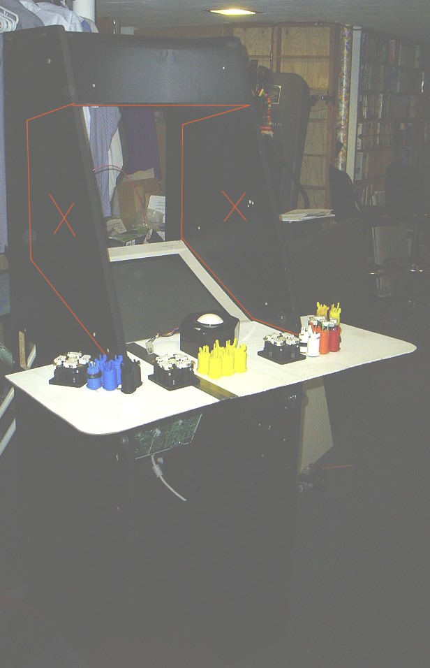

This started out as an idea of what to do with a pile of extra parts I had lying around. The cabinet was scavenged from an audio equipment setup I wasn't using anymore and the plan was to try and build something on the cheep. So far I've actually spent very little ca$h on it. Couple hundred, for the controls, computer and the 2 GP-wiz's, that's it.
Here is an early picture of the cabnet, I was using this to get some ideas on how I wanted to cut the sides and layout the placement for the control panel parts, etc...
Some of you may remember that picture as I used it in this thread...
http://forum.arcadecontrols.com/index.php?topic=60251.0
asking for some info on a 4 player setup a few months ago. It was as a result of this discussion that I targeted the Simpson's/Turtles cabinets as my basic shape/layout. However as I am working with a used cabnet, I had to adjust for the smaller size and different dimensions, etc...
I knew from what little experience I have gained thusfar in this hobby that having 4 players slamming away at an over hanging CP was going to make for some stability issues. That is why I decided to lower the placement of the monitor, and thus, lower the center of gravity. Just to make it a bit less 'tipsy'.
The main issue then became how to flush mount the bezel and protect the screen Here is a detail shot of the monitor area before cutting:
There was some discussion in this thread:
http://forum.arcadecontrols.com/index.php?topic=60389.0
where I was interested in a flush mounted Plexiglas panel held in place on the sides by t-molding.  I believe it was at this time I acquired the name for this monstrosity, courtesy of Shardian.
So at this point, I knew I wanted to do something like this:
and I set about making some cuts. Both to the cabnet and to some plexi.
I now understand what the woodworking guys meant by the 'snowstorm' in their houses when putting a router to plexi. It's amazing! Plus the stuff it statically charged so you just can't sweep it up, it clings to everything!
Anyway, here is a picture of it's current status:
the piece of plexi in the photo is just a practice piece and it is held in with tape for the photo. I have cut the propper piece but plan to leave the protective covering on it until I'm ready to mount it for good. I am also working on some metal retainers that will screw into the lower edge and keep the plexi panel in place.
I just got in the t-molding & spiner (Thanks RetroActive!) and I hope to have an updated picture very soon.
Also, have to get working on the control panel and I know I will have some questions about that.
Has anyone here made a 4P setup with 2 trackballs yet?

As I mentioned in my other project thread, nothing eats up spare time like starting another cabinet project.
Not too much progress with this one but I have started to fit the control panel into the overall scheme of things. Still trying things and testing for stability. So far I am liking the looks of this setup...
I'm using a couple hardwood boards (anchored inside to the backside of the cabinet) to support the outer 'ledge' of the CP. This really makes for a strong support and helps to use the overall weight of this beast to stabilize itself.
Of course the trade off is, it's butt ugly to look at!
I'll need to find a way to dress this up a bit, currently thinking of a panel across the front side of the supports and wrapping around the sides. Blend it into the current panels and it should look OK. I still have to allow for the lower part of the control panel, the one that encloses the wires and parts and stuff.
Something else I'm messing around with is the trackball mounting. Actually I stole this idea from somenone else's panel.
By removing the top of the trackball housing and mounting it directly to the wood panel I free up a lot of space underneath and get a slight 'hi-ball' effect. (This really depends on the thickness of the wood panel)
Also, there are no big ass trackball plate hoggin up the real estate, and subsequently, no big holes to cut!
This is a shot of my test piece and it looks like it'll work.
Just not too sure how much hammering they'll take. I know how a drunken Golden Tee sessions can get out of control!  I was thinking of putting a plate under the lower part of the TB housing and mounting that to the underside of the panel, just for strength but not sure if I'd need all that.
Remember, I'm doing 2 trackballs so there is the issue of the dual holes weakening the panel a bit. . .
Does anyone have any advice on using this method to mount trackballs?
« Last Edit: January 29, 2007, 12:57:32 pm by CykoMF »

« Reply #8 on: July 06, 2007, 04:10:58 pm »
Not much happening on this one.
I did manage to get the control panel secured.
It was a major pain with them C-clamps sticking out all over the place!
Catching you in the junk when you try to skoot around the thing.
It was a trip trying to figure out how to support all that weight, let me tell you! And to keep it balanced with the weight of the monitor.
Think I have it figured out though. Them angular boards (light colored ones) are fastened to the lower rear part of the cabinet. I robbed them from an old futon frame. They are very hard wood and do not flex much at all. I cut 45 degree angles on the ends so they mount flush at each end. Then drilled through em and put screws in. I may glue them someday but not till I button it up for good.
I had to cut away at the front edges of the cabinet and then make some metal brackets to support the weight of the panel. I made sure to leave a slight gap so it wont touch the plexi-glass. Everything is leveled up nicely too. I should have just enough room to mount the two 3" trackballs.
Also, I have a deal in the works to get the joystick bats I need to make each player a different color. Going to have to redesign the controls layout to accommodate the space taken by the angular support boards mounting location. This could be interesting.
Did I mention that I have just started a 3rd project?

About your trackball install.  You definitely need some more support for that.  If you are holding it in with screws in the wood, you need more support.  You could drill straight threw the wood, stick in some t-nuts, and bolt in the panel.  Not worry about popping out then.  Just cover the nuts with some wood putty and you are good to go.

« Reply #10 on: July 09, 2007, 08:56:24 am »
Hi Green Giant,
Thanks for the reply!
I was still wondering about the mounting of these trackballs. The T-Nuts idea intrigues me quite a bit.
I was going to fashion one big metal plate to support both TB's from underneath by anchoring to the underside of the panel. I think your idea could be a lot less work.  Care to elaborate on it a bit more?
I wish I could remember who's cabinet/project it was that I saw this mounting scheme used on. I suddenly have lots of questions  for them.  :dizzy:

Its pretty simple with the t-nuts.
1.  Wherever you had them screwed into, just drill a whole straight through.
2.  Go pick up some t-nuts at homedepot.  Then use a router to countersink a small whole the size of the t-nut so it will sit level with the rest of the cpanel.  Hammer in the tnuts, and you are ready to install the trackball.
3.  Just get the right size bolts, use a few washers if need be to make it the correct length, and bolt in the trackballs.  Now you only have to worry about someone hitting the trackball so hard that they smash the wood.
Used the same method to attach my joysticks to my panel.  It is probably the easiest and cheapest method to attach anything that takes some abuse to a panel.  You have probably seen this on a bunch of panels.  Most people use Happ trackballs and the happ mounting plate, but it is the same theory as using a tnut.  Anyone that wants to hide their install under a nice overlay uses tnuts to mount the joystick.

T nuts are definitely awesome.  This way you'll only need one hand to remove the bolt, and not one underneath.

Hi Green Giant,
It might have been me (I stole the idea from someone else).
I mounted some carriage bolts from the top of the CP. I countersunk them so they would be flush and allow for a smooth CP overlay. Since I used 3/4 MDF for my CP top, I figured there would be enough material to safely hold everything in place.
I haven't had a chance to use the TB yet (wiring issue... gotta get a new harness), but it seems real sturdy.

« Reply #16 on: July 12, 2007, 08:17:31 am »
Hi Hng,
You could be right, or maybe we both got it from the same other guy, dunno.
I like that spacer thing you have going on there between the lower surface of the CP and the top of the TB shell. Will definitely be stealing that from you too.
Did you have any 'issues' with the optical boards moving around at all?
I was going to cut a small groove for them just to ensure they did not move, but didn't know if it was really necessary.

Here are a couple pics of this one's progerss.
Here is the control panel with components installed.
(CP purists make your belittling comments now)
The mirror finish has already got a couple minor blemishes. The clear top piece is excellent at trapping dust between the two layers. I will seal them up when I stick everything together.  The edge is sanded down pretty smooth and is very comfortable. The corners near the trackballs may be prone to lifting if someone hits them just right, it's really not a matter of if, it's a matter of when.
Man, look at that dust already, almost a preminition of whats to come. ha ha.
Angle of he picture kind of exaggerates the setback of the layers, they are actually almost flush. The latout is about as comfortable as one could manage from the space allowed to work with.
« Last Edit: February 18, 2008, 06:33:29 pm by _) (V) (-) »

I still need to get the CPU going and find a couple USB ball mice to hack up.
Hoping to have the thing playable by the holidays.

Not as much progress as I'd liked on this one this winter. Been busy shoveling.
I'll attach a pic of the 4 foot snow drift that 'splains why.
That is my 21 year old son holding my 2 year old niece, standing in the middle of it. The dark post thing on the right side in the foreground is the frame for a yard swing. The top rail is over 6' off the ground. The 'subjects' of the photo are actually standing about 20-30 feet beyond that swing. My son is 6' 3" and to give you some idea of the scale there.
Nevertheless, I did manage to get a PC running and wire up the controls. Both mouse hacks are in and working. Big thanks to Fixumdude for the optic boards, perfect solution man!
Also cut the recessed holes for the credit buttons, I think they turned out pretty cool. Luminated but not distracting and the flush mount prevents accidental triggering. The reflections on the mirrored cp really aren't as distrating as you'd think looking at that photo.
Going to tie up the wiring and close up the panel. Then start working on marquee & speakers. Haven't really settled on a design yet, at this point it's a blank slate. I think it's time to do some playability testing and I'll decide on a theme based on it's personality.
At least till that  :censored: outside melts.
Yeah...   that's the ticket.
« Last Edit: February 18, 2008, 07:02:21 pm by _) (V) (-) »

Winter crawls along and so does my progress.
Big ups to emdkay for the bargin marquee art!
I made it fit without ruining it.

« Reply #28 on: September 14, 2010, 09:48:03 pm »
It's not dead, it just smells funny.  :lol
I've made a little progress on this one but have had a ga-zillion other things in the way.
Good news is it survived the floods we'd had here this past summer.
Got dust blown off and the speaker panel & grills mounted up.
Will try to get a new picture posted soon.

Here is the updated picture.
Seems my progress seriously stalls once it becomes playable and needs 'testing'
I've been painting and mounting some of the front panels. Still working on the open part under the CP.
Looking for a way to stash a keyboard and USB port there so I won't have to open the back panels, once I get them mounted.
Notice the nice gouge on the front right part of the CP? From a collision with one of the jukes. That'll have to be repaired.
The credit buttons aren't lighting up either for some reason. Probably the powersupply wires coming loose from all the moving around. Hope to get back into this over the winter. Tidy up the wiring, mount the speakers and start closing up the back panels.
Also plan to put in a recessed panel with power switch and volume control on the left side. Might put the USB port there as well to make transferring files easier. Hope it's not another year before I can update this thread again.

« Reply #30 on: October 10, 2018, 05:59:51 pm »
Haven't done much to finish this one. Funny how once they become playable progress grinds to a halt.
I did replace the CRT with a LCD flat panel, sure made a difference in the overall weight.
Cleaned out the PC, had the credit button lights working again. They have been a continual source of trouble actually.
Suspect it's the heat. Been thinking of putting in LED bulbs to cure that.
