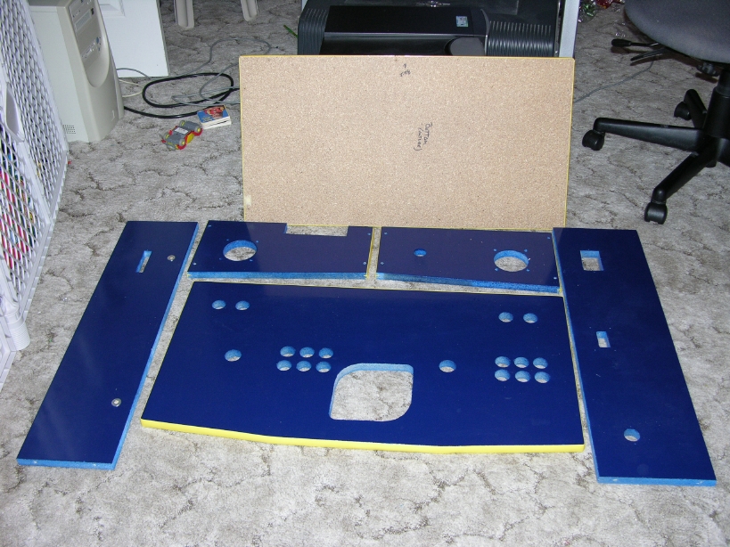

The kit arrived very well packed in a large box, and looked like this when unpacked:
Plastic wrapped wood pieces and box o' parts.
And unwrapped -- everything was well protected, no dings or scrapes. This shows the inside faces.
Outside faces. Ed chose the colors :)

All in all I was favorably impressed by the AIAB kit. Solid components, well done instructions, lots of attention to detail. I imagine it would take someone unfettered by distractions about 3 to 4 hours to put the whole thing together. I enjoyed putting it together, was at about a "0.0" on the cursing scale while constructing, and did not have to invest too much time in assembly. Everything seems well thought out and quality was good.
There are a few things I would like to see addressed. Longer USB cables and the addition of an S-Video jack on the audio-video panel (which can be easily picked up online if you want to do so yourself) address physical concerns. I would have liked to have seen installation photos in the instructions to match the excellent documenting and labelling. This could be sent via a PDF or with pictures online for those who operate better visually than with written instructions. I'd also like to see additional flexibility in choosing layout and design of your controls (for instance, pinball flipper buttons), however adding your own is easy enough and there's plenty of room.
My rule of thumb when considering something like this, particularly in light of the "build your own" spirit a lot of our visitors have, is whether or not it would have been easier or cheaper to do it yourself instead of buying. For most people I would say that this kit clearly passes this test. When you factor in the time, effort and money not spent in materials, woodworking and design, this is one hell of a kit! Prices start at $250 and up depending on options chosen. If you're looking for an all-in-one box I wouldn't hesitate to recommend picking one up. Mine is going in our guestroom in our new basement! :)
