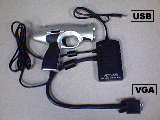

There has been some talk before about the size of the hole needed to install an Act-Labs lightgun into a cabinet, due to the fact that the gun cable is hardwired to the control box, as seen below:
In order to reduce the size of the hole, and to make the gun removable in case I needed to move the cabinet, I modified my gun to have a connector for the gun cable.
In case anyone else is interested in doing the same thing, here's what I discovered:
- The gun cable is an 8-conductor shielded cable.  Thus, I crimped an RJ-45 (network) connector on the gun side, and an RJ-45 keystone jack on the control box side.  This jack is mounted through the overhang beneath the control panel.
- Although the gun is now removable, it still needs to be plugged in for normal operation, as when the gun is not plugged in, the control box goes into calibration mode and the screen whites out.
When the gun is plugged in, it works completely normally.  Note that this will almost certainly void the gun's warranty!

Sounds great Chris.....did you do anything or to secure the cable to prevent an overexcited player from ripping the cord+plug out of the network jack?  I'd think you would want something to prevent damage like this....
I put a strain relief on the connector; in addition, I mounted the keystone in such a way that its mount flexes when the cord is pulled.... it wasn't intentional, but it does absorb a lot of shock.  It could still no doubt be damaged by an overexcited player... of course, you have the same problem without the modification.
A real game would have a heavy rubber or steel hose; Happs has them, but they're meant to connect to their gun shells.
--Chris

I hope act labs adds a quick disconnect in their final product. It's going to be a problem for everyone who installs this in a cabinet.

Yes... it'd be nice if they'd fix the calibration switch to be normally open instead of normally closed, too, so a disconnected gun doesn't turn the screen white.  I'm still trying to decide if I should build some sort of inverter to reerse this behavior, or a dongle to put in place of the gun in case I need to run with the gun disconnected, or just live with always needing the gun plugged in.
