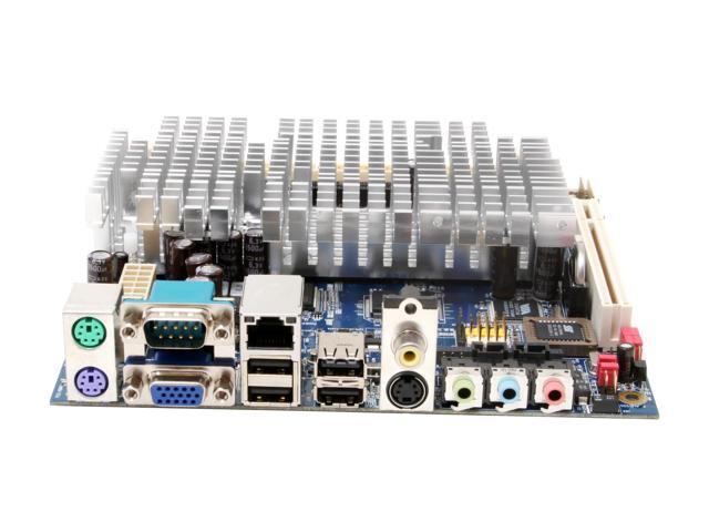

[li]If I want to have the PC go with this thing anywhere, I'm gonna have to build a box underneath to hold everything, kinda like an udder, and drill a hole in the CP base. No other way to do it.
You're saying you can't put a motherboard in that box ? even those tiny-factor ones ?
These boards are so small, they just ought to fit in.
Looking great BTW.
Micro-ATX board will only fit sideways due to having to keep the keyboard/mouse connectors facing inwards which then creates problems with the video card, the proc/heatsink/fan, or memory slots blocking a button or joystick hole.  That's what I meant when I said I shoulda bit the bullet and spent another $100 on an ITX board.  :-\
That CP is, side-to-side, as wide as an aircraft carrier, but it's only about 9 inches from front to back at its widest point (7.5 interior).  I'm leaning towards going with the "udder", because I originally wanted to build a showcase cab, but I realized I was getting away from that and would most likely not finish the pedestal unless somehow forced to do so.
Also, I like the setup as it is, but I may cut another CP top and throw a trackball on there.  I really wanted a trackball, but it just doesn't look like I'll be able to fit it on there without cramming it in there uncomfortably.
Odd isn't it?  A CP that's 5+ feet wide, yet too small to house a PC inside it!  :P

What is the height of the inside ?
Why do you need a vga card ? There's agp onboard, no ?
Did you actually try to place such a board inside ?
DrewKaree
  • Posts: 9740
  • HAH! Nice one!
    • A lifelong project
Re: So I built a sawboard - now this Party Box? Americade? Bubble-something?
« Reply #122 on: January 13, 2006, 06:38:01 am »
2.5 inches.  I need an AGP card because I need S-video, one more reason I didn't pick up an ITX board.  Onboard S-vid hasn't gotten real good reviews around here either, and the fact that I haven't seen an ITX board with onboard S-vid just sealed the whole deal with that.
I just got all the stuff in today and (didn't set it up, just testing clearances) plugged all cards and chips in, and laid the proc/hs/fan on top of the socket.  Buttons hang too low to clear some stuff, and a few caps are in the way of a joy.  I picked one of the smaller boards I could get, the problem is that the smaller dimension is the width (I need the length) and it's not small enough to plug cables in without SERIOUS kinks if they'll work at all.
It's no big deal to hang the box underneath because like I said, I wanted to do a showcase to begin with, and this will make me want to actually work on the pedestal.  My plan with the showcase was to house the PC inside the pedestal and have the cables snake into the CP anyway, so this completes that step for me.
The black pipe will be easily removes, yet allow me to take it around until I complete another CP.  It'll also allow me to see if I need to go 4-player for the next one as well.  My kids, their friends, and my buddies will DEFINITELY utilize the 4-player panel, but if taking it to parties doesn't show a need for a 4-player panel, I'll simply build a smaller one.
This isn't my first setup, but everything else I built was a "cab" cab, so I never had to worry about these issues.  This won't be my last project either, so swapping out parts as PC parts evolve isn't a big deal.
An "udder" is probably bringing up some horrible mental images for folks, but I'm not worried.  It's not gonna be some gigantic monstrosity, just tall enough and wide enough to house my PC.  Picture gutting your PC and laying all the parts out on the table, and then plugging everything back in so that it works.  That's all this'll be.
It's not like I'm putting a flat front on a machine that begs for a curved front ;)
Oh, and the CP is getting scrapped to fit a trackball.  Case closed on that one.

2.5 inches.
Point taken.
Of course once there's a VGA card addon, it's out of the question
But it begs for 3 more inches, no ?
Seriously, what if you cut a square hole at the cp bottom (say, the size of an ITX board),
and attach an opentop box under it, so you can put that ITX board inside.
You then have a combined height for the motherboard (bottom box + cp inside), and maybe
the "underbox" would not protrude as much.
Just an idea...

I was already gonna rout out a recess for the micro-ATX board before finding out it'll suck.  I've got half an inch I can remove from the CP bottom, so there isn't much more I can take out.  The entire thickness of the sides is only 3.5 inches.  The only reason I'm not digging the larger opening in the CP bottom is that if I make the PC box/case/udder, it'll be just to house the PC parts, and will be removed when the pedestal is completed anyway, at which time all the cables will be fed through that same nice small hole to connect to the PC that'll be installed in the pedestal.
With 2.5", any controls can be mounted while maintaining a small footprint, height-wise.  It STILL seems a tad tall to me, so to my eye, 5 inches would look like a small tug-boat ;D

(another idea)  :angel:
what if you put the whole pc in a second box, fitted exactly for it, and
just make a connection between the two (like a docking station)
It will still stay portable.

So you're saying something like (and EXCELLENT idea ;) ) I could make rails underneath the CP and have the PC box slide into the rails, making the CP mobile AND stationary ("docked" to the pedestal when built)!  Something like a sliding dovetail or a simple drawer slide contraption.

I have actually just recently come to a decision after having this thing starting me in the face every day and it's now come down to money, as in "I need some".
I'm ditching the old (still new though) system I was going to put in here and instead I'm going with a mini-ITX mobo and a 1U power supply.  Here's links to the 3 mobos I'm deciding on and a pic of what one of these things look like
http://www.newegg.com/Product/Product.asp?Item=N82E16813181021
http://www.newegg.com/Product/Product.asp?Item=N82E16813181020
http://www.newegg.com/Product/Product.asp?Item=N82E16813181019
In case you're unfamiliar with these things, they're a mobo with an embedded processor.  They've got less processing power, but for this application, it's got more than enough power - although I'd like to find out if anyone knows just HOW much power it's got and what version of MAME I'd be best using with it.  I know this will run v0.55 no problems, but I have no idea HOW much higher I can go with MAME.
The other thing these boards have going for them is power consumption and size.  The power supply I've got picked out is a simple 300W one for a 1U rackmount, seen here: www.pcpower.com linky - click me!
The mobo solves two problems in one.  The 1U power supply is only 2 inches tall, and a 300W psu is WAY more than I need to power the mobo.  As for the size of the mobo, it's under 7" square, so I'll be able to place it just about anywhere I want.
Lastly, I need a stick of RAM for the thing, since I don't have one - but that's it. I've already got the hard drive for this thing just sitting there waiting.  Problem is, I'm looking at $400 for this new PC setup.  The wife has no problems with me spending that, but I know I don't have it right now.  We're supposed to get snow this weekend, so I'll have some cash if I have to go plow.
Using that mobo, for initial setup, I'll simply attach an IDE cable to an optical drive and install everything, and if I ever need to add/modify anything, I can simply use a USB key, so I don't have to worry about that.

Good luck with that mobo - I love the idea. I've used several different machines for MAME and noticed that different video cards do different things (especially outputting to a television). Ultimately, I had to use a pci video card instead of the onboard intels.

I had taken a look at that while looking at the newer ITX boards, and while I'm a huge AMD fan, the size of the ITX mobo's are really the deciding factor on this, not to mention the probable cost difference of such a new item.  I very well may switch this out later on though, once prices come down.  I've got something in mind that I simply can't do with any mobo larger than the ITX board, so if I could scavenge it at a later time, that'd be good too.
I'm not certain on the quality the board will put out via S-vid, but given the situation and reviews on at least one of the boards I've seen above, it's a pretty decent picture when used as a DVR, so I'm thinking I should be ok there.
