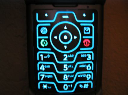

this just inspired me. If you made the main body of the control panel out of lexan, you could lay a thin metal plate over it and cut out patterns in the metal. Then you could put a neon light underneath it makin the control panel itself glow!
EDIT: something like the motorola RAZR keypad (shown below)
« Last Edit: June 02, 2005, 04:18:37 pm by nobody »
Cool idea.
