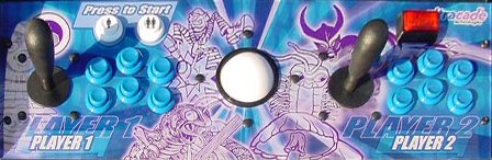

I have seen the CP on the Dream Arcade Cabinet (usually called Arcade Legends) made by DreamAuthentics.com. They even managed to squeeze in a trackball (2" though) in there. I took the perspective out of one of the CP pictures (the overlay is straightened out so the sticks will seem a bit weird):
This panel is about 24.5" wide
