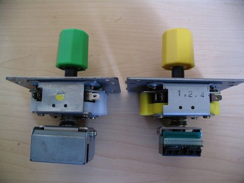

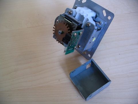

Very old noob here. Is this going from a typical spinner to like an heavy Barrel type rotating joystick ?
  • Posts: 9742
  • Last login:Today at 01:20:49 am
Re: Using inc rotary encoder as a spinner - need help understanding counts
« Reply #11 on: March 07, 2025, 12:03:33 am »
No, it's WAY too high resolution for an optical rotary joystick.  There were 5 games (Fighting Soccer, Caliber .50, Exterminator, Touchdown Fever, and Touchdown Fever II) that used an optical rotary joystick like the green-handled Loop-24 stick that is basicly an 8-way stick combined with a 24 pulses per rotation spinner.
Heavy Barrel, Ikari Warriors, and similar games used a "clicky" mechanical rotary joystick like a yellow-handled LS-30 with a 12 position rotary switch.
